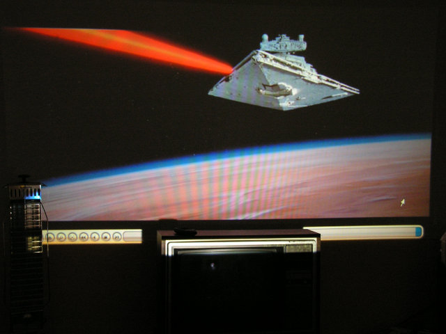

awesome. If without the color banding.
dude, you got to post your setup please along with the picture.
are you using an enclosure? or just an OHP?
what lcd?
good freaking job man.

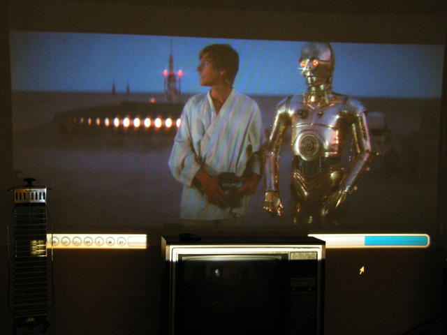

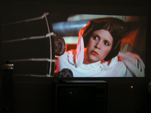

what lcd?
Hehehe, I am quite pleased with teh picture birghtness and quality. It will be better whne I have a top made for the projector! All images are 95" diagonal. I am using a 5qt mixing bowl and a 400watt metal halide grow light made by sylvania ($8) and the classic benq fp556? 15" lcd, and DIYPC long throw kit. The edges are admittedly a bit dimmer and slightly out of focus, only really seen while doing something other than wathcing a movie.
The pictures are take from about 11-12ft back. Let me know what you think please, and any ideas for getting the edges cleaner would be awesome.
I had to compress c3po and luke a bit more than the other ones..sorry 😉
My lcd is in so the image is normally backward as well, I found that helped make the picture MUCH better. I can't show you a pic of my projector, I am embarassed lol, this is still the prototype with screws all over the place, tape and tinfoil covering holes lmao. I have used only the lcd controls to adjust the image, and leave it set in this one config (I used avia to tune the projecotr's contrast and brightness level). Also just using the free zoom player to reverse the image so the movie isn't backward 🙂 Engages the left brain when mousing or trying to read on it though!
but we still don't know if you're using an enclosure or an over head projector.
justo wondering. i would guess it's an enclosure cause a grow light uses a huge bulb that i don't think can fit in an ohp modded.
am i right?
am i right?
You are right this is a HUGE mdf box lol. I hav ea mirror int he mail so I can make something of a MK III type enclosure and shorten this up a few inches.

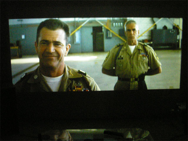

I just wanted to post my results using a Proxima 944 and a Da-lite 5000 lumen overhead projector and a TV/Video to VGA converter. Screen is triple pass blackout cloth 70" diagonal. It's not the quality of the PJ's you guys are working on but, I'm pleased with the results. I'm not the best picture taker and the room is actually not as dark as the pictures show. Some of the shots I took showing the light coming out of my kitchen on the left

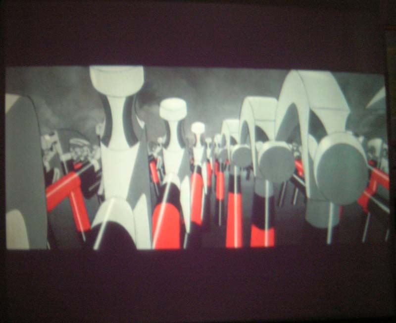

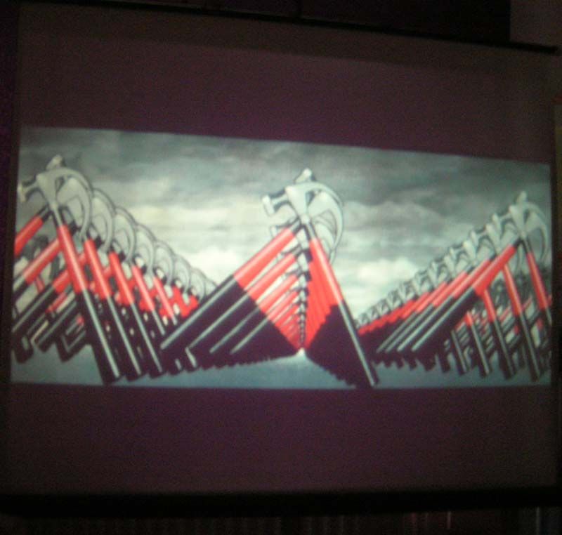

Hi, I have been a member of this forum for quite a while, and have been experimenting for years with DIY projection.
Tried the 14 in TV / lens idea, not too good. 🙂
Now i use a 15inch NEC 1510 LCD, and a no name OHP, it just has the name of a local office supplies store where it was bought from originally, it has a 12in square fresnel, minus corners, which is nearly perfect for 15in LCD, which i split, for a greatly improved picture.
My screen is an old slide projector screen from local council tip, which only gives me a max picture size of 6ft diagonal at 4/3 screen dimensions.
here are some stills from The Wall, Pink Floyd, routed through my PC's SVID socket, 15 meters cable, into a VGA box, (which cost £40.00, which is why it cost over £100.00!) for conversion back to VGA and into the LCD to be converted into digital for the display. 🙂 so my image is degraded because of all the changes the signal goes through, but as my PC is upstairs, and the pj is downstairs....
Pics have only been cropped, brightness/contrast have been left as photographed, pics taken at 5 mp, and then scaled down for size limitations of photo host.
