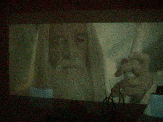

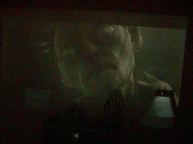

There is a little screen door effect. My camera isn't very good. You can't see them in the pictures. It's not bad at all though. It's deffinetly a watchable screen. It's great. And in my post I accidently said it was 90" inches. It's not. SORRY. My bad. I really need to preview these posts before posting them. It's 50". I type way faster than I should. Make alot of mistakes. Sorry again guys.

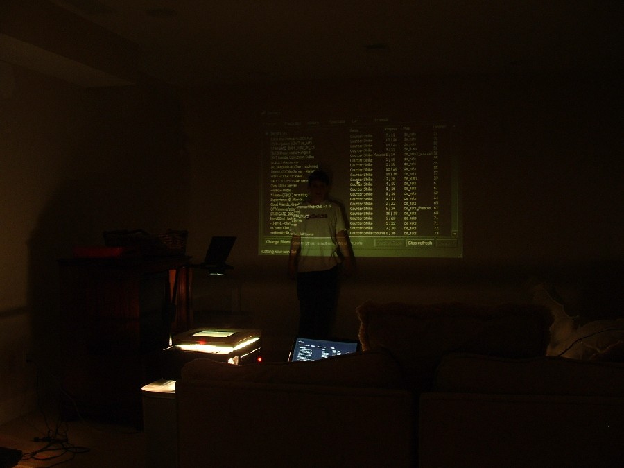

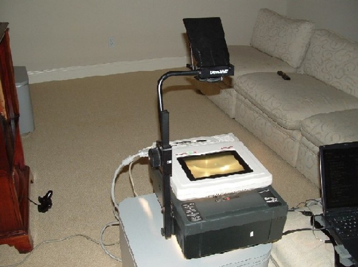

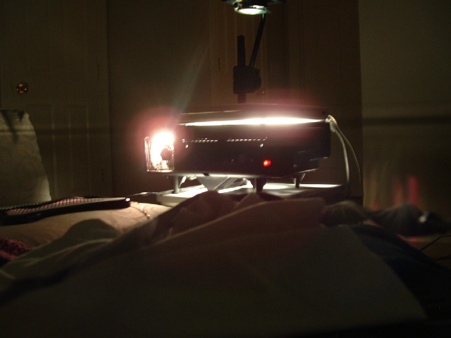

my results! (dukane 4500 + Apollo Vision Q2)
After more than a month of researching the right panel, ohp, and screen I finally have some results! My OHP is a Dukane 4500 (4000 lumens) and an Apollo Vision Q2 projection panel, 16.7 mil colors, 640x480 res, response time??. I am very pleased overall, seeming that I haven't made my screen yet (i've decided on polywall) and I have not had a chance to even start to think about building an enclosure, although I'm sure I'll build one. I think the screen's diagonal is about 6 feet, but i haven't measured (thats me in the picture). The image is nice and crisp, and I've tried playing Counter Strike but the contrast isn't quite right, making it extremely hard to see in the darker parts of the game. I haven't tinkered with the settings on the panel yet, but would changing the contrast/brightness on my laptop have any effect? Also, as you can see in the pictures in the following posts, I have lots of light leakage from the OHP which will be fixed as soon as the enclosure is constructed. Overall, I've spent about $210 on the OHP, Panel, and correct cables not including the screen material which is yet to be purchased. The cost has actually been even less for me because my dad split the cost of the parts with me, because I am only 14! I found/bought all the components on ebay and have a feedback rating of over 50 100% positive. More pictures to follow once enclosure is finished and screen is ready. Thanks again for every1 who responded to my questions and everyone who has posted such valuable information up on this site.

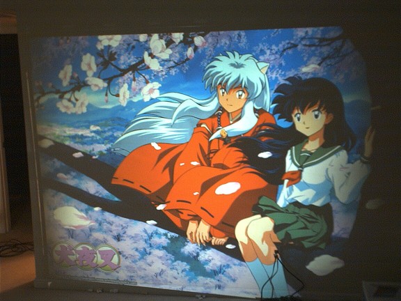

well this is my first try just got my componets today
what im usen
Proxima Ovation+ 944
3m 9700 (4300 lum)
a big white crapy wall with lots of imprefections
let me say first when we bought this house recently the people that did the basement where like 80 and they didnt even sand the walls after they mudded em they just like painted over the mud(plaster)
so theres lots of imperfections but its really hard to tell
rooms perty dark sorta theres a few windows this is a basement but theres enough ambient light to see well in the dark to eat and do stuff but the picture qual im shocked at
some of the pics are skewd cause i was sitting or standing at an angle
i was running only over rca (composite) from an xbox
i ran xbmc and a py script for my theater to stream satellite tv to the xbox from my other rooms computer running myTheatre
very nice satellite set up if i do say so mah self 🙂
hopefully soon i can spring for the c800 cable ( 80 bucks)
or make one i got the pdf of the wire and pin lay out from proxima in an email they are perty good with support i gotta say
ok heres the pics ( this is my first try and first day and no screen just wall so im happy with the outcome so far)

i got the panel for about 150 shipped i think i coulda probably gotten one cheaper but this is the one i ended up with im perty happy about the quality i got out of it im gonna play with it more and see if i can get higher res with a computer cable (c800) its a 13w3 to vga with a diff pin layout . that should let me get a true 1024x768 at least compressed (zoomed out) with this panel i can run 1024x768 over svideo when i set it up on my pc over svideo out on my video card but i can tell its not true like you get over a vga cable so we will see how it turns out once i get a new cable. been thinking about buying some more panels and parts i might tackel taken apart a cheaper lcd monitor soon . my uncle just bought a 3m 9800 thats suposed to put out 6000 lumens so ill see how much better lighting works . i was thinking about building a box with perty much all ohp parts usen old ohp's was thinking about usen 2 balasts and light sources from 2 units to get more light like myabee 2 cheap old 4000 lumen models together in 1 box might give me something near 8000 i hope i dont know yet ill test some stuff later but for now im really happy with my pic qual the pics i posted was the first day and no light blocking yesterday we had a big movie night and i set it up better moved furnature to make it better and we got around 110 inches diagonal and the picture looked great .
