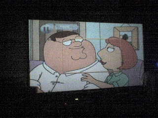

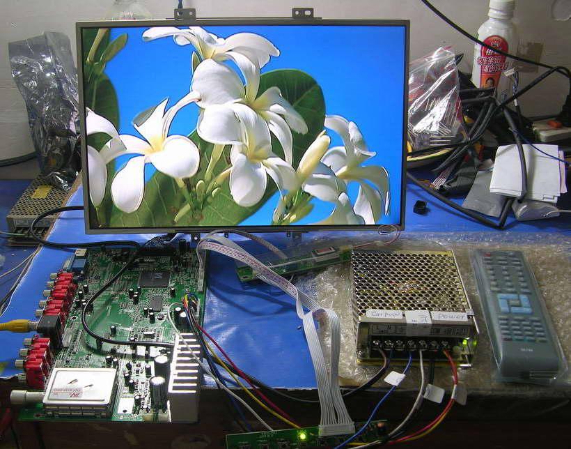

10.6 inch LCD (1280x768) and HDMI controller

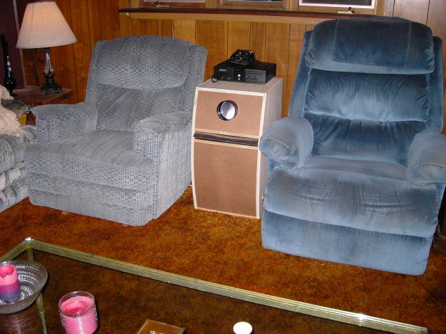

Triplet 320mm
Fresnals 220/320mm
lamp 150w/6k4, and philips ballast
Triplet 320mm
Fresnals 220/320mm

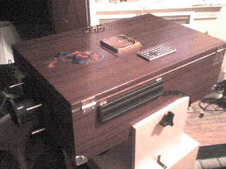

10.6 inch samsung lcd
lamp 150w 6k4
fresnel 200mm and 320mm
triplet 320mm (can be ADJ)

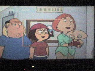

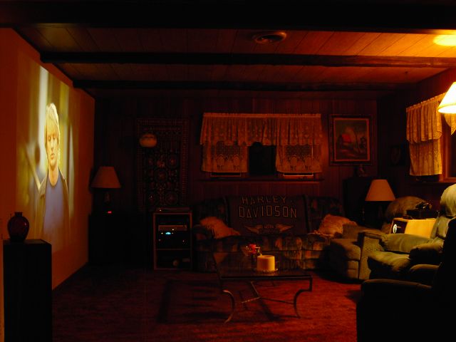

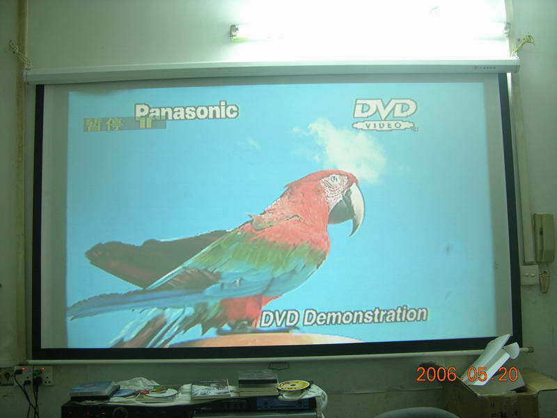

real pic.(see the daylight lamp)
lamp 150w 6k4
louthewiz said:The contrast looks dull on those screens
that is DVD signal,(480p, day Results )

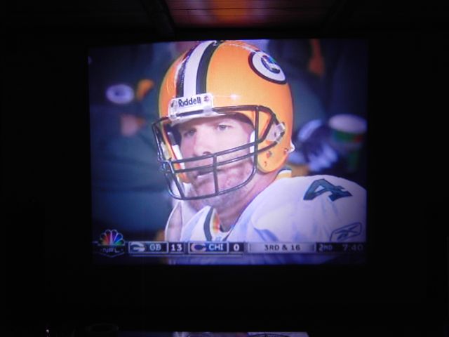

this Results is HDTV 1080p signas (night Results)
