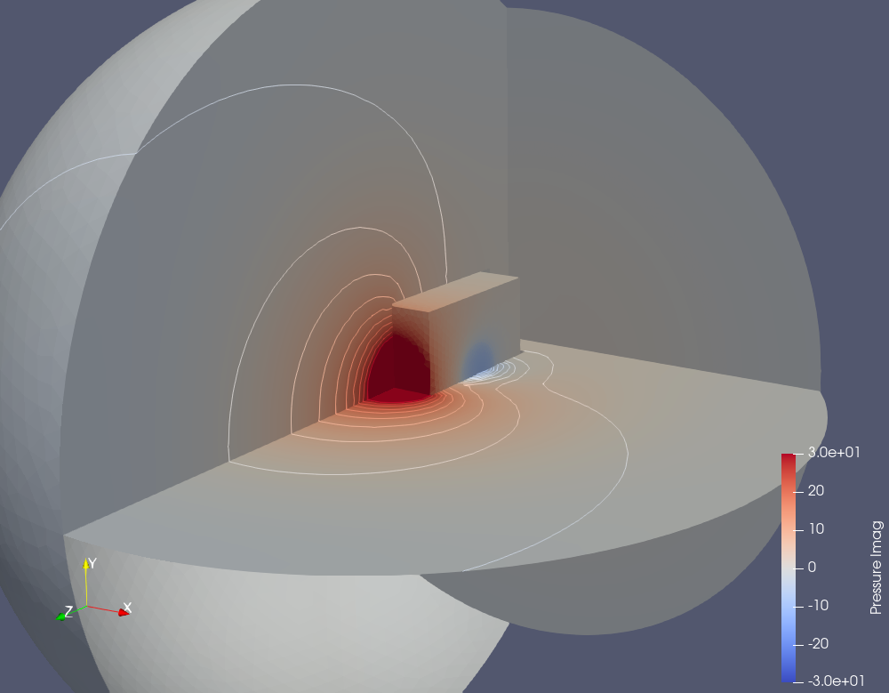

Linear acoustic BEM (akabak, acousto, bempp,...) can be useful in sorting driver configuration and perhaps some in-room issues. A better job can likely be done with an acoustic FEM code due to modal analysis and sound absorption through foam, furniture and the like. Structural FEM for cabinet vibration. Nonlinear rather than linear 0D/1D analysis for the drivers would enable us to include better distortion levels in the simulations and as more driver manufacturers publish Klippel data this is becoming viable. My hope is the project will include much of this.
I guess someone has to handle this part of the project if we are to develop a really optimized speaker in terms of above-mentioned aspects. I am personally a beginner to ABEC/AKABAK, so I would not be of much use in terms of speaker development using these tools.

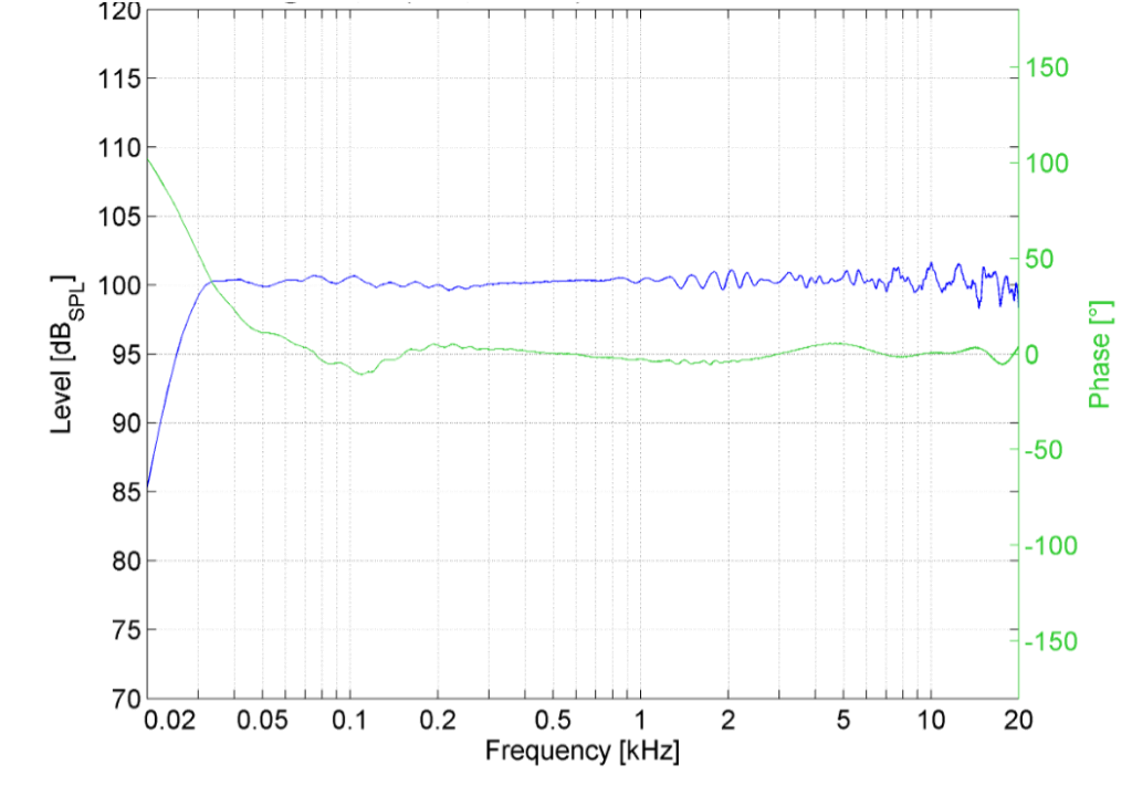

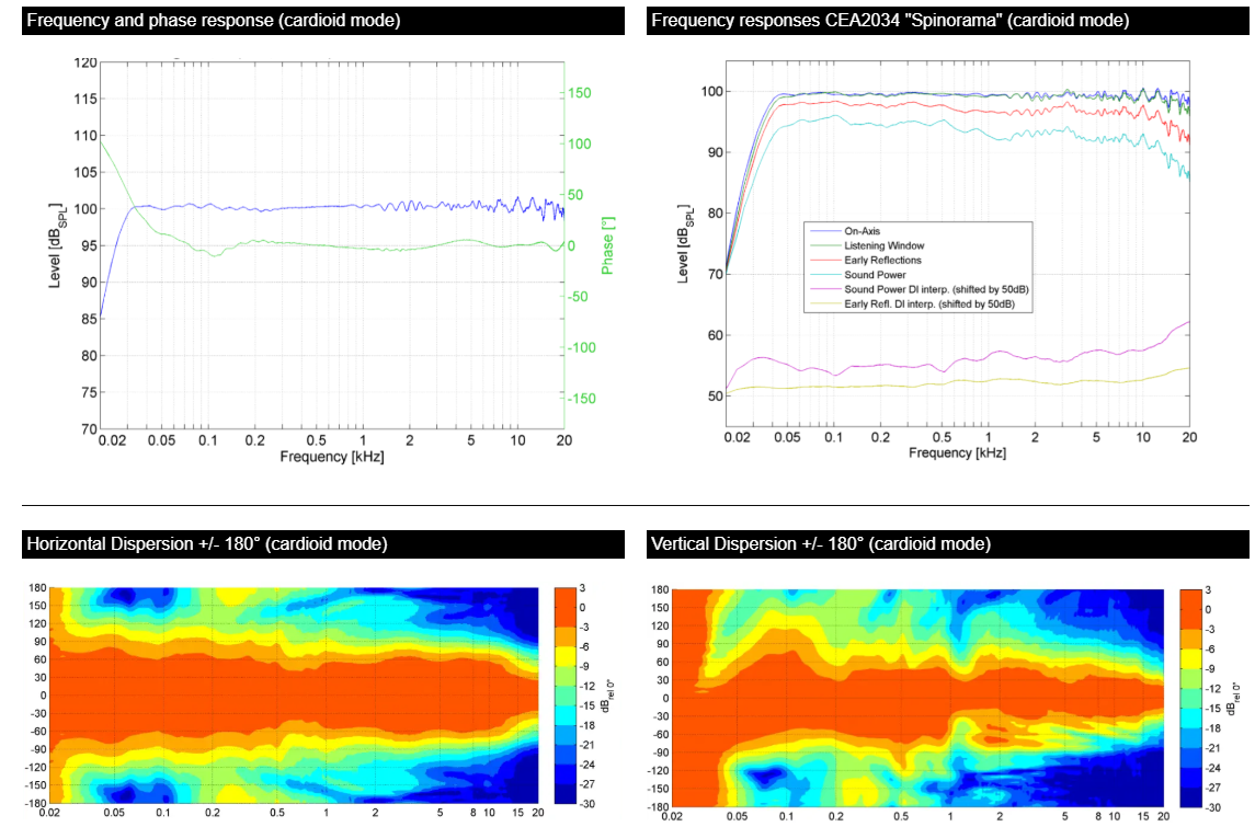

Just for inspiration, a couple of recent cardioid projects from ASR..
I find reading the posts of the developers of the speakers very useful, especially the attached project PDF document in one of the threads:
1) https://www.audiosciencereview.com/...ith-double-waveguide-and-cardioid-bass.51866/
Project document here: https://audiosciencereview.com/foru...aveguide-and-cardioid-bass.51866/post-1964728
2) https://www.audiosciencereview.com/...on-using-global-optimization-algorithm.61208/

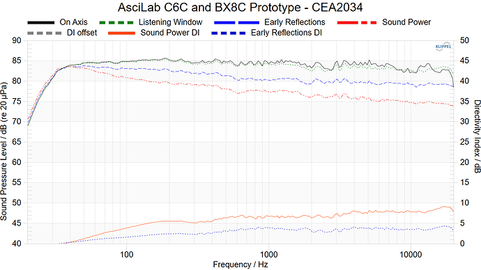

Two types of modular, floor-standing tower-style controlled directivity speakers
1) The slim version (From Ascilab)
2) The fat version (https://ggntkt.de/en/model-m3/technische-daten/)
the slim version and the fat version, both can be optimized to match relevant technical specs as shown above.
Ultimately, it is the tastes/preferences of the builder that matter which type he/she can tolerate for the use case.
