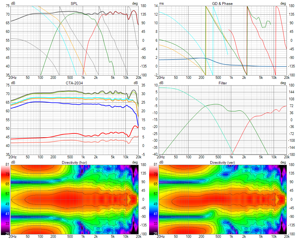

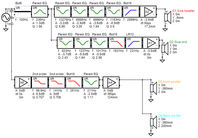

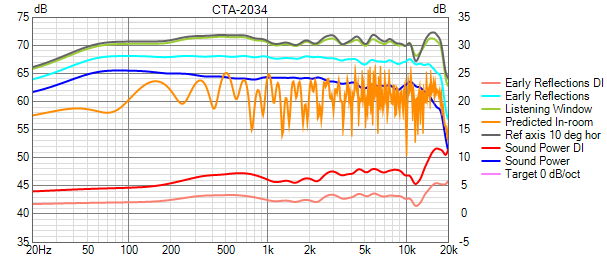

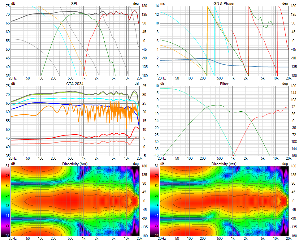

Out of curiosity, I modelled a dipole cardioid source (using the same ascilab-stylewoofer module + cardioid sica coax) and did some positioning experiments
Here is how the setup looks
Note that it is just the DSP settings that have changed compared to the earlier full range cardioid speaker.
This one seems to be much more tolerant of positioning if the front wall has moderate absorption and a relatively absorbing carpet on floor 🙂
Reactions: stv

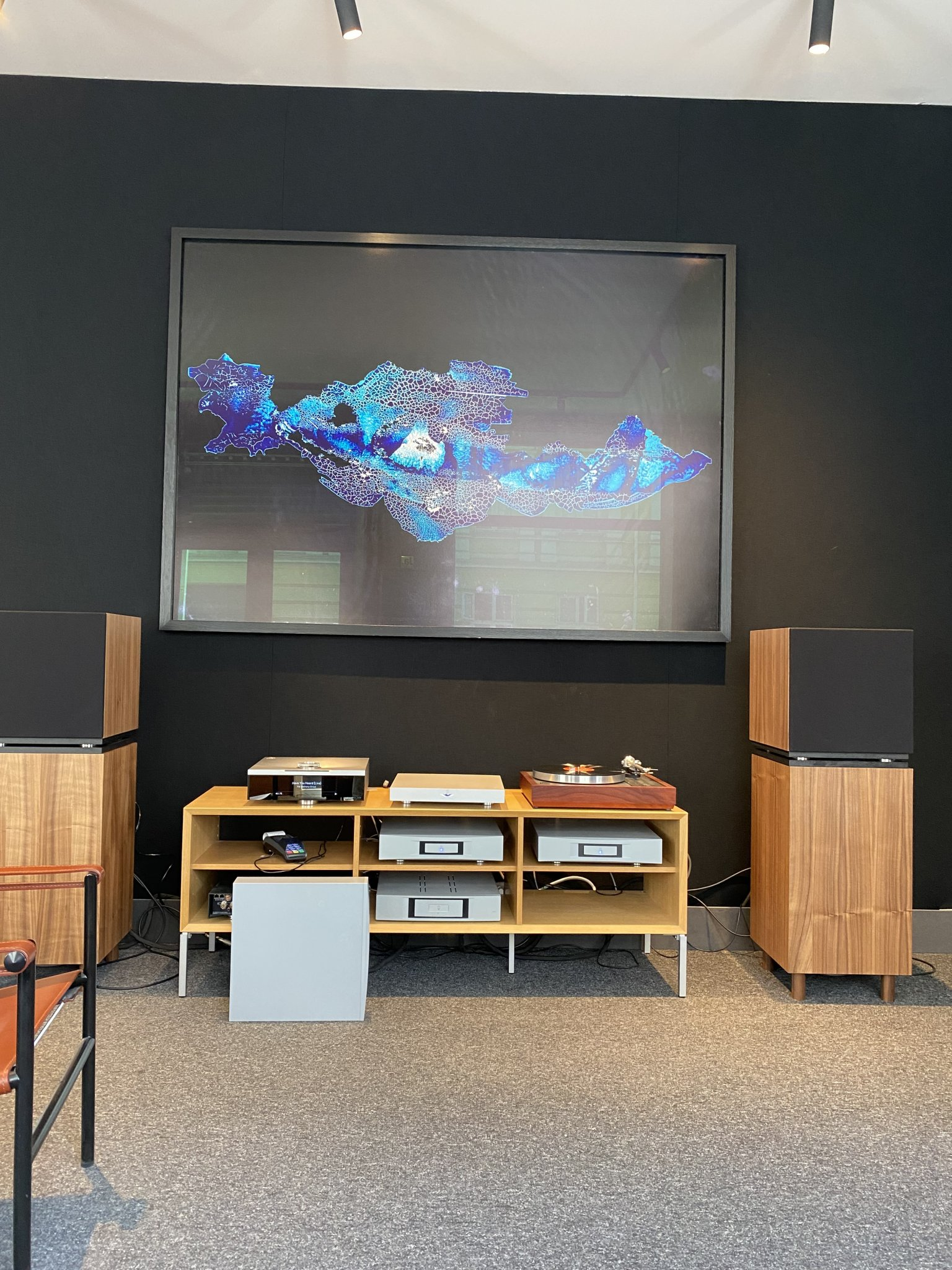

My post suggesting options for a spec a page or two back hasn't generated much discussion so I will pencil in a spec and ask for objections/support.
Floor standing to optimise the use of space. Separate woofer and mid/tweeter cabinets enabling different design approaches for each cabinet, passive isolation between them, supports a modular approach.
Designed to be positioned near or against the front wall. Given the use of an active crossover positioning out in the room should also work well though possibly not as well as it might had it been the only position.
Clean output at standard levels (80-85 dB average) at 3-4m with low frequency extension to 30-40 Hz. Will enable supporting a distributed sub system or working reasonably standalone without sub support.
The radiation pattern requires research but tentatively omnidirectional below 80-100 Hz with a narrowing beamwidth above. Lean towards clarity rather than spaciousness.
The build complexity to be pitched at inexperienced speaker DIYers that intend to continue with the hobby. A level above inexperienced one-off kit builders on the kitchen table but below experienced speaker DIYers with well equipped workshops.
To use good standard range drivers and components. Not budget ones and not premium/prestige ones. Budget for drivers £500-1000 increasing by £500 if an active cardioid woofer module.
External active crossover and amplifiers to support a modular approach.
Proposed initial modules subject to discussion:

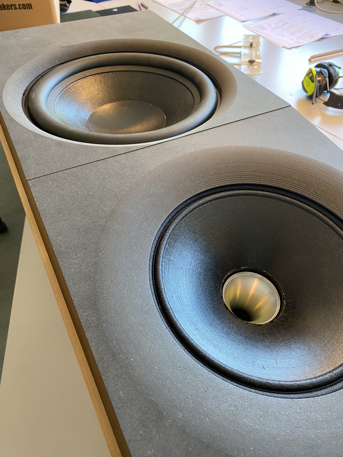

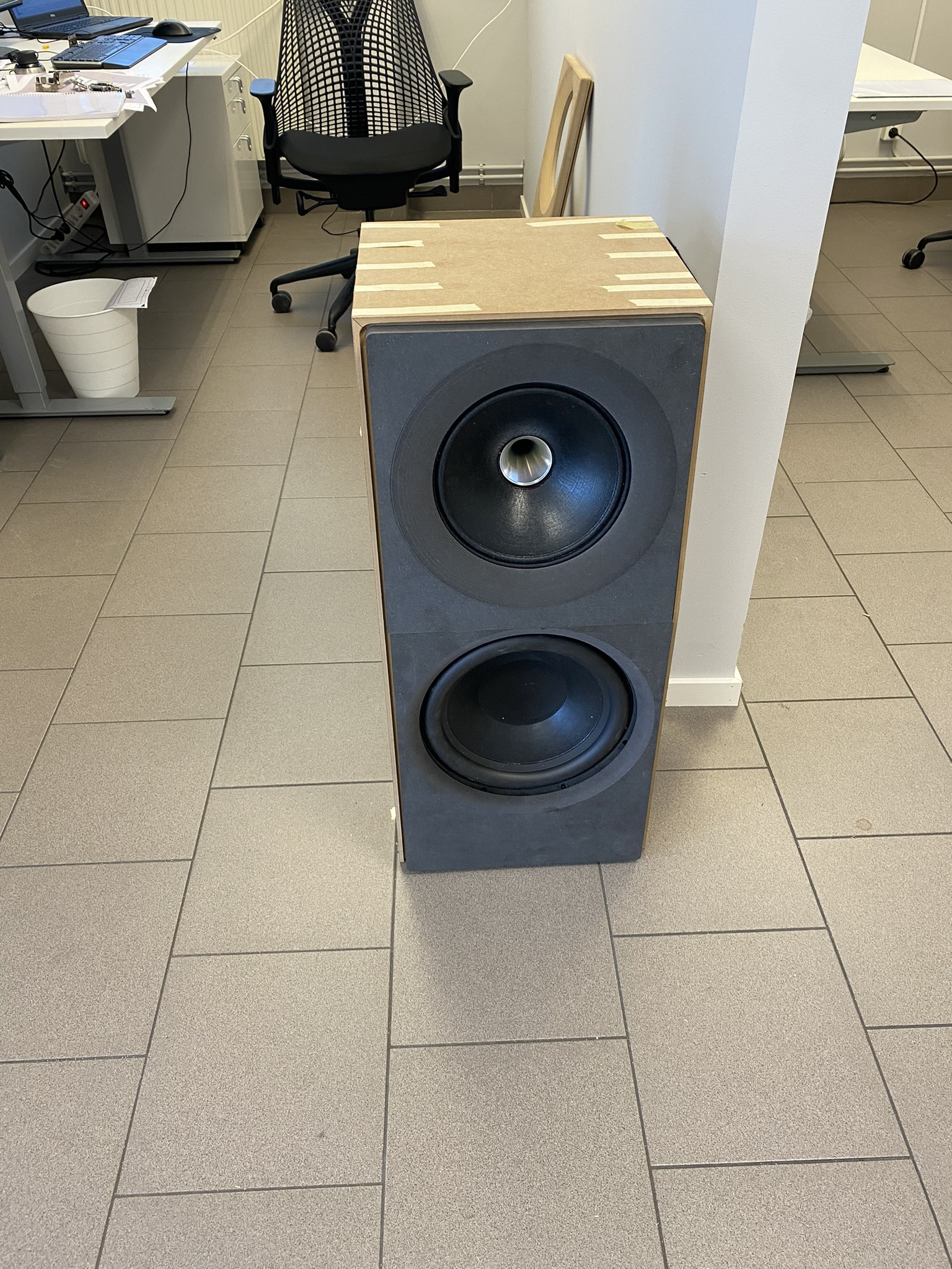

To just point out some possibilities regarding aesthetic, driver-related and other considerations.
In all the pattern control study-related sims I have done and given in the above posts, I have just considered a coax (passive cardioid) + two woofers (one placed on the front of the cabinet and one on the back, like the ascilab-woofer). All the pattern control below 400ish Hz was done by changing the DSP settings applied on the two woofers and coax in the passive cardioid box. So the concept can be applied from desktop/standmount-sized speakers to floorstanding or monkey box type speakers.

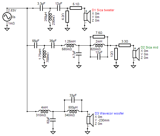

1) The single speaker with passive cardioid coax (with an easy-to-do passive crossover, at least with SICA drivers) + two woofers in the cabinet can give the following radiation pattern configurations just by changing DSP settings: omni (bass)+cardioid, cardioid(bass)+cardioid, dipole(bass)+ cardioid
2) The speaker can look like the below (with an additional back woofer in these cabinets) with bigger coax+woofer combinations. As a separate coax top + woofer module as shown in the first pic or as one integrated box with internal partitions to separate the woofer cab and passive cardioid coax cab (all pictures are from some excellent projects by @airvoid 🙂 )
After all, it can get that 'monkey box' looks if needed 😉
For those interested in slimmer cabinets and taller floor standers, the ascilab-cardioid speaker form factor can be adopted..
Whichever way, the dual woofer concept remains the same (The box width-to-depth ratio, baffle treatment etc need to be agreed upon based on woofer module volume requirements/directivity transitions in the lower-midrange to midrange and any other considerations ). Here is a closer look into the baffle for the above speaker (just for fun and to appreciate the attention to detail that went into this build 🙂 )
2) The above concept speaker needs 3 DSP output and amp channels (per side) with a passive crossover on the passive cardioid top module. This can relax requirements on amp and DSP channels. And with an 8-channel output DSP setup, two channels can be reserved for dedicated subs later, if needed.
3) A sweet spot would be to have a nice 8inch coax + 8-10 inch woofers. And for those who don't like coaxes, it can always be replaced by a waveguided tweeter+passive cardioid midrange or non-waveguided tweeter + passive cardioid midrange, etc. The choices of woofers and the pattern control can be done as per max SPL/distortion/ low frequency reach requirements. In fact, if anyone is allergic to any potential low frequency passive cardioid related harmonic distortion rises, one can always replace passive cardioid mid with normal mid and side drivers (like ascilab speakers/kii speakers) for pattern control in the midrange 😉
Those additional 2 DSP channels that we have reserved by making a passive crossover-based mid-tweeter/coax crossover (out of the 8output channels from DSP) can then be put to use with the side woofers for required pattern control.
In short I feel this concept can work to some extent in addressing some of the boundary interference-related concerns along with speaker positioning and some absorption.
Also, with this kind of speaker, one can have a modular, configurable/application-driven directivity speaker.. How cool is that 😉 and how many manufacturers make such a speaker (as of now 🙂 ).
One speaker-many avatars at the flick of a switch (or DSP preset) 😛

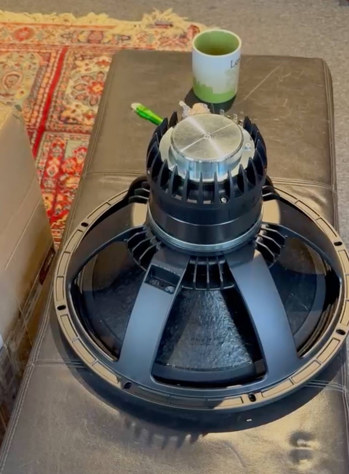

Regarding sizes of drivers and example woofers that can be used for a bass module, I guess the options are driven by cost and cabinet requirements.
1) For example, one can have up to 4 drivers per speaker and still have overall reasonable costs for the woofer module with this driver (Thanks to @nc535 who alerted me about the existence of such a driver sometime back)
https://www.parts-express.com/GRS-8...VRdRp-Eyw4mNohOrnUuYyzlj2bjsc8M6U5pvX9-so3qsw
