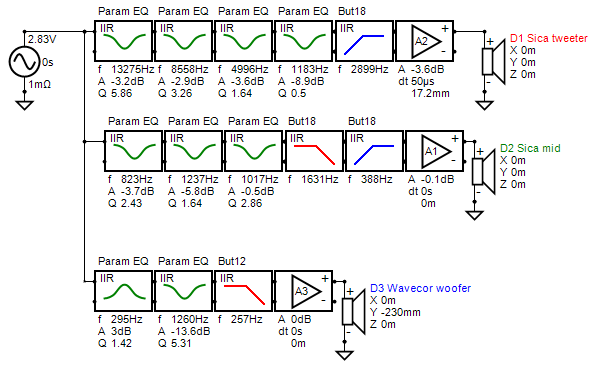

I personally am somewhat happy that this project has loosened some unnecessary (for some people at least) constraints on speaker form factor and would rather focus on a 'performance-optimized' 3way speaker.
But I would still suggest not getting blindly attracted to various loudspeaker designs just based on the aspect of pattern control down to 100 Hz. For example, here are the actual measurements-based pattern control details of one of my own speakers.

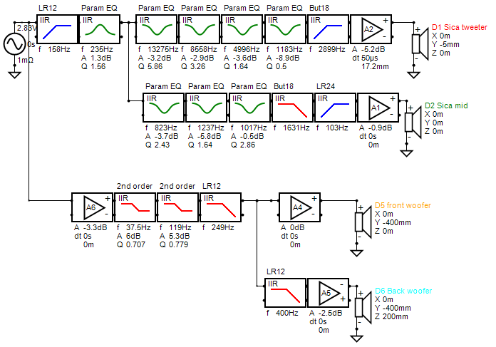

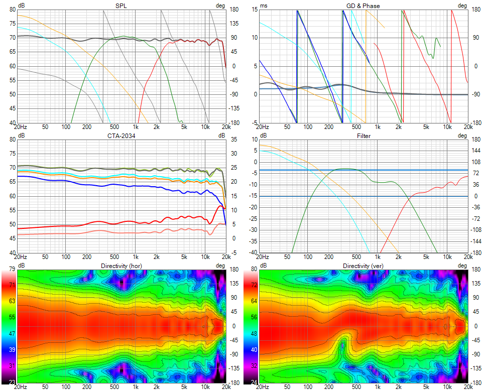

The above crossover was DSP-based using all IIR filters.

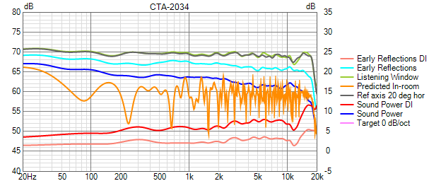

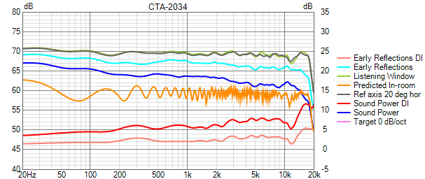

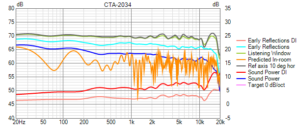

Here is a VituixCAD generated, first reflections-based room impact on the PIR (predicted in-room response)
The above kind of PIR is almost exactly what I measured in my room based on nearby boundary locations & listening distance.
Now, I don't know/was not able to isolate the exact impact of that orange curve in real-world listening sessions (given the other many other sub-optimalities in my listening set up).. 🙂 .
It is also worth asking what is the impact of the excess group delay needed to achieve the above pattern and whether it is tolerable given that there are some studies that say it is best to have the excess group delay around 100Hz to less than 2.1ms. For example, in the above speaker, the below is what happened because of several "choices" I made during the design stage by just blindly focusing on pattern control.
If one has access to FIR filters with a large number of taps, at least the excess group delay problem might go away to some extent, but questions surrounding how much pattern control is enough down to 100Hz are very well worth studying. For example, in the above speaker, the best attenuation I could get beyond 120 degrees or so is in the range of 10 to 12 dB.
Maybe things would have much been better with 20dB attenuation beyond 100 degrees or so and with careful positioning (if there's flexibility) and at least some strategies to combat floor and ceiling reflections.

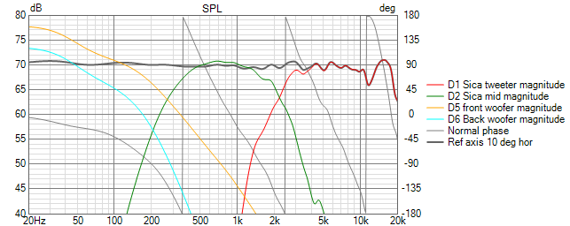

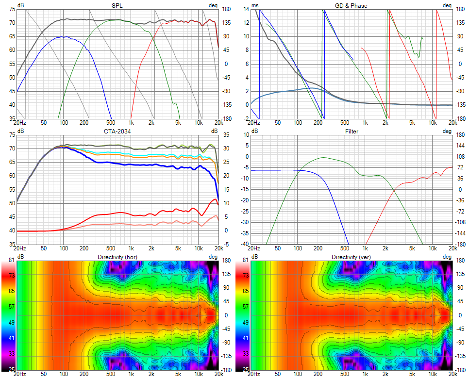

To initiate further thought process and brainstorming along the lines of speakers with good amount of pattern control to lower frequencies and to understand expectations in terms of form factor, here is an example of a speaker with a decent amount of pattern control; here is another one of my speakers having a smaller form factor.

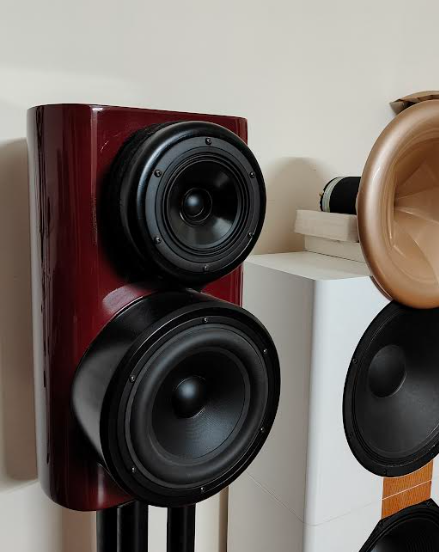

This is a speaker I use for my PC along with a low-cost DSP amp like this:
https://zoudio.com/

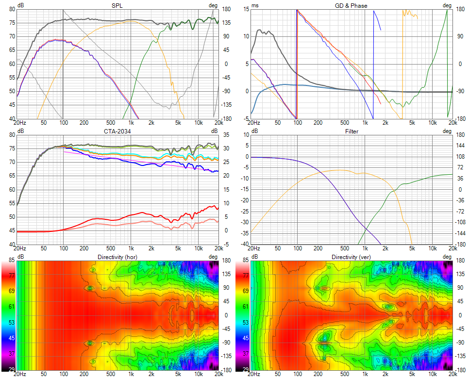

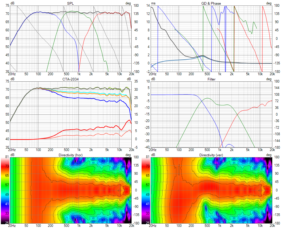

This is a 3way speaker with a SICA 5.5inch coax (in passive cardioid configuration) + Wavecor 8.5inch subwoofer in sealed box
Measurements with full 3way DSP active crossover

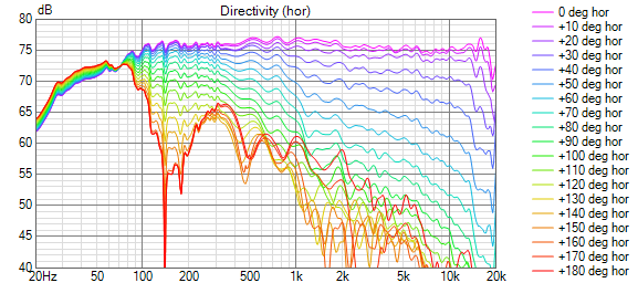

Impact of first reflections (Please note that the below 1kHz region is of more interest in all these pics since taming the above 1kHz region is relatively easier)

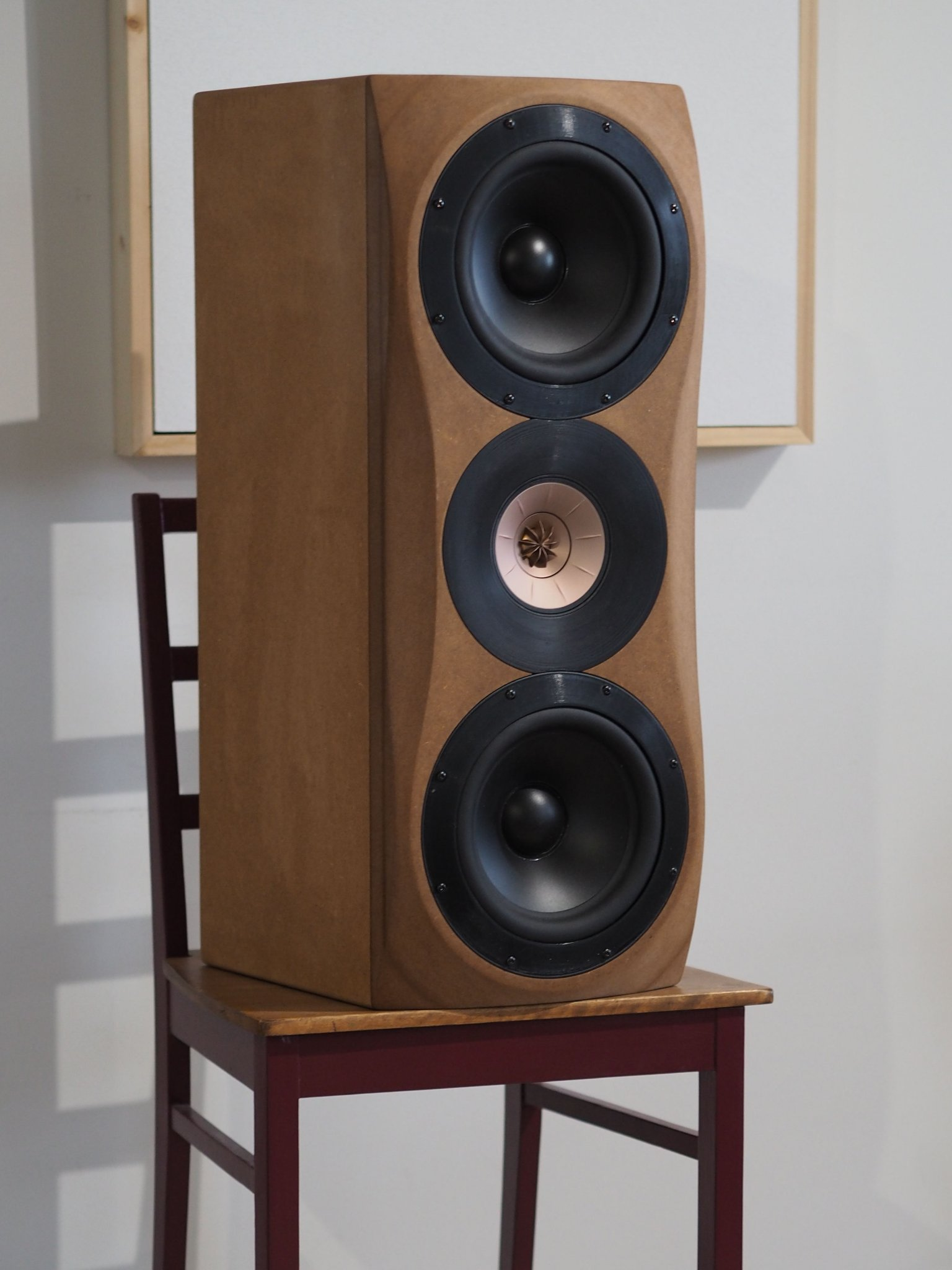

Adding another speaker to form an MTM configuration and possibly changing into a configuration like this with the coax still in passive cardioid mode (picture copied from MrStitcha's project)
This will extend pattern control down to something like below (Please note that I am just indicating possibilities w.r.t form factor and extrapolating results obtainable based on the 3way speaker shown in first pic. In a final speaker, the crossover may be completely different)

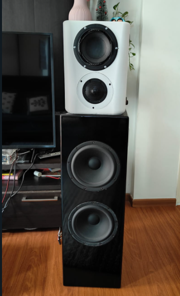

Now going a step further and adding side/back drivers one may be able to extend the directivity control to even lower frequencies. An example could be something like the ascilab speakers
It seems to have measurements like this
The speakers shown above also has the advantage of having a modular cabinet, relatively high SPL capabilities very good pattern control to 100Hz etc..
If one is interested in just the top module, a nice speaker can be made out of that as well.
(Since speaker stands are most of the time a waste of space and SPL capability/pattern control capabilities I mostly like floor standing versions).

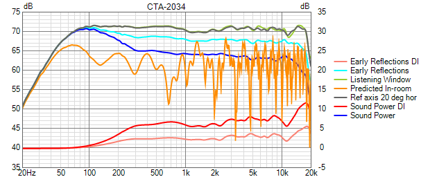

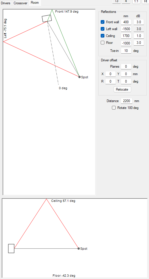

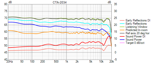

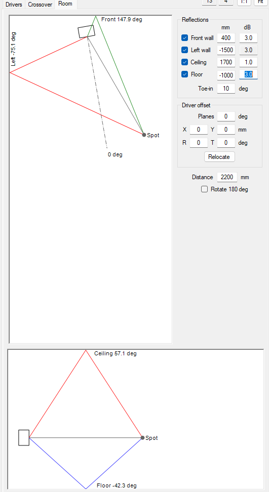

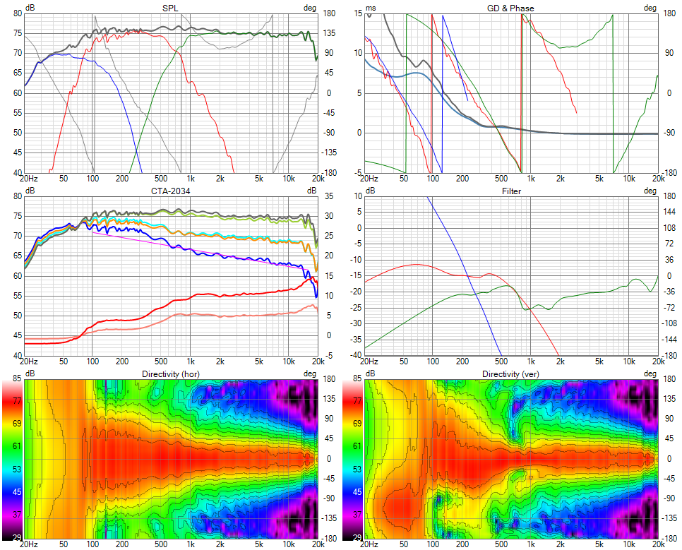

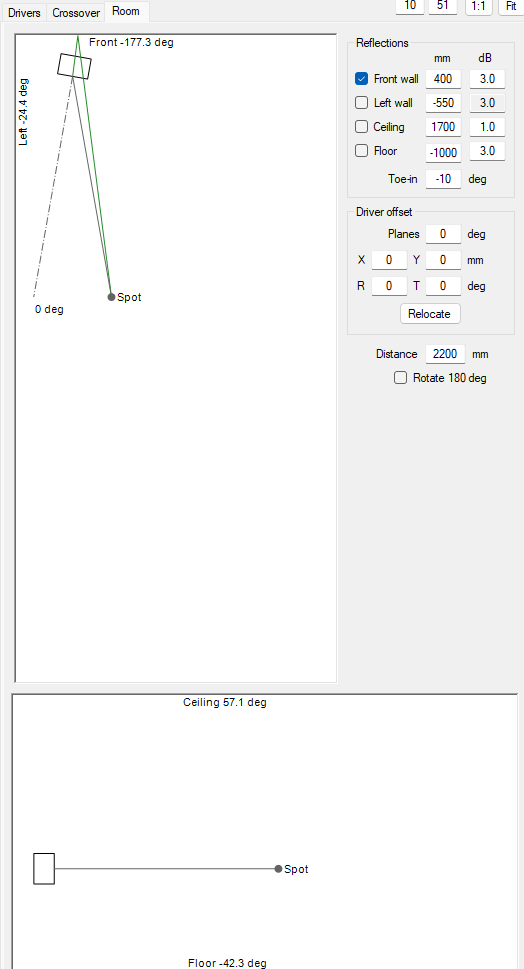

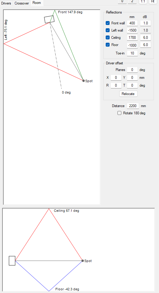

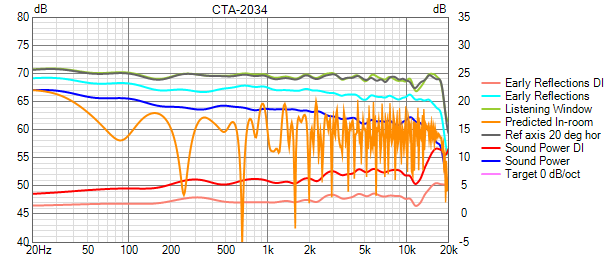

Here is a hypothetical speaker which is cardioid/cardioidish down to 20Hz . Above 1kHz, directivity is even higher.
This is created using my earlier cardioid SICA coax + a bass module similar to the one in the above above ascilab speaker pic with a woofer facing front and another at the backside 200mm away from the front woofer and facing the wall.
MLP is 2.2m away from speakers. I assume minimal to no room treatment. Speakers are toed-in 10 degrees

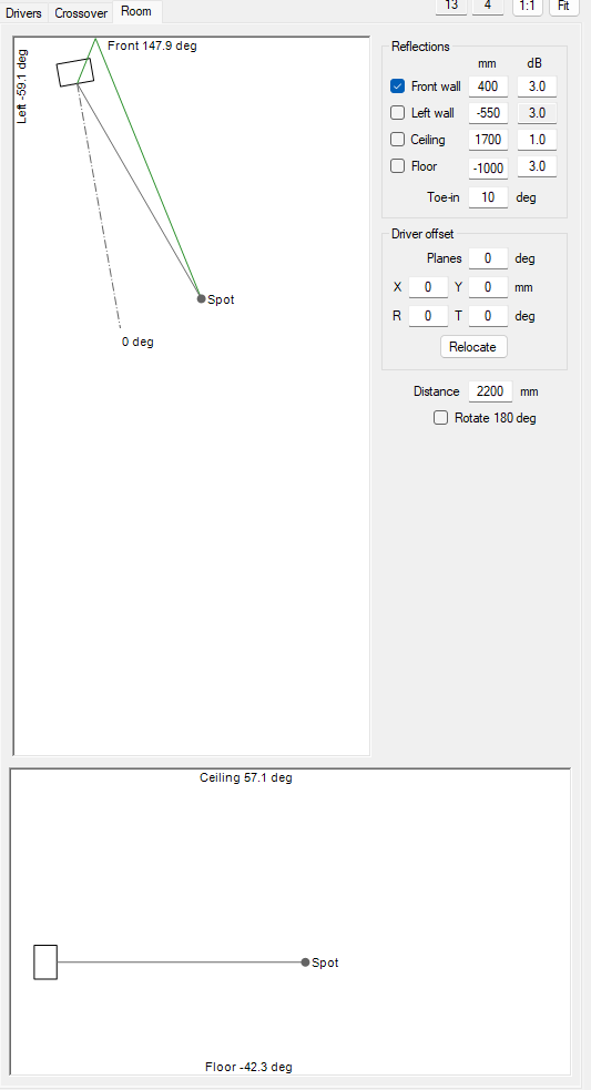

scenario-1: I push the speaker closer to front wall
Here is the impact on PIR
We can see the minimal impact of front wall reflections... Looks like cardioid works as advertised 🙂

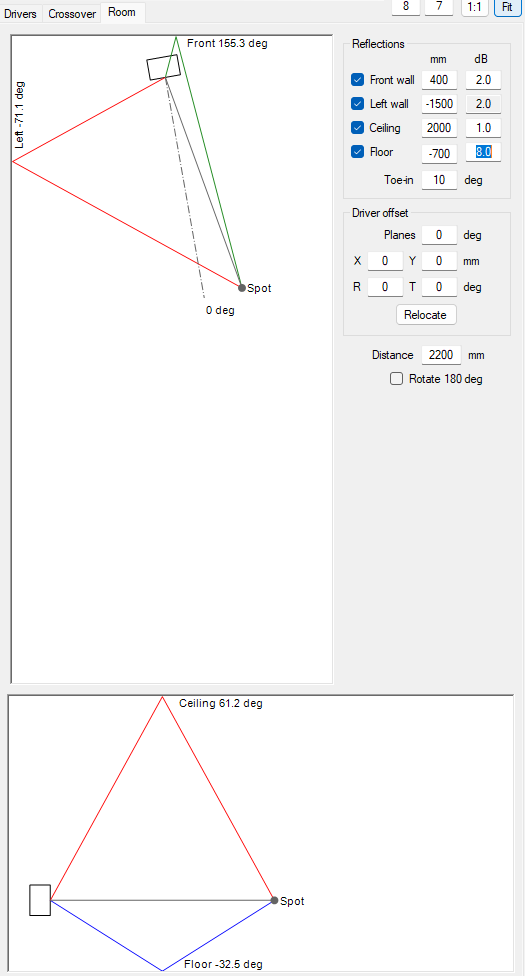

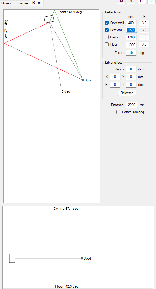

Scenario-2: Now I activate the front wall (400mm away) + left wall (assuming 1.5m away)
impact on PIR
Looks ok still, I think.. 🙂

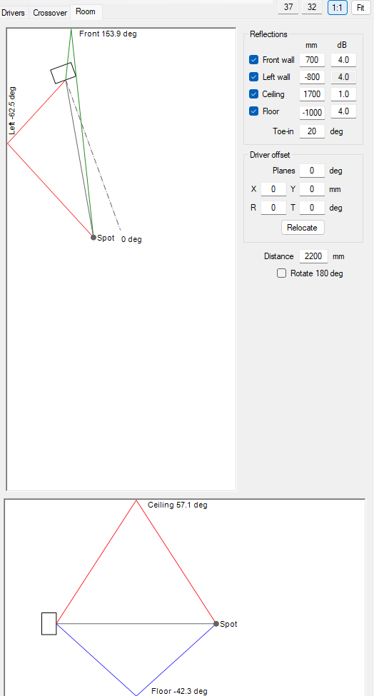

Scenario-3: Now I activate the front wall (400mm away) + left wall (assuming 1.5m away) +ceiling (1.7m up from reference axis)
impact on PIR
Maybe even this is ok.. 🙂
Scenario-4: Now I activate the front wall (400mm away) + left wall (assuming 1.5m away) + ceiling (1.7m up from speaker centre) + floor (1m below the speaker reference axis, with maybe a minimal carpet on the floor)
impact on PIR
Does it look ok now?🙂

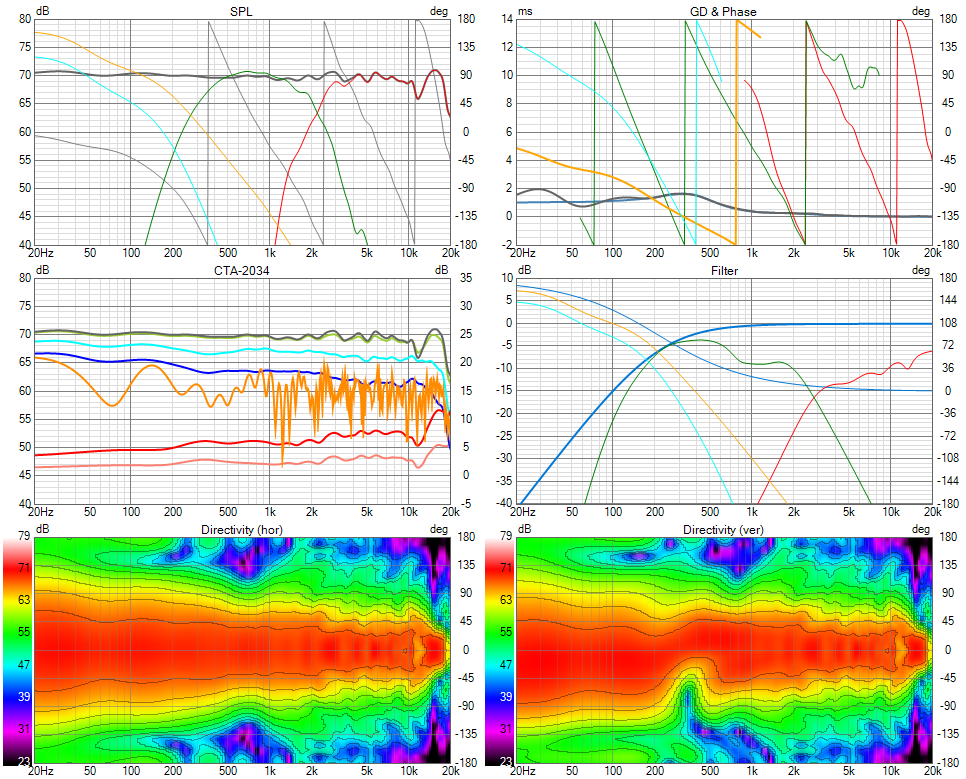

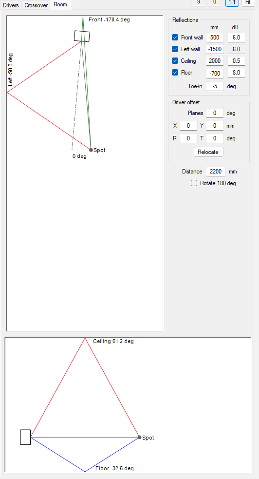

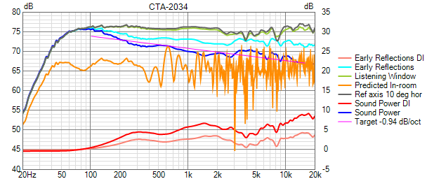

Scenario-5: I activate the front wall (400mm away) + left wall (assuming 1.5m away) + ceiling (1.7m up from speaker centre) + floor (1m below the speaker reference axis) + more absorption on the floor, and ceiling
Is this better?
I request those who know better about acoustics & speakers to comment about these aspects... I am a noob in this.
Reactions: Zvu
I have changed the speaker overall response slightly

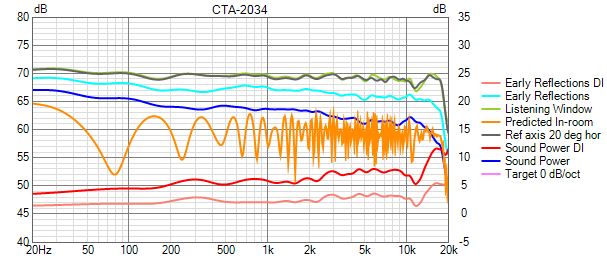

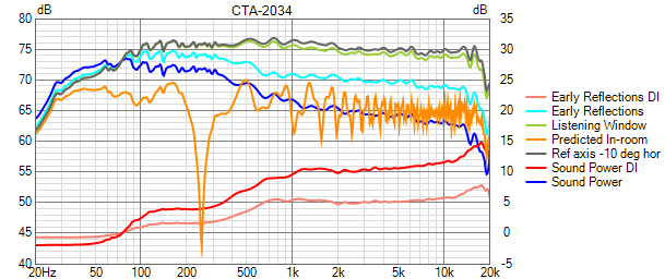

Scenario-6: All major reflections as above activated but the speaker is moved closer to the floor down from 1m to 700mm and a (probably) heavily absorbing carpet on the floor
Looks better than before?
Maybe there is hope with this kind of speaker.. 🙂
Reactions: Zvu
I dont know if all the above simulations are valid since the room tab in vituixcad looks to show(/model?) the speaker as a single driver with the polar pattern got for the whole speaker. Maybe when sufficiently far away from the speaker (like 2+m away) the simulations and the single sources assumption are still valid for even multiway speakers with relatively well spaced out drivers. I don't know exactly which distrances away from the speaker these assumptions are valid/when they breakdown.
But if they are valid especially for the below 1kHz region, I dont see the cardioid offering significant advantages over a relatively non cardioid speaker..

I am not familiar with the software you are using and the modelling assumptions it makes. Is it vituixcad on a windows computer?
