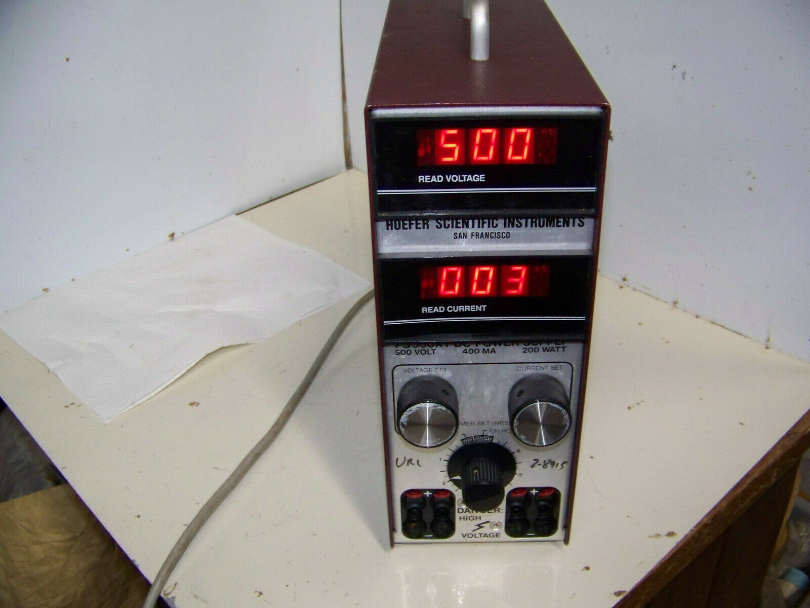

Plot the load line on the tube graph for the P-P OT Zpri ( /4), with allowance for the idle current at zero signal, to find the Vscrn needed. Or use a variable power supply for the Vscrn initially to find the minimum needed for max output. Usually no more that 150V is needed for TV tubes. But you don't want excess Vscrn, or high screen currents will occur when over-driven.
1) Hoefer PS 500XT 0-500V, 0-400 mA, 200 Watt, regulated, current limit, switching type supply (good for variable B+ supply) (recommend later model with fan on back)
Usually can get a good working one for around $100, don't see one right now.

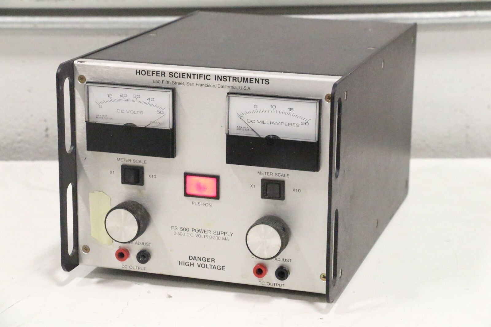

2) Hoefer PS 500 0-500V, 0-200 mA, 100 Watt, regulated, current limit, linear type supply (good for variable screen supply, fast limiting)
$19
Hoefer scientific PS 500 power supply, works as seen needs cord | eBay
