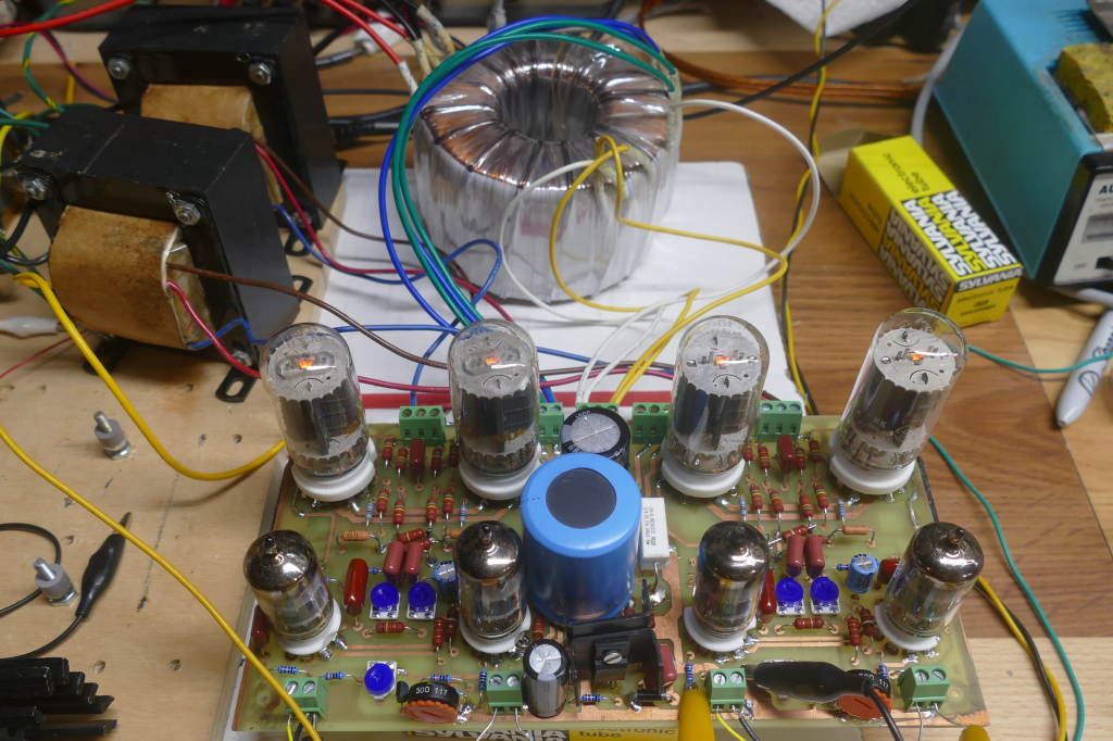

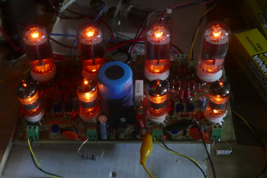

I have a DIY push pull amp with some of the tiniest sweep tubes ever made, the 6GF5. A pair of them can be squeezed to 80 watts without the red glow of death. My amp will make 80 watts per channel when run from a regulated 525 volt supply with a 6600 ohm OPT.
It makes 50+ WPC when fed with a cheap Antek toroid power transformer. The 525 volt B+ drops to around 450 when both channels are driven to full power continuously. Put a big fat cap in the power supply and call it a 50 WPC amp with 75 watts of dynamic headroom for transients.

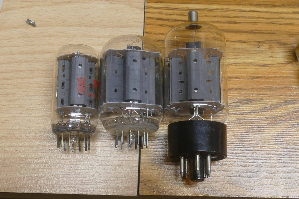

Note that the 6GF5 and larger 6GE5 are actually 6DQ6's stuffed into compactron bottles. The 6GF5's have the wings clipped off the plates to fit in the skinny glass.
The first picture shows the 6GF5 on the left, the 6GE5 in the center, and the 6DQ6 on the right. All have been confirmed to operate the same in the prototype design.
The second picture shows the amp running from an Antek toroid.

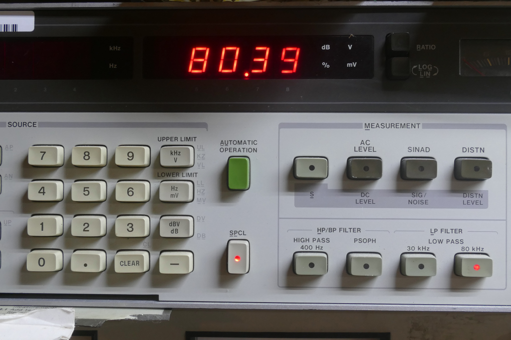

The third picture shows the power output at 80 watts when running on my Fluke 407D at 525 volts.....I didn't want to push the 500 volt caps on the board any further. That fat blue one in the center is wired across the B+ and could get real ugly if it blows up.
The fourth picture shows the THD at 80 watts, roughly 3%.
The fifth picture shows the tubes in the dark after several minutes of operating at 80 WPC. There is a slight hint of red in one tube.
If these little guys can crank out 80 watts per pair continuously without issue, then any of those big sweep tubes can do the same.....forever.

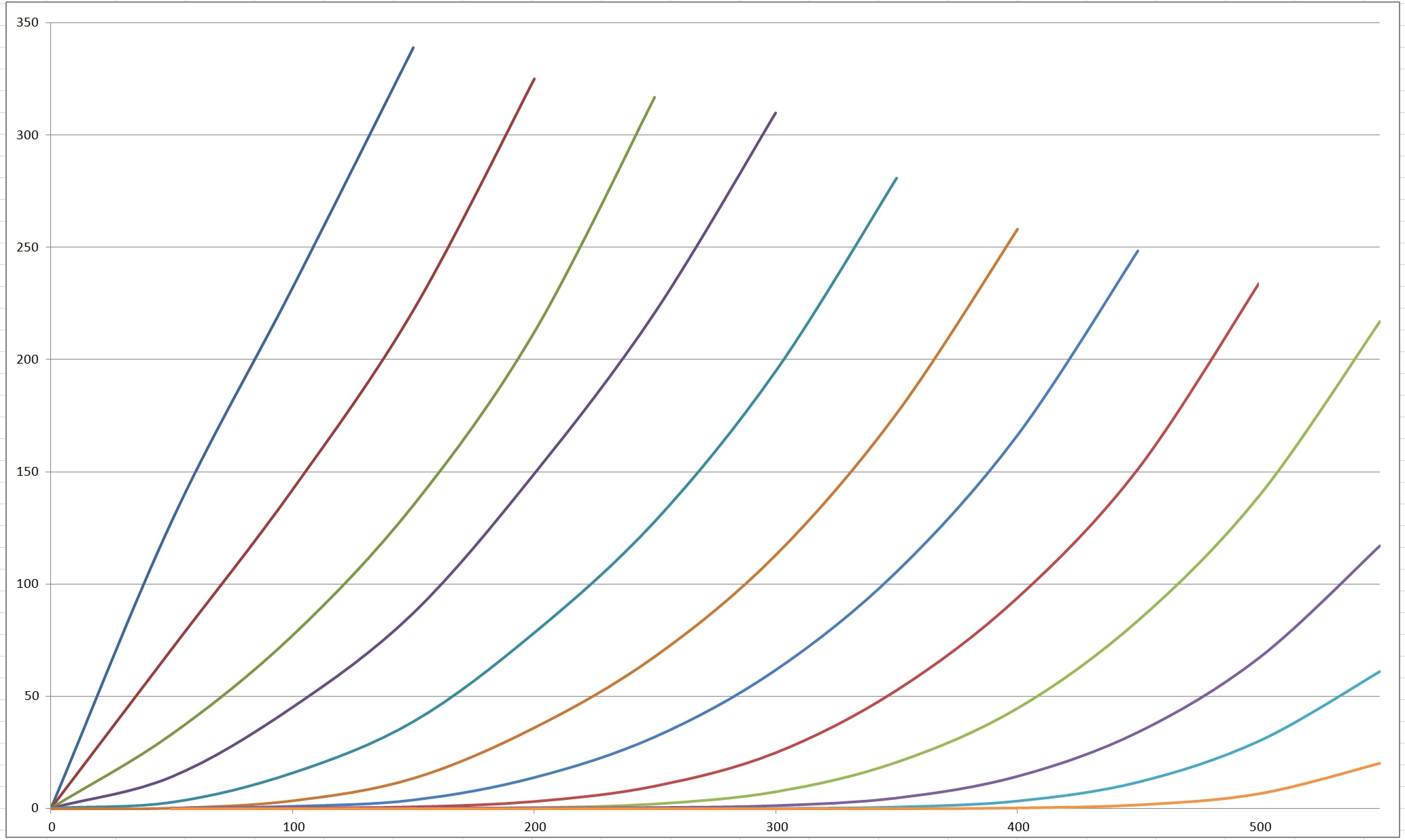

Note that this amp uses a new technique that I'm not quite ready to divulge yet. The sweep tubes run in triode mode, but their screen grids are happy at 150 volts......the 6th picture shows the curves I hand traced from a 6GF5. The slight error in the dark green trace is due to a bad pot in in the old power supply. The plate efficiency is about the same as conventional pentode mode though.
