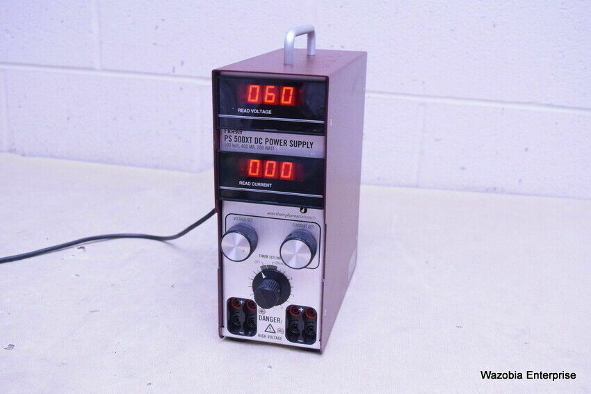

Just get one of these $99 Hoefer PS 500XT units, and dial in the B+ Volts you want. Even has a timer to shut your Hi-Fi off after you fall asleep in the easy chair. 0 to 500V, 0 to 400 mA, 200 Watt, digital readouts, current limit adjustable, regulated.
