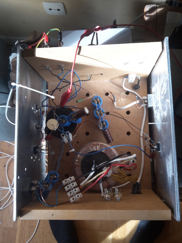

Today I built a new amp. Only one channel as before, but I managed to bolt the devices to two pieces of aluminum plate (heatsinks).

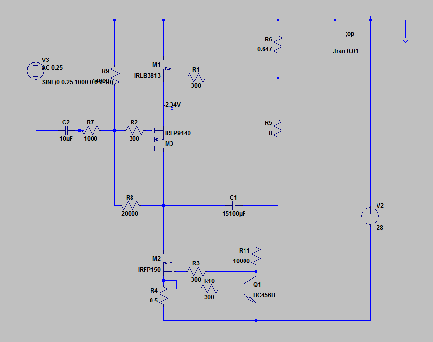

I turned it up side down and used the same IRLB3813 as a load sensing fet instead. I guess (and hope) it is much more linear as a source follower, and especially so at these very low voltages.
I used the power supply from an old amp and got 28 volts from the supply. There is two 4700 uF capacitors followed by a 4 mH inductance (an old coil from a passive crossover) and followed by two 4700 uF and one 1000 uF capacitor.
I use an old IRFP9140 as the main gaindevice. It should be much more linear then the IRLB3813 I used previously.
I can hear that it is happy with a lot more voltage then the old amp. 28 volts instead of 15,5 volts makes a huge difference. The IRLB3813 seems suitable as the buffer for the feedback (or negative source resistor if you want to see it that way). It only takes 2,34 volts which is the Vgs of the device at 1,32 ampere. I like the lower voltage over the device since it does not take as much available voltage away from the rest of the amp.
With only 0,647 ohm sensing resistor it does not have a negative output impedance. When I short a 10 ohm power resistor over the speaker leads while playing a 50 Hz sinus tone at 1,06 volts over my speaker, the output voltage drops to 0,77 volts.
It is very clean, warm, powerful and generally good sounding. I have only played music for half an hour or so, so I can not comment any more then that. It does sound very clean when running a frequency sweep from 10 Hz to 150 Hz at 4,0 volts out.

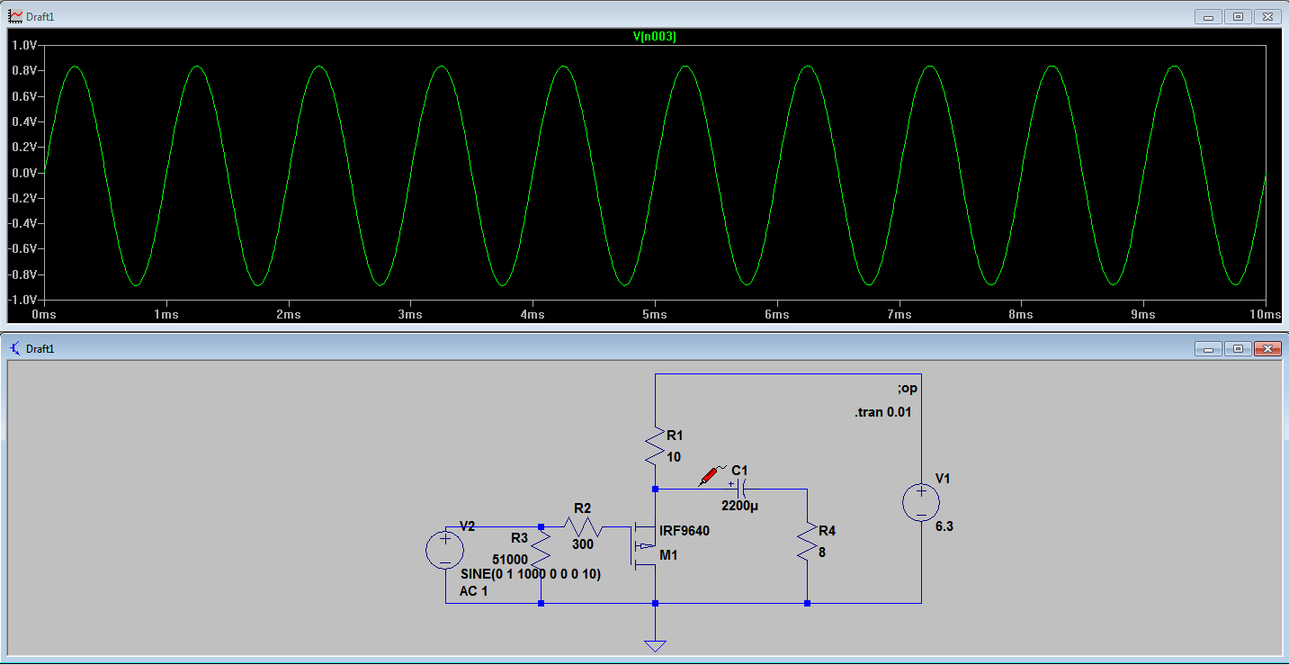

I made a short video of a test I made to hear what a source follower sounds like when running at a very low Vds (Vds = Vgs).
I used an IRF964 in LTSpice instead of the IRF9530 as in the amp in the video, but the difference is negligible.
With only 200 mA quiescent current it sounded ok. Nothing I would use a my main amp. I can't hear any distortion or nastiness, only a correct and plainly sounding amp without any voltage gain. With less then 200 mA I could hear some distortion, increasing fast with less current.
I would call this a torture test, as no sane man would run an IRF953 in a source follower configuration at these low voltages and currents as a real amp to drive speakers.
With 300 mA (or more) it becomes quite enjoyable to listen to. I have had it running in the background for the last hour. I get about 0,5 voltage-swing out of it when driven from the soundcard of my computer (measured by running a 100 Hz sinewave.
It is enough to fill my living room with enjoyable music.

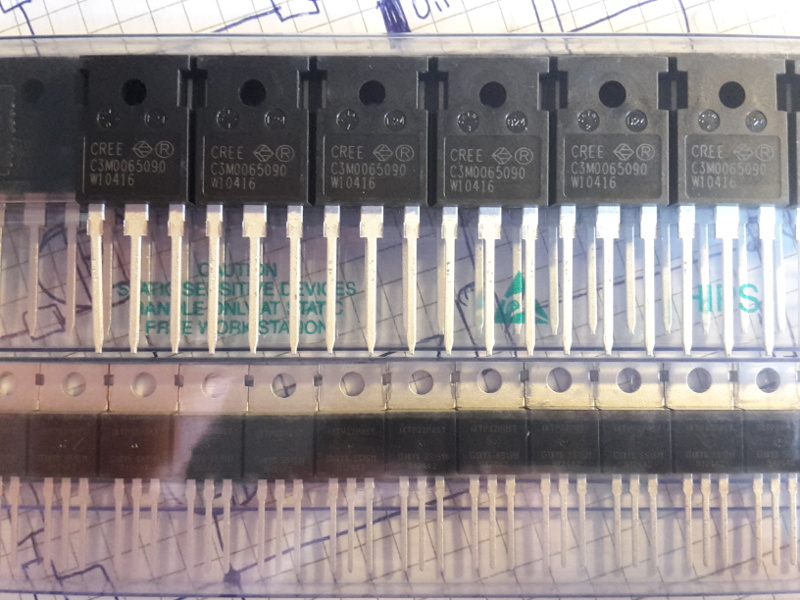

I am having lots of fun while waiting for my Cree SiC fets. They have arrived in Stockholm today....

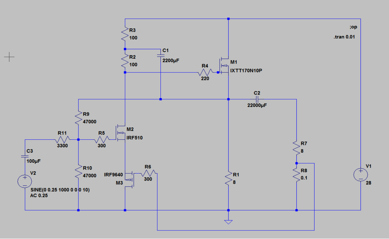

Here is a very simple two stage variation of the same amp. I have basically added a output buffer/source-follower to increase gain and lower the open loop output impedance (before adding PCF).
With only 0,1 ohm sensing resistor and a very powerful IXYS mosfet as source follower I get a negative output impedance. I can't calculate how low it is, but the output voltage will increase with lower resistance load according to the simulation.
Might be something to use if you primarily want to drive difficult subwoofers.
The source follower can have a constant current source, but I wanted to keep it simple for clarity. I like using simple power resistors instead of active constant current sources. It keeps the amp simple, stable and much more fool proof.
Power resistors are cheap compared to massive heatsinks.
Just an idea, based on the PCF-Zen amp, for anyone who wants to fool around it.

Please excuse my poorly restrained enthusiasm!
Cree creates happiness and glee...
This is going to be interesting. How will a SiC fet react to some positive feedback.
I have seen that positive current feedback supercharges the innate character of the gain device, which is not very strange considering that you are feeding a signal with the character of the gaindevice superimposed, into the gaindevice again.
The IRLB3813 sounds very powerful and aggressive by it self, but with some positive current feedback it sounded like a raging bull on steroids.
A IRFP9140 is a quite nice, plain device with a relaxed sound character. With PCF it did not change much. It sounds nice and relaxed until the PCF is turned up to near oscillation where it sounds hollow, distorted and metallic.
I hope some PCF can lift the SiC fet slightly. I don't expect SIT character from it. It does have normal penthode curves like most mosfets.
Johannes
