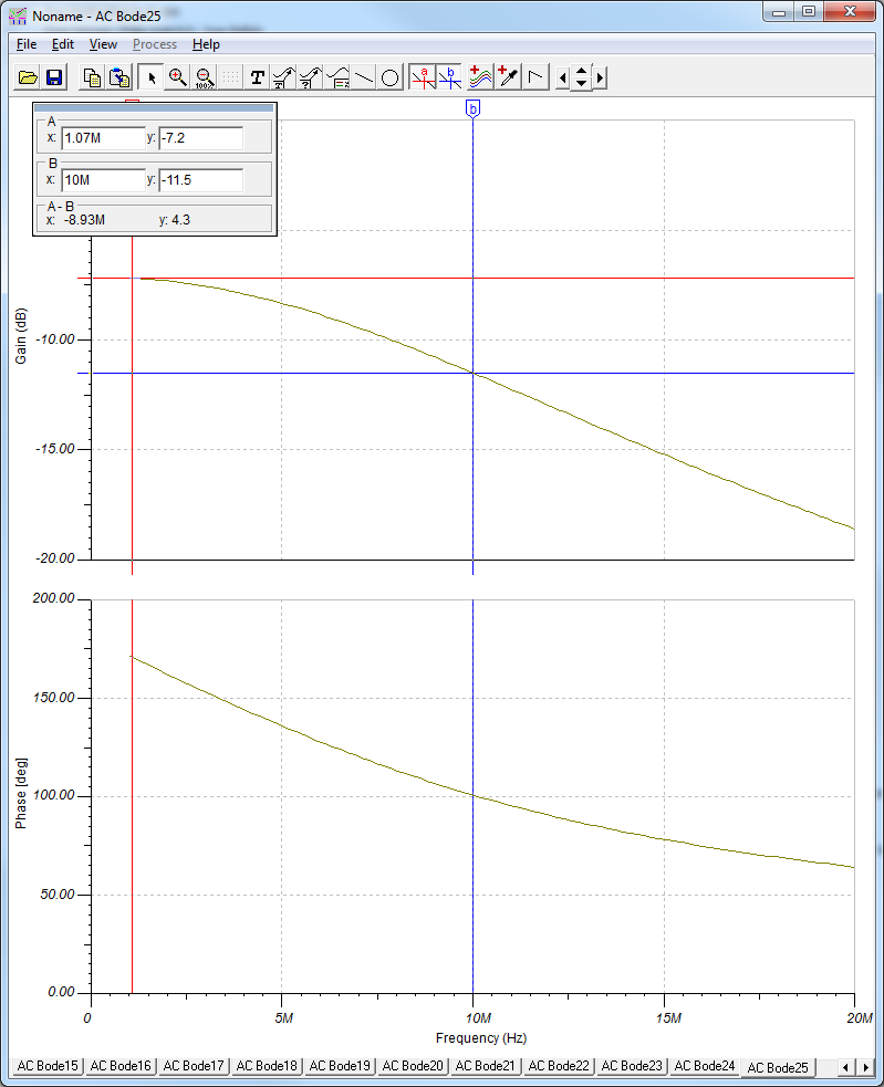

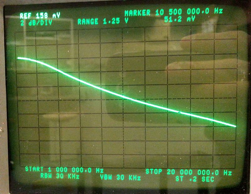

Here is a measured freq response with signal being injected into feedback midpoint (inverting input of the composite) via high-ish value resistor, to do not alternate noise gain of the circuit. Amplifier is loaded on a terminated 50Ohm line, so it sees 100Ohm load.
As you can see there is no peaking nowhere in vicinity of loop unity gain. The response changes somewhat with load impedance and a little bit more with output current, but stays reasonable. Sorry, have no time to do any more measurements.
There is also modeled response shown. It is somewhat different, but close enough to use it as a fist approximation. Nobody really expects that there 1-st level models can be used for the final stability evaluation.

but you (unnecessarily) roll off you input with it too
It was an intention, to use this circuit as an input low pass filter at the same time. Don't see any problem with is, as a cut-off is rather high, around 400kHz. I would move it even lower, put large NP0 caps in 0603 are hard to get, and I was quire restricted it terms of area in the design.
and of course read the LMH6723 datasheet carefully for the multiple hints of how GBW decreases with higher V gain
even the "bullet" specs
jcx, the real world behavior or the opamp with given values was evaluated and taken into account. Circuit exhibits no sign of instability. What else are you looking for?
as I said - I don't consider the circuit, values shown to give a comfortable stability margin with my reading of the chip's datasheets
a single "working" example doesn't change that estimate - you may have board parasitics that help, may have gotten lucky in the typ vs min specs of your batch of chips...
I personally would not put that circuit into production with those values, can't recommend it to unsophisticated builders without specific high speed analog pro EE level experience and tools
the same or even more audio frequency loop gain could be had with alternative compensation and the same chips with much greater stability margins
jcx
Don't make a drama. First of all, nobody puts this design into a mass production. OP asked rather general question at the beginning, he got also rather generic answer from my side.
Yes, parasitic may help, as well as they can make situation worse. That is why a real world evaluation is required and important. If it would be a manufacturing project, the evaluation would be much more extensive. It would be made for several chips from different batches, over the temperate, over the supply voltage range ect. And yes, it would be made withing guarantied spec.
In this case I built only one sample of the circuit, pushed it a bit further than the spec quotes, proved that it is stable within the supply range I want and the load range I want. It shows desirable level of distortion. It is good enough for a such scale DIY project
