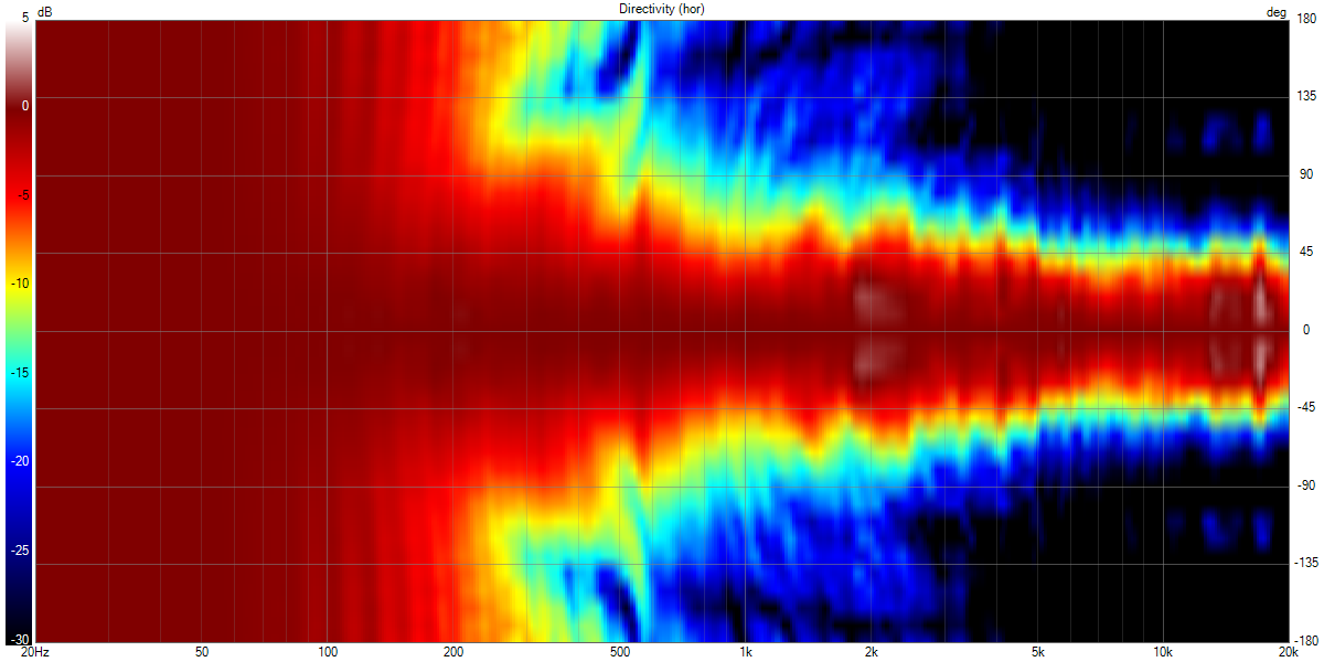

First results. The on-axis response needs a little fixing, so posting the spinorama after we get a new DSP file loaded and flatten the response. I think the input PEQ filters might have been disabled by me by accident in the hypex software.

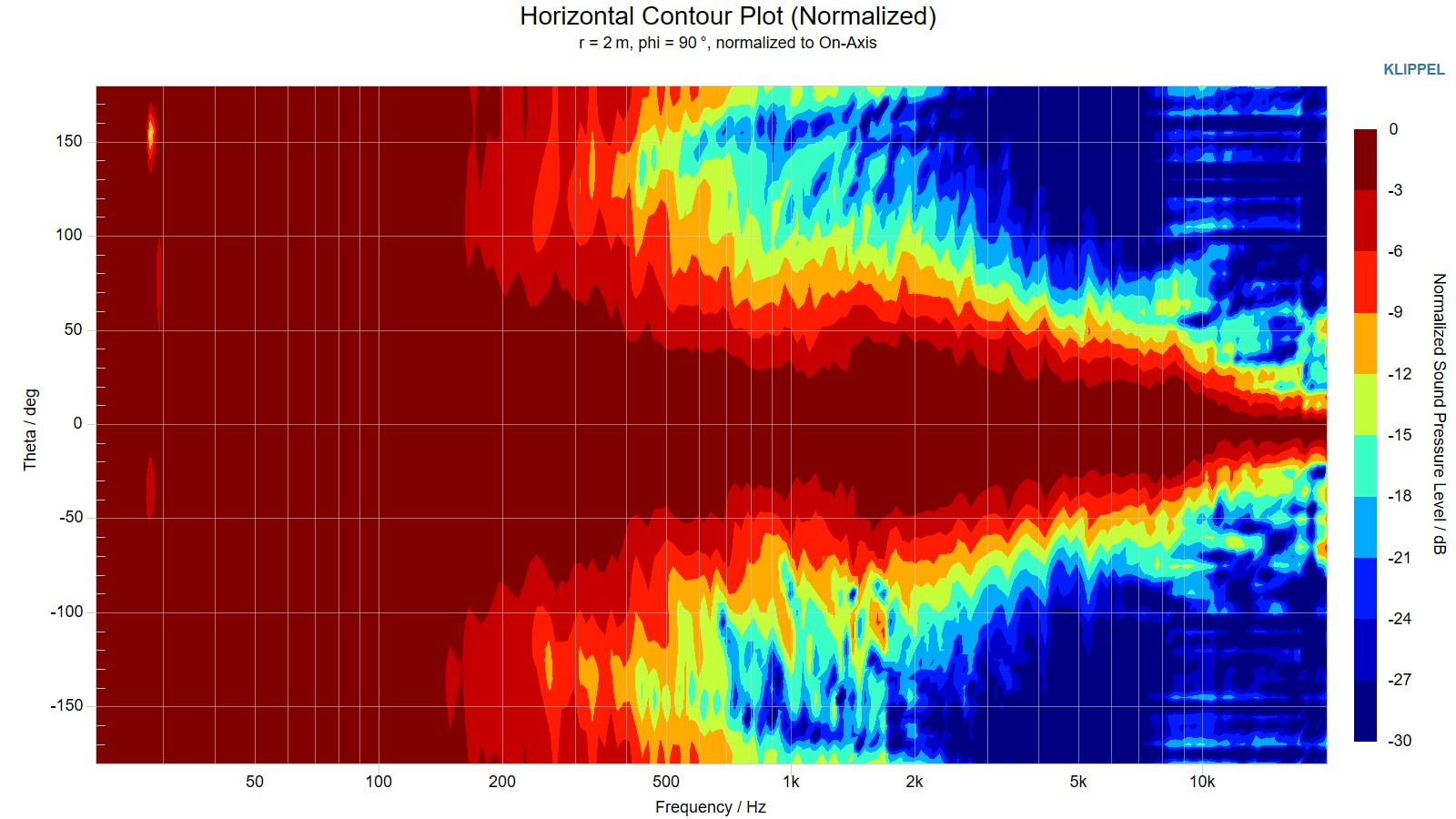

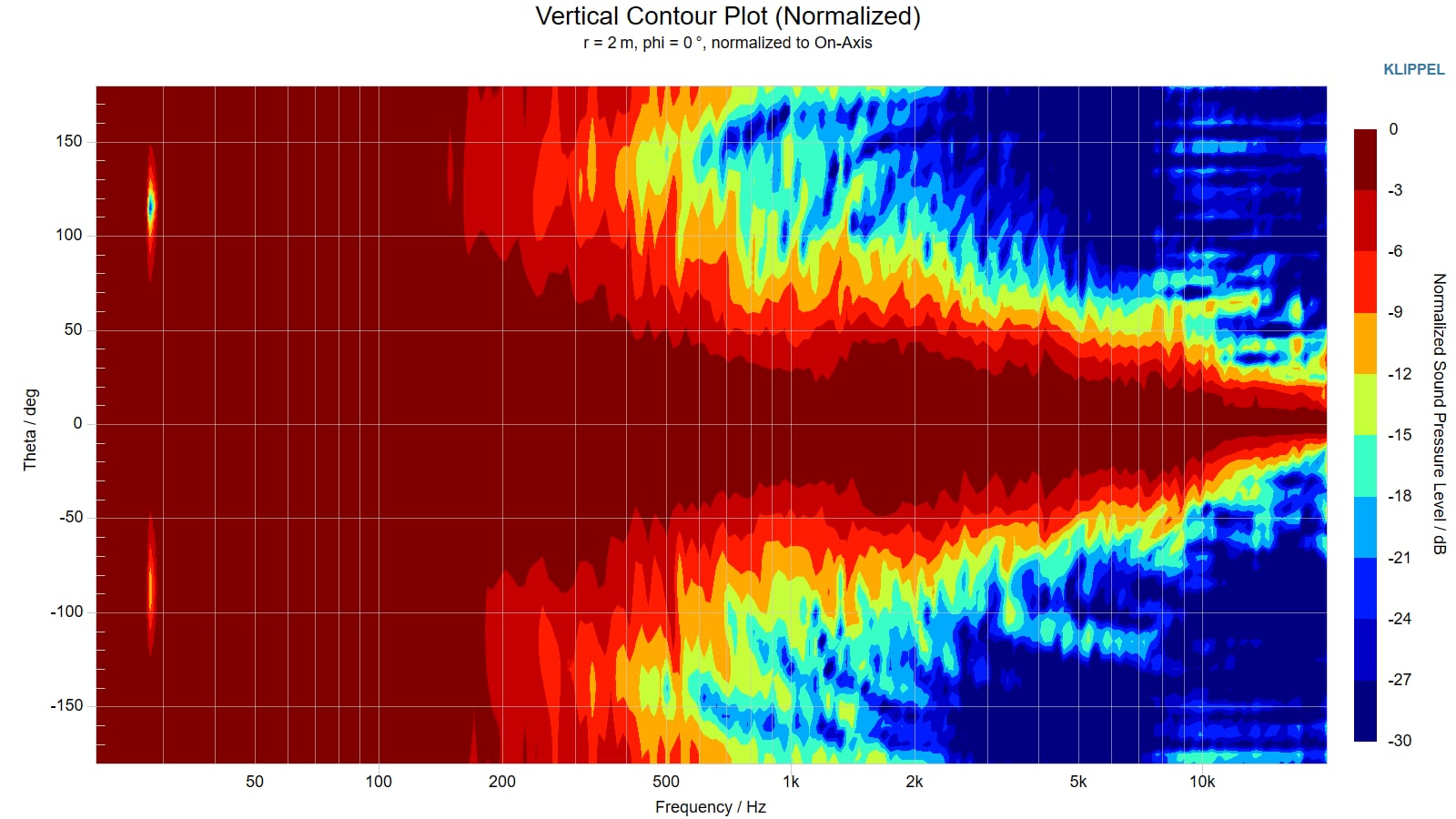

So a few things that stand out to me:
  • The narrowing at 1kHz is interesting. I imagine this is either waistbanding from the horn geometry or it's something crossover related as 1kHz is the xo frequency. Right now I'm using 4th order slopes, but may have some flexibility to go steeper or shallower.
  • doesn't seem like the asymmetrical port on the side of the enclosure is having any negative impacts to the polars being lopsided or uneven, which is good. I think a couple of people had pointed that out to me as a point of concern previously.
  • narrows a lot above 10kHz, slightly disappointed by that but also not surprised as my measurement setup doesn't really get accurate data that high. I'm curious since the "knuckles" are positioned on the horizontal and vertical axes if a 10° inclination (or roll?) would show that they're wider that high up.

Personally, I’m curious how audible these little diffraction elements are. Once we get the proper DSP setting I will run the impulse response through a convolver and see if there’s a noticeable difference in an AB test (assuming otherwise linear on-axis response). Might even dump the files here if others want to do a ABX test via foobar or otherwise.
I’m excited to see where this goes.
Other notes: as John said, it’s nice to see that

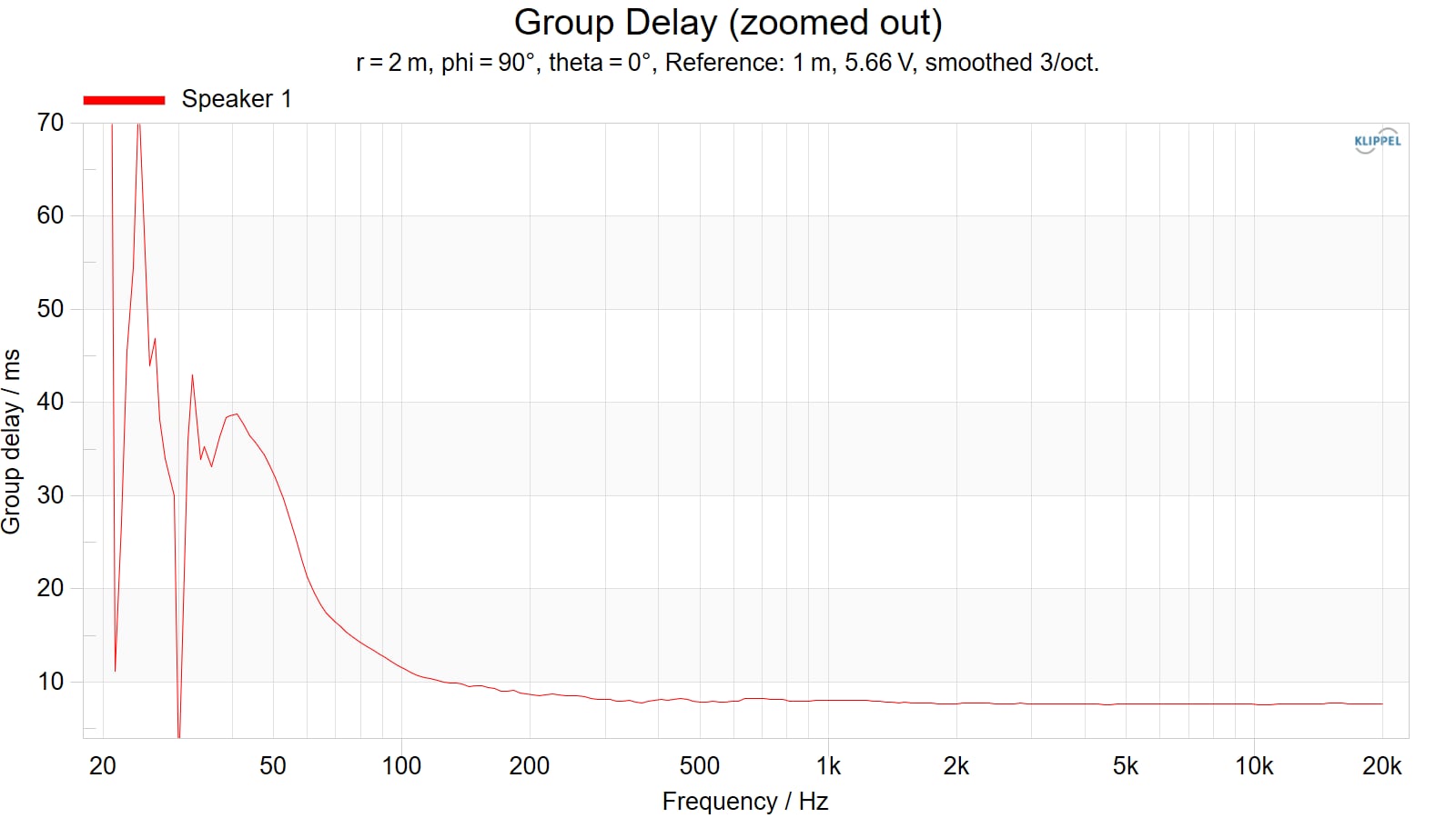

a) the port doesn’t create any irregularities; evidenced by the symmetry of the horizontal contour. If the port were resonating you’d see the side-bias here and what little I do see is me looking hard for any inconsistencies. The group delay also shows no large differences through the midrange which is another sign of no port or enclosure resonance.

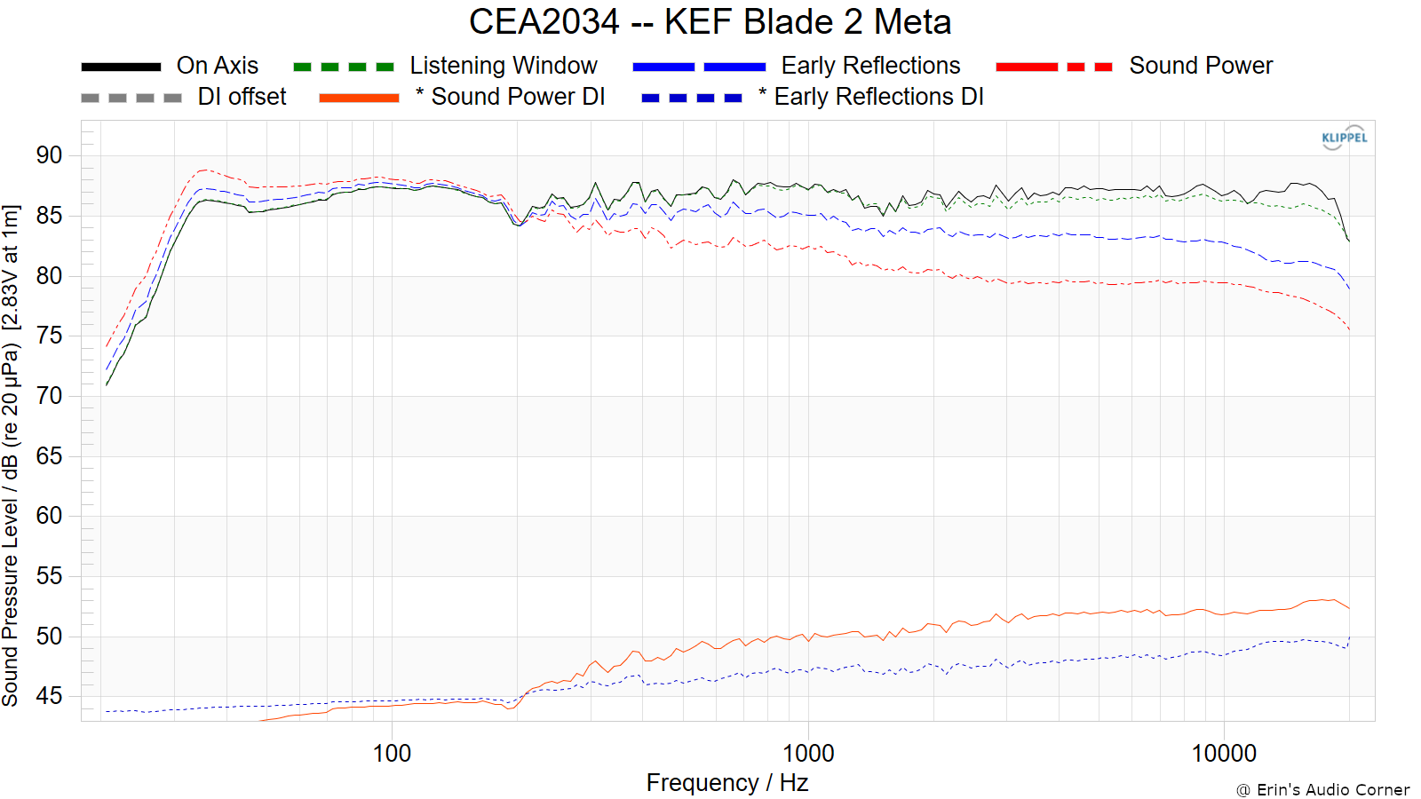

b) the directivity is damn near perfect. I haven’t seen sound power this linear since I reviewed the KEF Blade 2 Meta (below). This means any issues in linearity can be resolved via EQ or if one wants to add “flavor” this can easily be done without worrying about the early reflections not matching the direct sound in a room.
KEF Blade 2 Meta below. Amazing performance from a passive speaker. Albeit at $30k/pair.
https://www.erinsaudiocorner.com/loudspeakers/kef_blade2_meta/

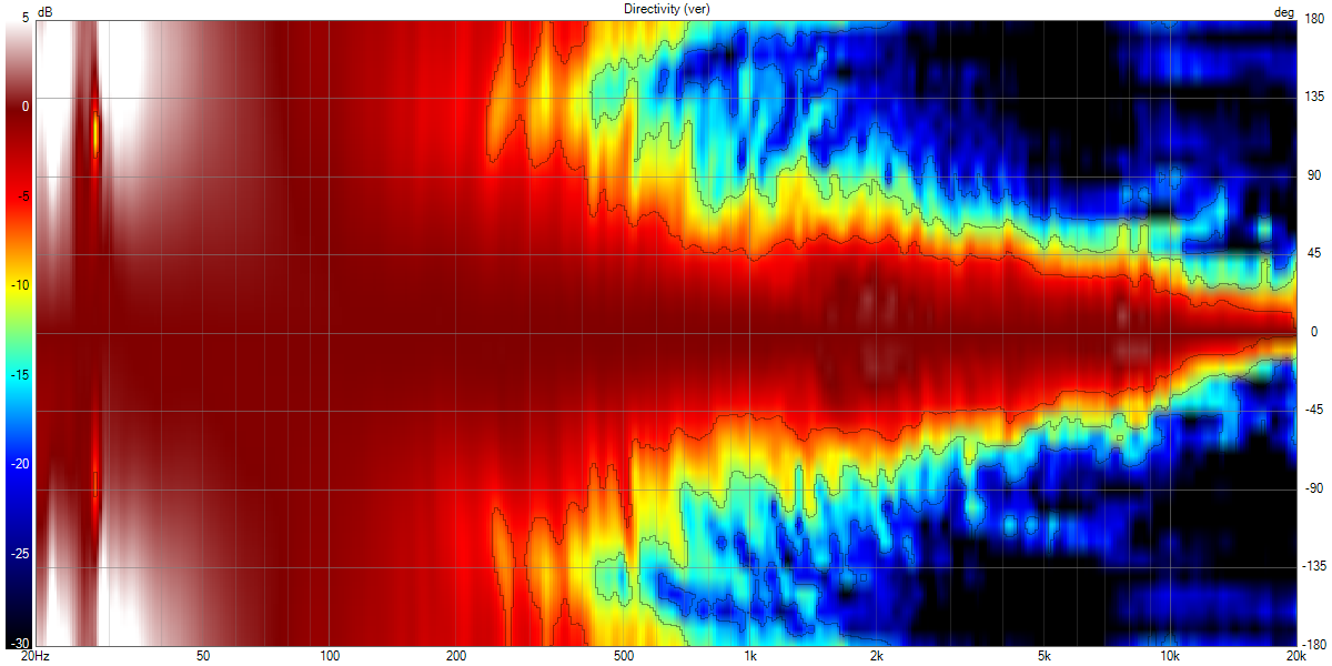

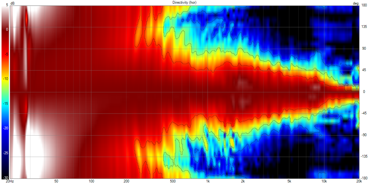

Just for visual comparison's sake, I loaded the Klippel files into vituixcad to see how they look against what I measured using the ground plane + gated method on a turntable. Part of getting this speaker measured was to identify deficiencies in my measuring techniques. Other than the >10kHz discrepancy, I do think that the general shape of the polars does seem to agree.
Ignore below ~80Hz obviously.
DIY Turntable Horizontal:
Klippel Horizontal:
DIY Turntable Vertical:
Klippel Vertical:

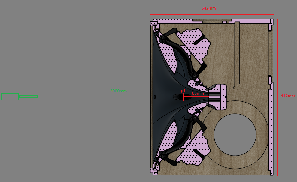

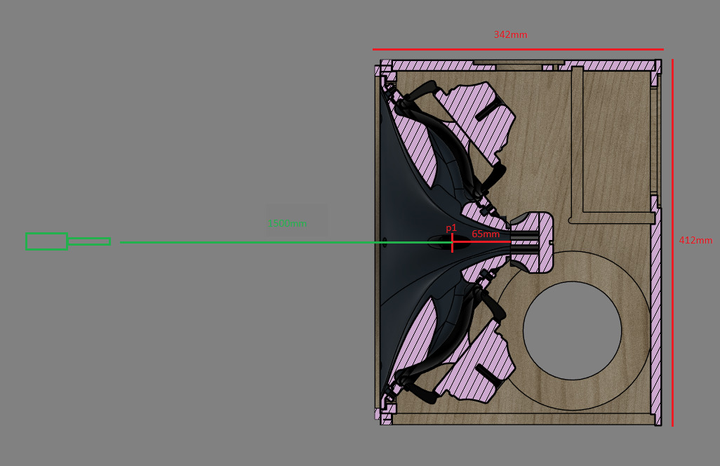

I use this guide for the gated measurements with the speaker on a tripod elevated about 2.2 meters from the ground and the microphone at a 1.5 meter distance from point p1 shown below. The box is rotated around p1 for taking off-axis measurements.
Instead of using the guide's nearfield bass instructions, I move the speaker out to a large parking lot and take ground plane measurements at 1.5 meters. This is done with tilting the speaker down and using a digital level to ensure that the angle places the microphone on-axis. I merge the ground plane responses with the gated responses at 400Hz in vituixCAD.
This is all done with a Focusrite 2i2 2nd gen interface and EMX-7150 mic.
As far as how confident I am that the microphone is precisely on-axis during the gated measurements - not very. I try to line it up as close as I can, but the wavelengths are very short in the top octave, so I think small errors of a few cm could likely result in the the previously mentioned discrepancies - especially given the complex geometry of this waveguide. Again though, I'm not going to stress too much about getting accurate data that high up with my measurement process as the Klippel is far more reliable and takes the guesswork out of the equation.

The reference point for the NFS would be the front, I assume, as opposed to your offset point. Some slight vertical misalignment on the manual measurement might also come into play; horizontal, not so much, as that would show in left-right deviance in the chart.
Fwiw, I have such a comparison (automatic turntable vs. NFS) behind me, and the results matched very well up to 20 kHz - so this is why I was surprised by this drastic difference here in the VHF region and was trying to help diagnose it.

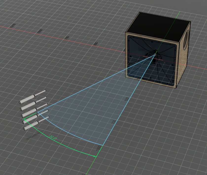

On one hand, I do have a couple of waveguide variations in the build queue to test, but on the other I do think i'll be doing some more investigation on the top end results to understand what might be happening. I think I'll set up a measurement rig as shown below and vary the elevation of the mic over several positions to see the effect in the HF.
My hypothesis is that the polars in the top octave might be wider at elevations corresponding where the valleys are in the waveguide. The practical/subjective perception implications of this is unclear at this point if true though.
