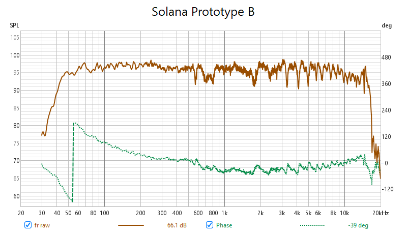

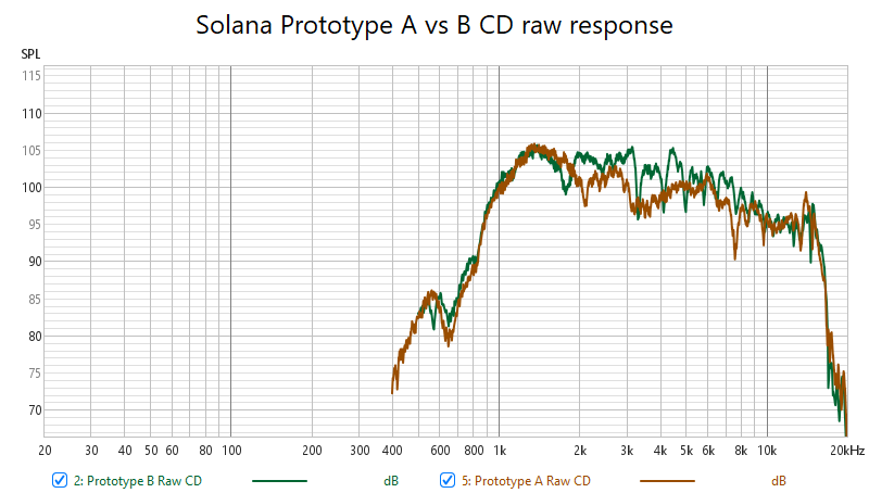

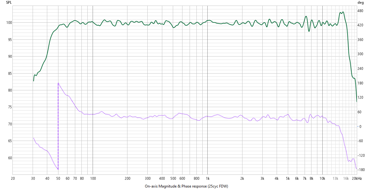

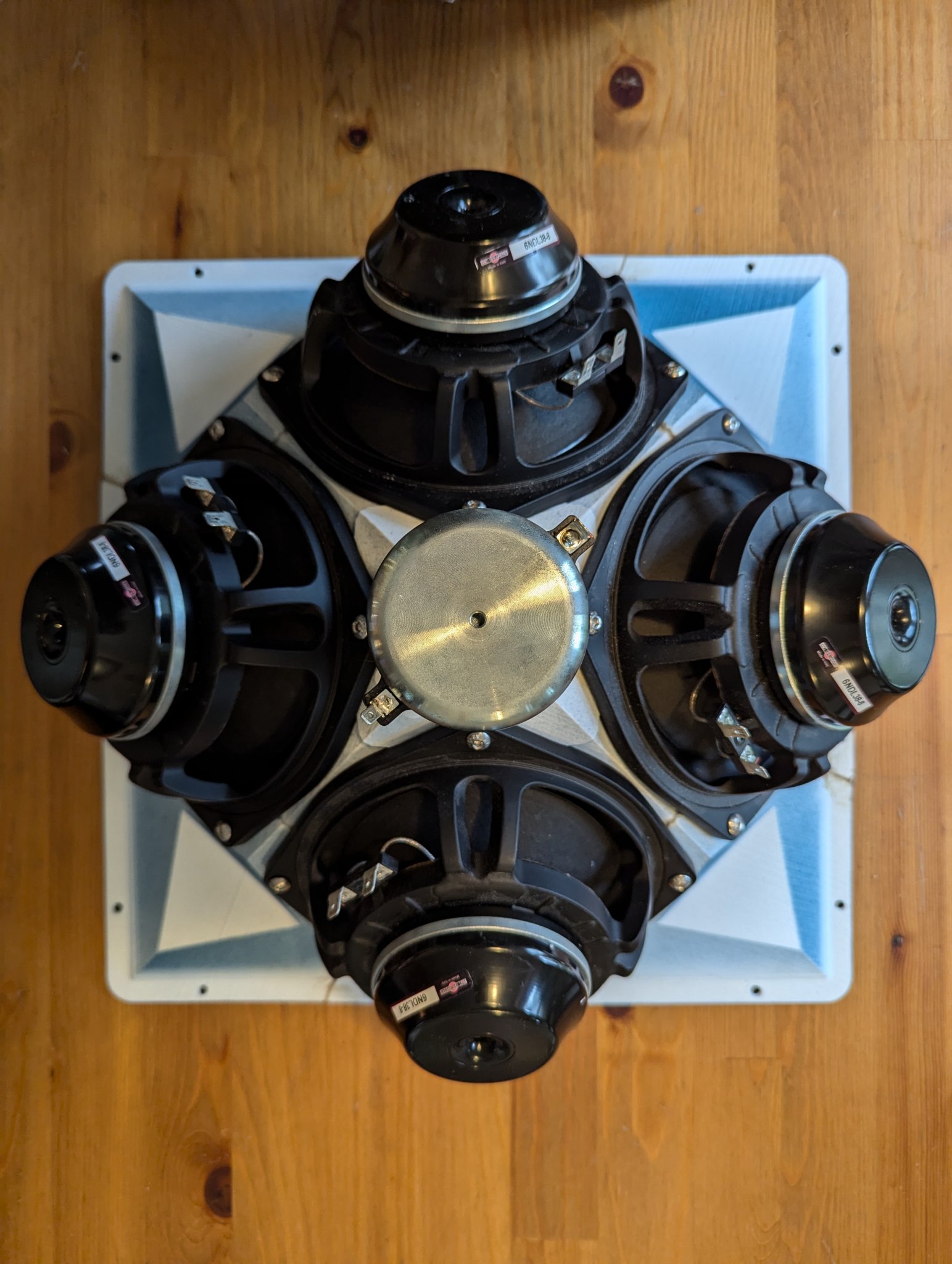

Prototype B is assembled. Did some preliminary testing/tuning to get a flat-ish FIR preset going on the hypex. Will take polars & distortion measurements on a later date.
You can see the on axis comparisons between prototype a/b below. The main differences being:
1. More bass extension as a result of a slightly larger enclosure & different port tuning
2. More leakage from the woofer taps >2khz as the acoustic lowpass effect is likely less effective than having the taps positioned at the edge of the cone (this was expected)
3. Slightly more sensitivity from the compression driver in the 2-5k range, not sure why, but it's small, so could just be measurement error.
There are some interesting high q dips at 3.3k, 4.1k, and 5k that may warrant some investigation, though I doubt they would be audible. They could be related to the way I measured (ground plane), so I'll try and get the speaker elevated and do a gated measurement to see if they're still there.

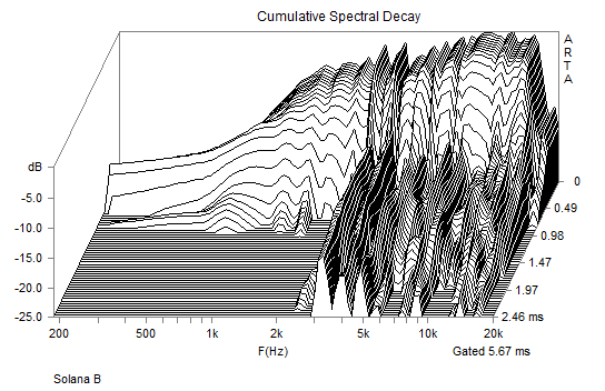

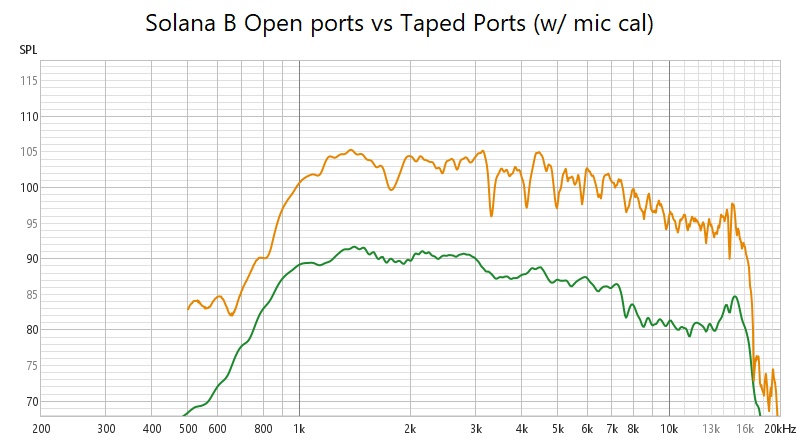

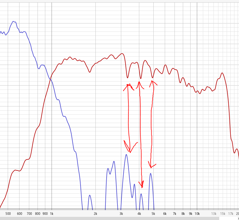

Further fine tuning and comparing the response I'm comparing my measurements of the DH450 on this waveguide versus the published B&C response (as measured on an ME45 horn) to weed out what shouldn't be there.
Mainly interested in investigating the nulls occurring around 3.3k, 4.1k, and 4.95k. These seem to appear in both the compression driver and the woofer's responses, and are not present in B&C's graph (on the right).
So my first thought is that this could be resultant of a throat reflection occurring due to diffraction at the edge of the tap. This would make sense if any potential diffraction sources lined up with the 1/4 wavelength of the nulls, but they don't appear to.
Upon further investigation however, it seems like this is far more likely the result of resonances from the waveguide material itself as evidenced by the long-tailed ridges in the CSD plot (thanks to @Nissep for setting me straight on this).

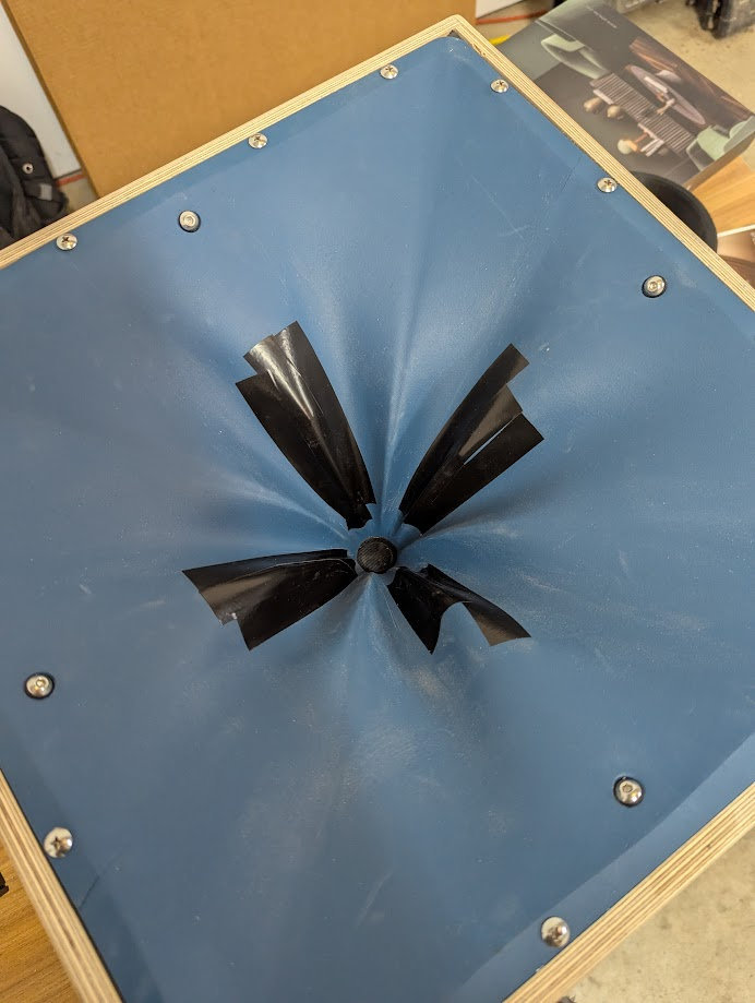

So the next step will be to measure the compression driver with the taps taped over. If the nulls still appear, it seems like the material resonating would be a cause. If they are eliminated, then it might be something else.

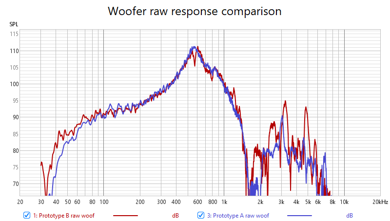

Hey, great work. Very impressive designs and overall concepts!
The effect of changing port location (and size?) is quiet remarkably. It is hard to see from the pictures, did you change the port size? The four ports seem bigger but are they double the size? What is the actual port size in comparison to Sd?
I could not find any distortion measurements of version A, did it change for the woofers with the different ports?

As far as the port area, the area of each port in revision A was 7sq cm. Since I halved the number of ports in revision B, the area doubled to 14sq cm per port. The Sd of each woofer is 132sq cm. Although the port size is a bit difficult to estimate since the geometry is weird, so take that with a grain of salt.
Reactions: 6thplanet

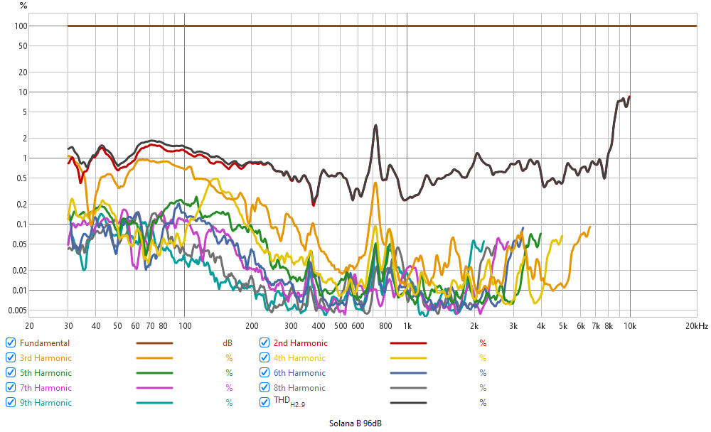

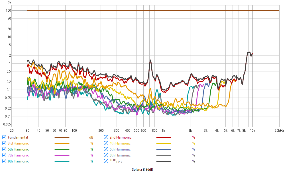

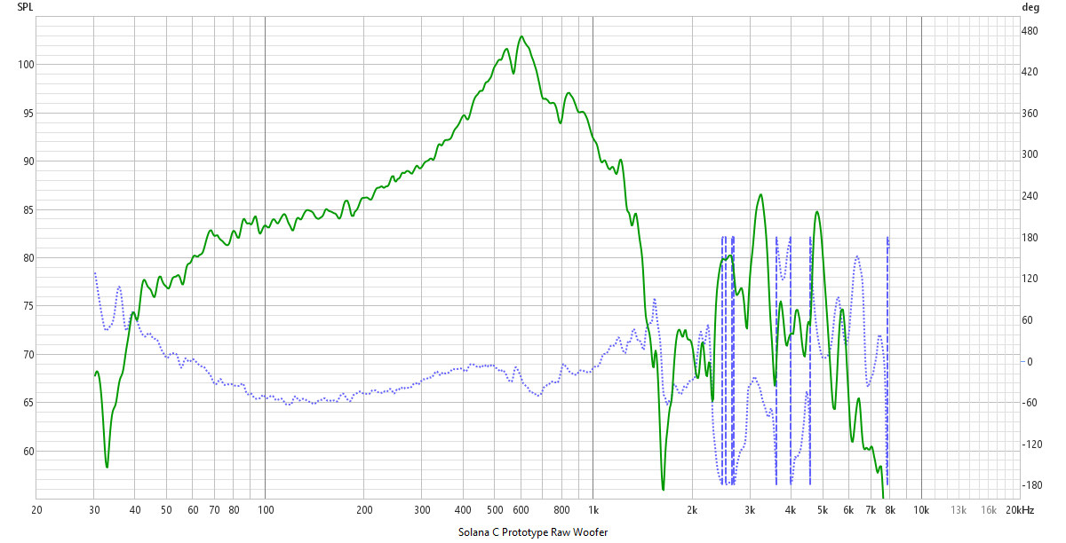

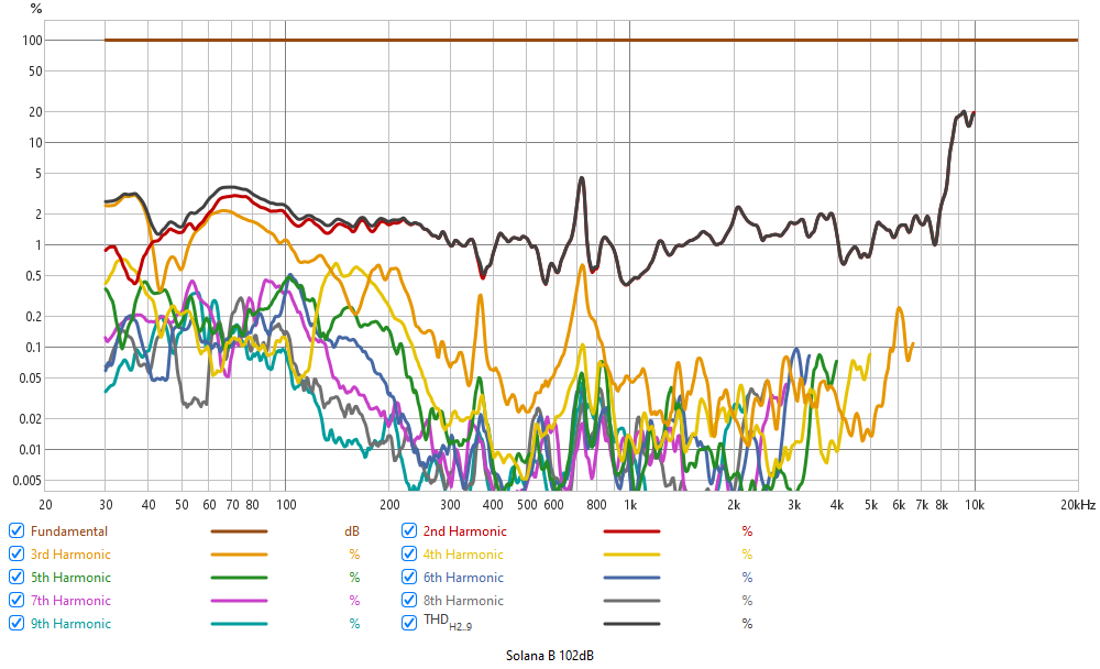

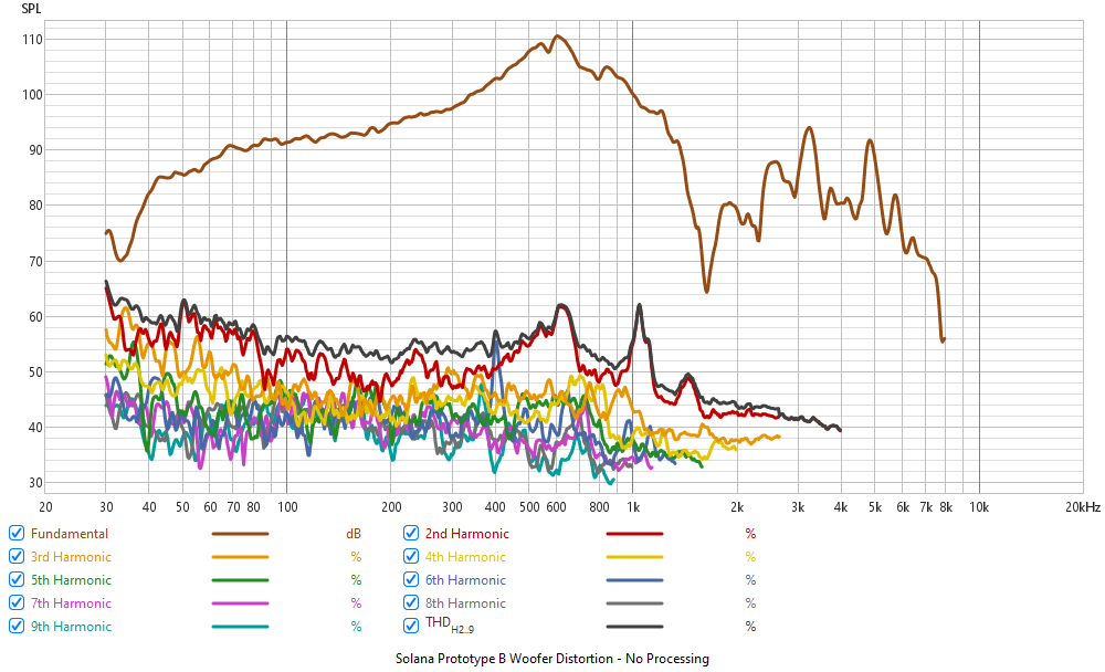

Sure - here is a comparison of harmonic distortion from only the woofers (raw response, no processing) at the same drive level between prototype A & B. I was able to see a significant reduction in H2 where it peaks around 600Hz in the new design.
Okay that is very impressive! could be interesting to find out the reason for the resonance at 700 Hz Hz, It shows in the decay and only the in the sonogram.
Its on the todo list as a priority. I have a few ideas of what it might be, but I have more measurements to make before I can make a determination there. It didn't seem to be as prominent in the first prototype, so I'm curious if something shifted or changed in the driver itself. Either way i've got more DH450s on the way, so that should be an easy one to rule out.

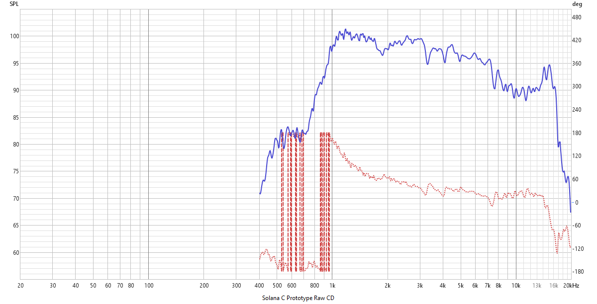

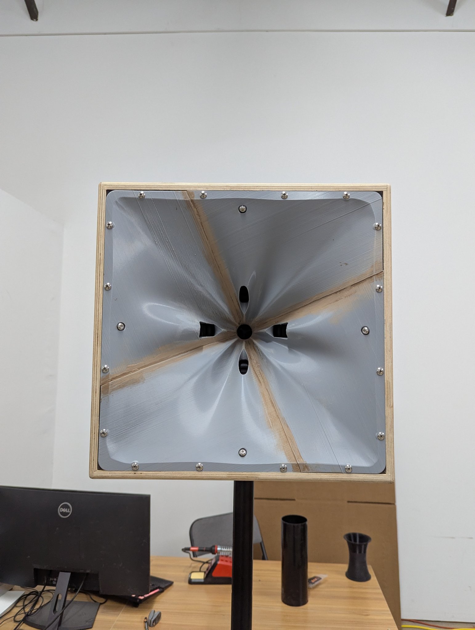

New revision with staggered ports of slightly varying distances from the throat. The shapes are a bit different too with the idea being that asymmetry will assist in "breaking up" the nulls that are happening.
Comparison below shows that the steepness of the nulls was reduced quite a bit.

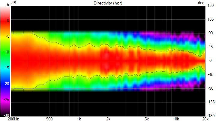

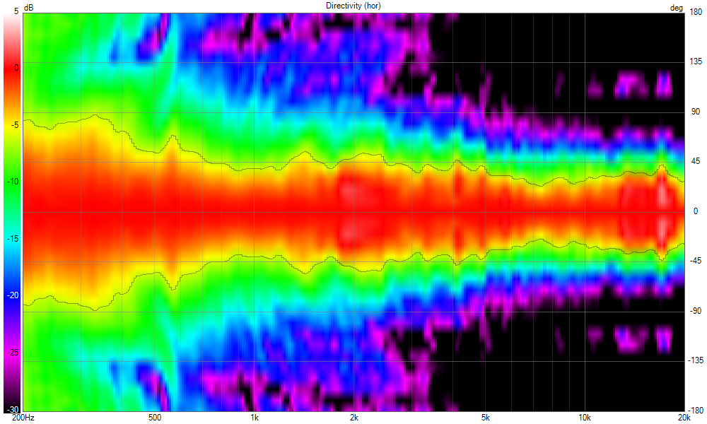

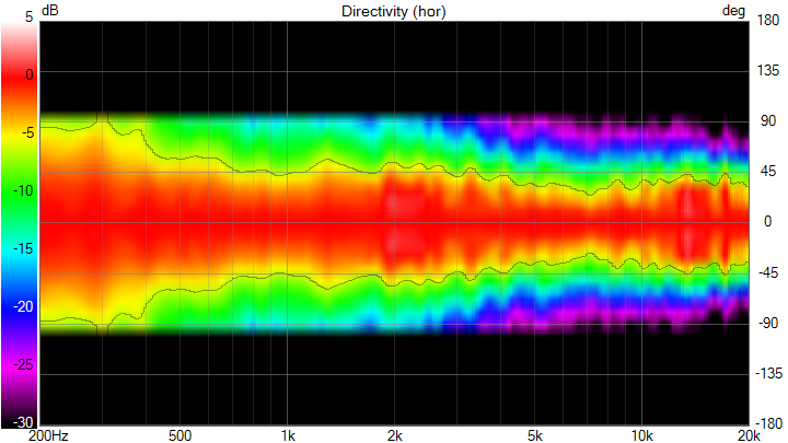

For polars, the vertical axis now has a slight narrowing happening in the top octave. Horizontal is the same as the previous prototype.
(^^^ this one is labeled horizontal I know, but its really the vertical.)

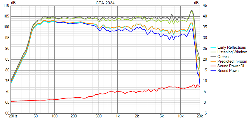

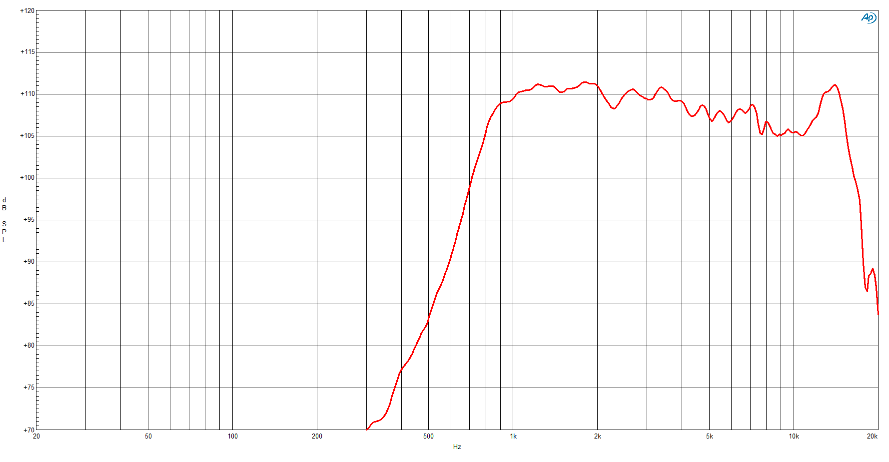

I was able to get a bit flatter on-axis frequency response now that the cancellation notches are lessened. This spin was generated only with +-90 degree measurements, so need to do a full one once I get some time to take it.

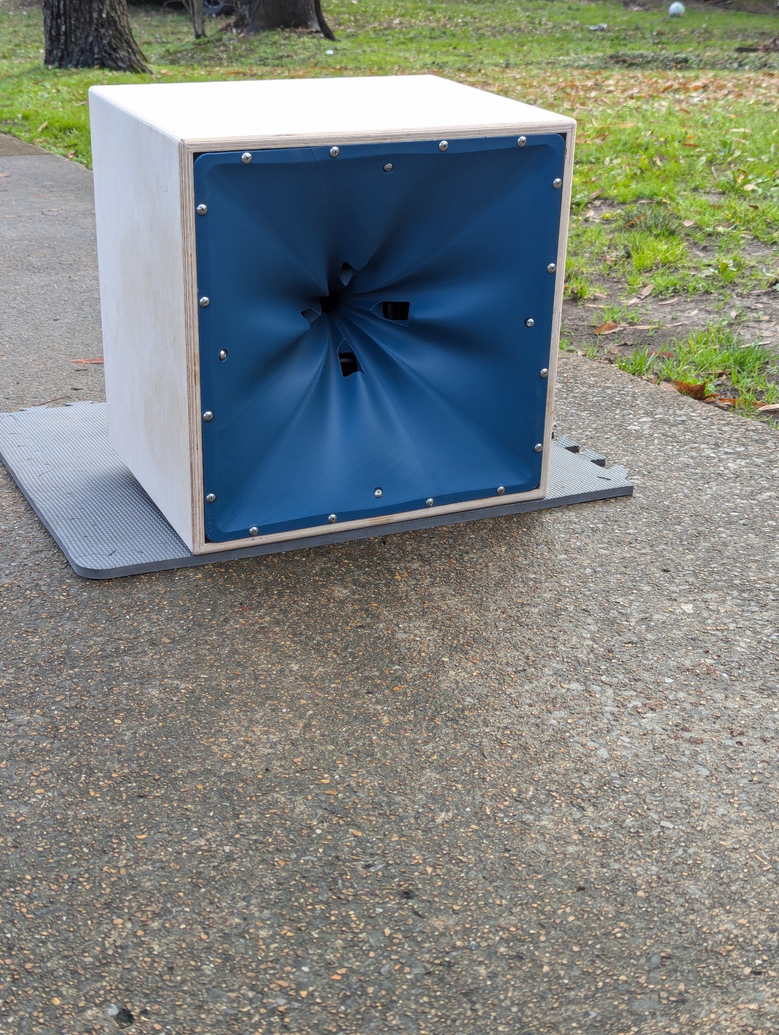

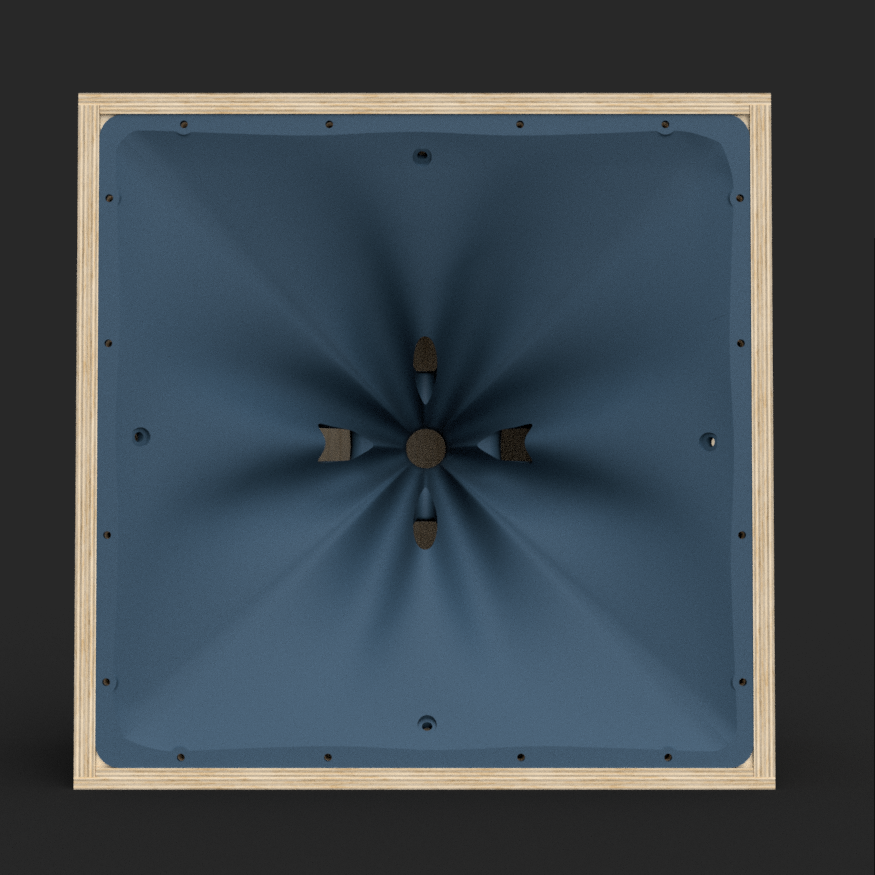

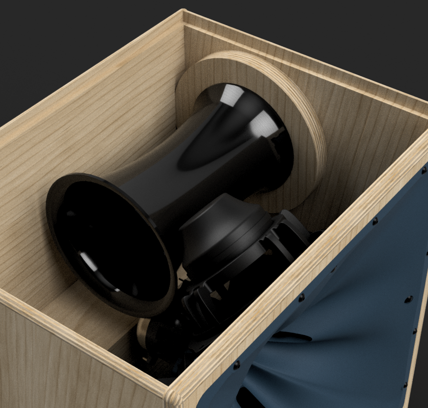

Nearing completion of this project with a final configuration render below. I used STV's port optimization spreadsheet to settle in on the below port design. The first couple of cm will be machined plywood, with the remainder of the port being 3d printed.
A summary of updates since the last post:

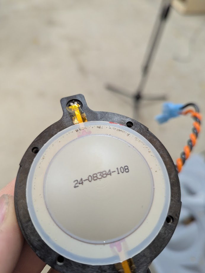

  • The distortion spike that was occurring at 700Hz turned out to be debris on the compression driver diaphragm. Cleaning this off effectively eliminated that spike.

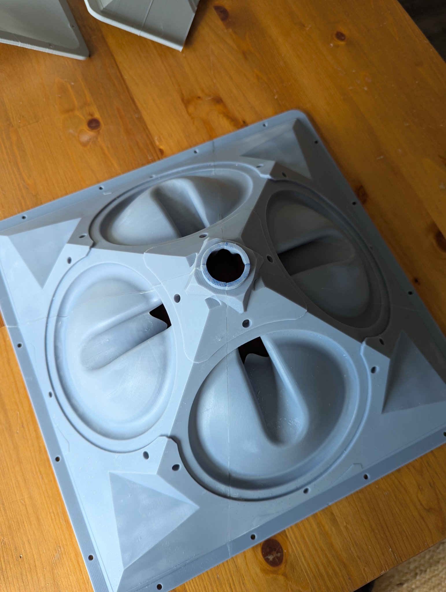

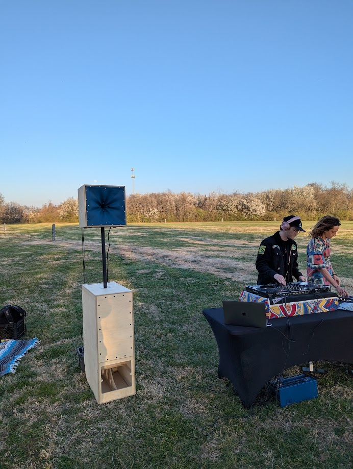

  • I've been working with a local 3d printing shop to get a high strength resin version of the waveguide made. The below is the first-pass prototype of that, but I should be getting a new one with the revised port geometry any day now. This is using Anycubic's Rigid 100 resin. I've been able to thoroughly test it in a box at several live events over the last few months and its held up remarkably well.
Once I get the final box built and validated, I'm going to clean up the files and upload .STLs for people who might be interested in printing this. Otherwise, I'll have the waveguide assemblies available for purchase in the US since its not exactly an easy print.
