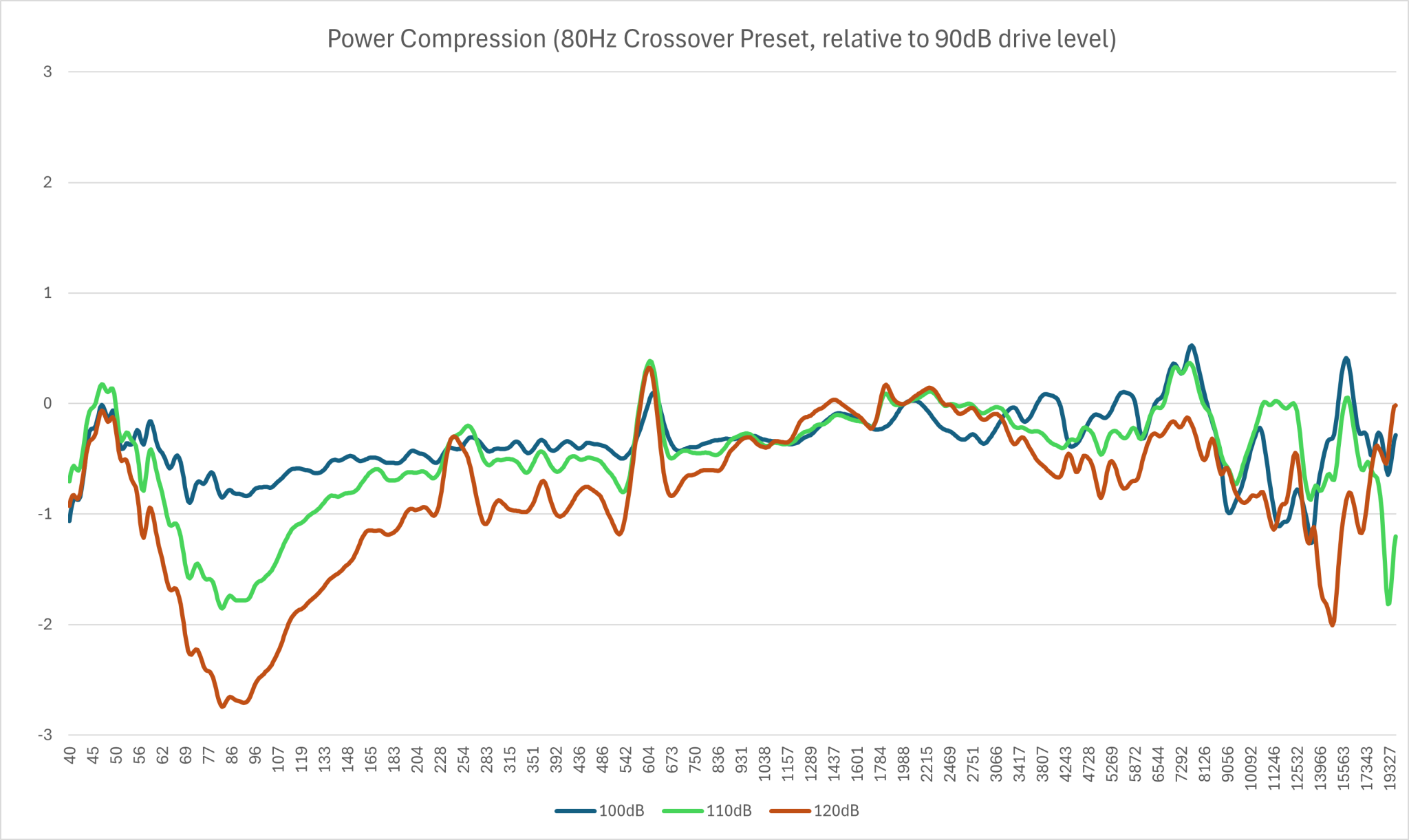

I got around to measuring power compression today with the 80Hz HPF engaged, so you can see that it remains fairly linear until you approach the maximum SPL limit. I couldn't find much in terms of guides for making these sorts of graphs, so I aligned SPL in REW @2kHz and exported to excel to make this.

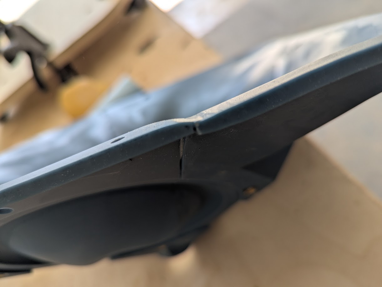

Still also experimenting with resin formulas. The Anycubic Rigid 100 resin showed initial promise as being an ultra-strong and heat resistant solution, but getting the pieces aligned for assembly proved challenging (see pic below). The ABS-Like V2 formula seems to strike a good balance between performance and ease of assembly though so that's probably what I'll stick with as the recommendation.
For FDM printing PETG/ASA seem like decent options, although I haven't tried them yet and it would definitely require an enclosure to minimize warpage. Polycarbonate or polycarbonate blend filaments would really be ideal though. Polymaker and Prusa both sell some really easy to print PC filaments that I'm going to be experimenting with. Clear/uncolored PC tends to work best as the color additives can reduce the strength of the print - especially if you use white filament as they usually add titanium dioxide which seems to make things much more brittle.
