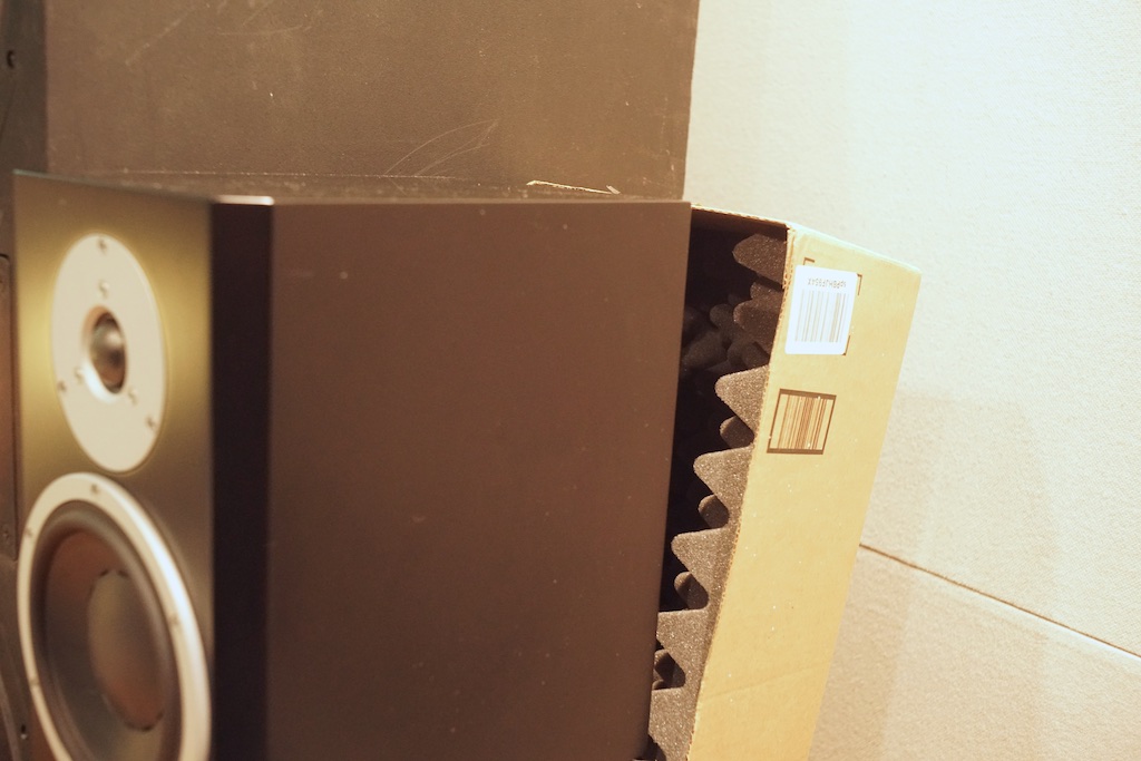

I was having the same issue with my Dynaudio speakers with rear port. I could have reduced port noise drastically just adding a back chamber made with a pair of Amazon card box filling with acoustic form without affecting frequency response. This would be a temporary solution, but it certainly works.
