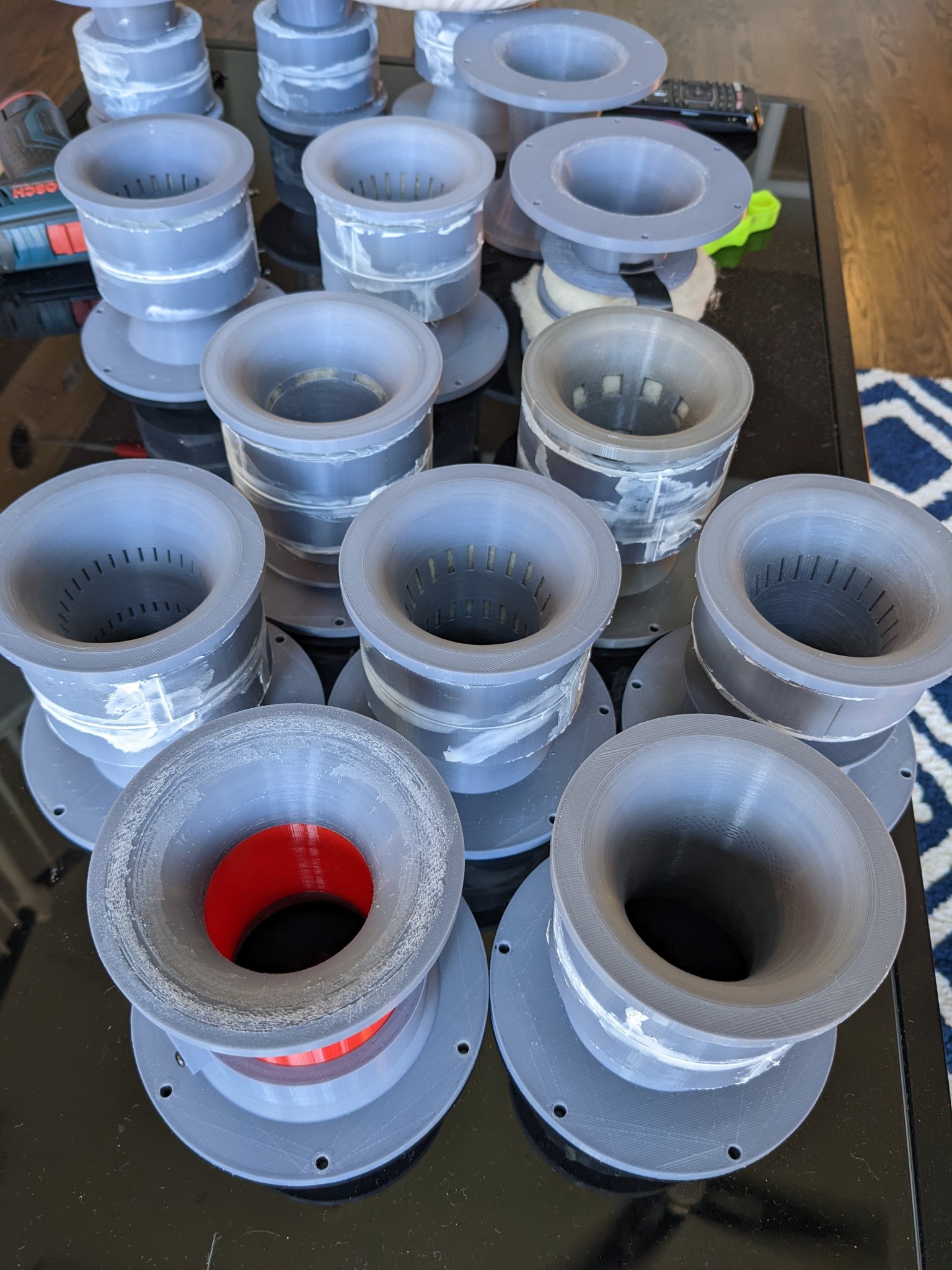

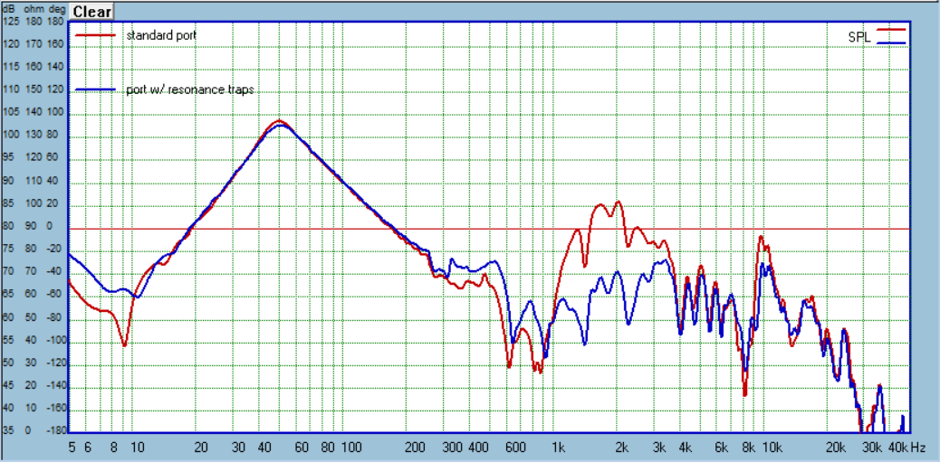

tmuikku> Thank you for the links. I've been working on designing ports that damp resonances for the last 2 years. I've got it pretty nailed, but I'd like to try the curved one you linked to, and maybe angled ends on a straight port. One thing I would recommend to anyone doing this sort of thing is to compare the harmonic distortion and spectrum plots versus an ordinary port. All of these attempts degrade performance. I suppose that should be expected. All fo my current efforts are focused on improving this non-linear performance. I also tried a normal port with the dacron batting used in MLTL, placed at the 1/2 and 1/4 wavelength positions and the results were minor resonance damping with much worse port SPL. So I don't think anything that damps in that way will work well. Below is my current best performer and a pic of some of some of the many tap designs I've tried. A few things I've learned: use a closed resonance trap, if you leave them open to the inside of the box, with just the damping material wrapped around the port, damping will be similar but distortion performance will be worse. The length of the port along the axis is very important, should be about 10% of port length. Place taps at both 1/2 and 1/4 wavelength along the port. The two together perform much better than either one alone.

Your work is quite extensive, thank you for sharing it to all!
That is very good performance on the mid "noise", what, +30db below the Helmholz resonance? nice!
Very good stuff for many projects, for those who want or need to go extra mile. Very high tech which comes handy when every bit of performance needs to be taken from small size for example.
I'm sticking with simple closed or open structure for short wavelengths and leave ports for subs for now on. These problems are nicely circumvent when the box, woofer, port all are acoustically small so that possible issues just disappear, only schuffing and compression is left. Perhaps closed subs as well, enough juice for home use, and no problems with simplest construct and lowest tech 🙂
