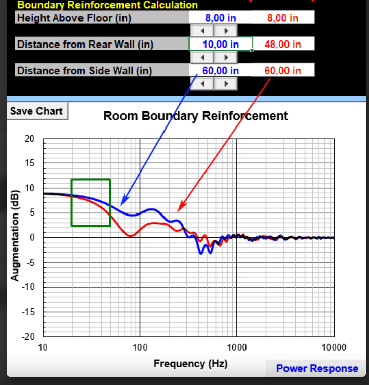

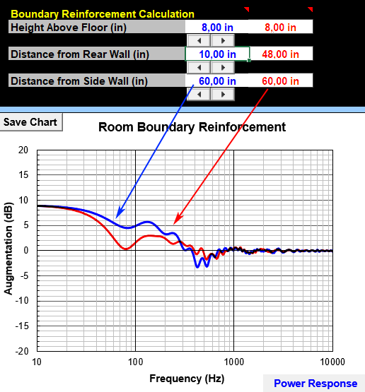

sorry, one more correction (and edit time over): the distance to the back wall is of course calculated from the driver (front of the box), not the back of the box. therefore comparison between 10 and 48 inches distance from back wall.
also note colours have changed!

Yeah, not big of a difference for typical tuning frequencies even with very large box where changing port location from front to back for example, would result tens of inches change in location relative to room boundaries. The lower the tuning frequency and smaller the box, less of a difference in this regard where the port is located, given that the speaker location stays the same.
Here in your example, if we thought the graphs shows port output (at listening position) while speaker stays at same position, 32" difference would translate 32" deep box, ~80cm, and swapping port from front to back results such difference, few decibels. There is difference, but the speaker is very big. Could you try for example 15" difference, how much that makes? This would be already quite a big speaker.
