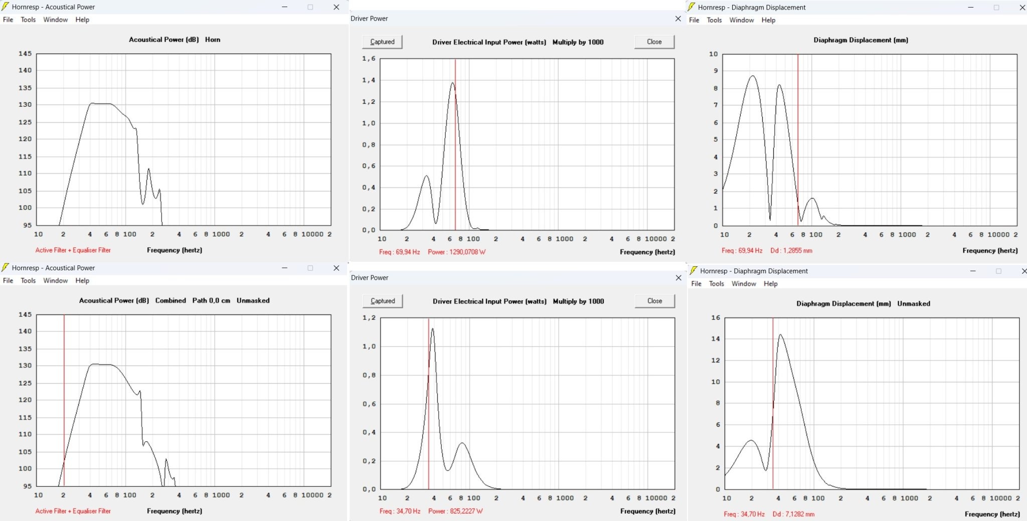

Here is the TH comparison in Hornresp, after we EQ it out for usable response, and add thermal compression.
Top row is the TH, bottom row is BR:
The bassreflex power scales well with excursion. At 34.7Hz, quite weak point, the power is 825Watts and 7mm of cone excursion.
With TH, we have 1290Watts at 70Hz and 1,2mm of excursion, and it arguably gets worse upper in the range.
Now, let´s ignore that, and imagine that with dynamic music, the driver will not burn. It is perfectly reasonable in many cases.
Now, who believes we can add 6dB of input power and have clean 6dB of ouput SPL with no losses to match two of these ported bins.

Your charts show the TH has an easy +6dB more output left in the 40Hz range, using well under half the excursion and power of the BR.With TH, we have 1290Watts at 70Hz and 1,2mm of excursion, and it arguably gets worse upper in the range.
While the single TH would keep up in the lower frequency range, two BR would have more output potential above.
That said, the TH is undersized 😉

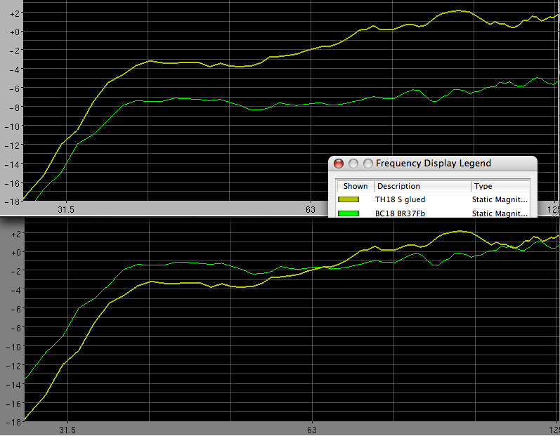

True, if you want to compare real world performance, the Fb should be matched, as I did when comparing the 18SW115-4 in a TH to a "full sized" BR.The TH might be undersized, so is the ported bin. Then we would be comparing these LF21N551s in 130l bins instead. Also, if you can ignore anything, so can I, to tune the ported box to 40Hz, and now I am within its cone excursion limits too, and can add imaginary decibels too. This leads nowhere if we have no standards here.
And actual, rather than simulated excursions should be measured, as Hornresp assumes both Bl and suspension to be linear, while they obviously are not.
https://www.diyaudio.com/community/threads/tapped-horn-vs-bass-reflex-case-study.184992/
In that comparison, a pair of BR have a low frequency advantage over the TH, while the single TH has a similar upper advantage.
Of interest, at high drive level, the BR lost LF output due to "port compression" relative to upper level. The TH didn't suffer from any "port compression", but had more upper pass-band "power compression" than the BR, effectively making the response more similar.
Anyway, for those that can afford double the drivers and amplifiers, the BR are a better choice.

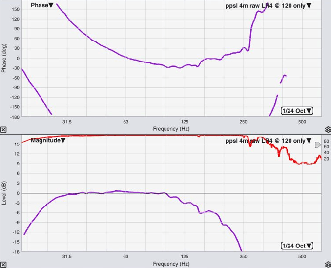

Yep again, I almost always go for the most BL^2/Re i can get....even for lows and mids....
Also however, I do my best to let the box do the heavy lifting...not the DSP. (I am not a fan of low end EQ boost.)
Here's my latest big reflex, measured raw on driveway, with no DSP other than a LR24 low-pass @ 120Hz.
The low-end belong to the box 🙂 (it is a big sucker though.....see my "V-Twin" thread
NOICE. Well "most Bl^2/Re one can get does not get that easily flat. What setup do you have there? I mean, speaker too.
I also would be curious about this. Yes, we can fix the frequency response, but we can't modify the impedance response with DSP and different box sizes results different impedance responses. I don't know this latter is the reason of the wrongness (is it wrong at all?) of a strong motor in a large box.Now, flat extension is a spicy topic. Once we have DSP at hand, that can straighten it all out, then what´s the problem.

A larger box leads to a higher electrical impedance response in general (but the higher frequency impedance peak goes lower in the spectrum), the valley caused by the port tuning becomes narrower. I don't see why this could be wrong.
On the contrary, the woofer in the larger box needs less electrical power for the same bass SPL than in a smaller box, this is always good IMO.
To date, the arguments are:
1) Frequency response plot that is not flat anymore. Relevant for some, irrelevant for some.
2) Low efficiency (debunked).
3) Excessive power after EQ (debunked).
4) Underutilisation of the driver. That is true, but who drives his car at full speed all the time in order for the motor to be fully utilised?
After all, it is hypothetical. If we take a real driver, we find out that some questions disapper for irrelevance for different reasons. For example if we take B&C 18DS115, we find out that the suspension is stiff and additional efficiency is almost as good as gone.
