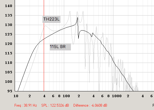

Cutting at or above port tuning is routine in PA - hardly unconventional.
Undersized volume and low tuning always result in lower SPL in the low frequency band - matter of design compromise. Pick your poison.
Are you sure that drivers in SB1001 are in undersized volume?
Well, that one is actually new to me.
Never seen it, never heard of it, almost everybody says to me it's wrong to design it like that.
With you/SB1001 I am not so sure about anything anymore. You are somewhat disproving my beliefs of standard practise in PA. That's why worldly forums are very useful. On the small local ponds it is just a local echo chamber. Not many different ideas.

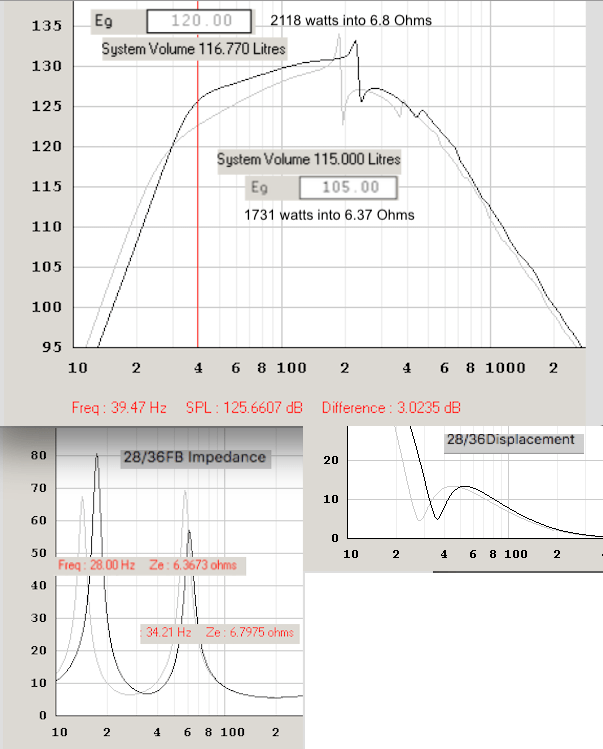

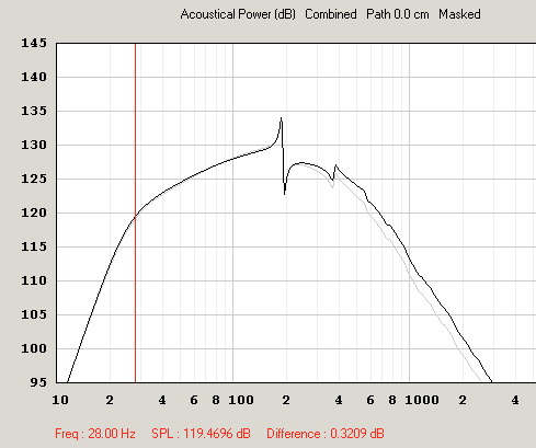

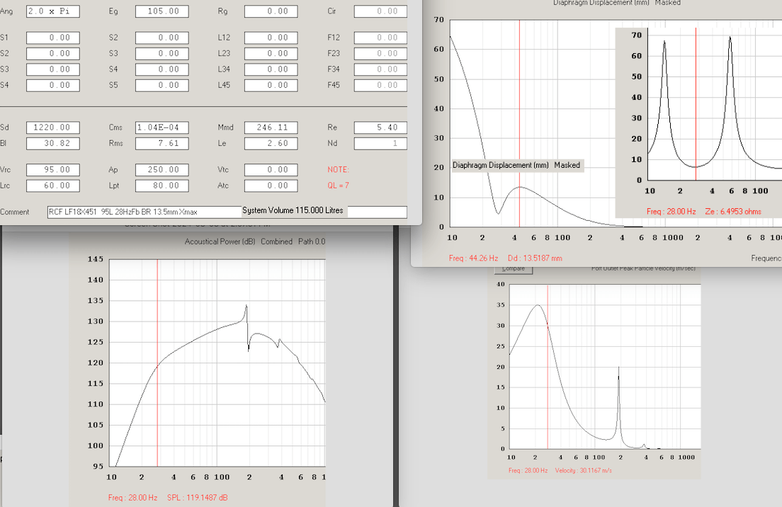

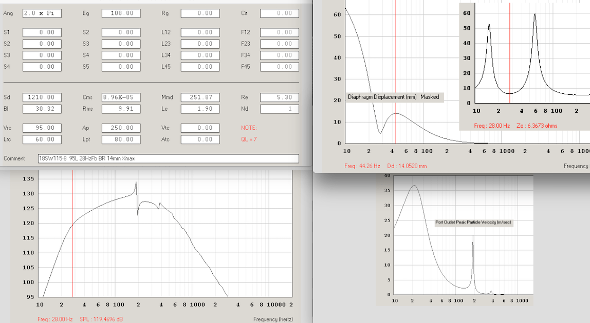

I still don't get it. Could you please share with us your design - box volume and tuning frequency?Now reaching Xmax in vented enclosure with LF18X451 is not exactly wrong, or out of control. This is very on purpose, as the available speaker displacement volume is utilised on purpose to the fullest here. Very on purpose. Lower port tuning allows for it.
Driver: RCF LF18X451
Box: ported, 95l/3.55 cu.ft net volume without port.
Tuning: 28Hz.
Preset: HPF 35Hz Butt18db/oct, LPF 85Hz butt 18db/oct, PEQ1: 38Hz +2dB steep (Q3), PEQ2: 66Hz -2dB, wide (Q1).
In hornresp, this shows me 14mm of cone excursion at 120Volts (1800Watts). I have a suspicion that the excursion will be little less, but not by much.
The higher tuned design could dish out more SPL above 45Hz, but for high price of power compression below 45Hz, making it not flat sounding design. The F3 would go way higher than 34-35Hz.

95 l is oversized, not undersized enclosure volume for RCF LF18X451! Nothing wrong with that, but you are constantly talking about undersized volume!?
All conventional alignment for LF18X451 call for volume smaller than 95 l:
- SBB4: 70.6 l
- SQB4: 61.1 l
- SC4: 64.4 l

As Sonce said, the B&C18SW115 is almost identical in response to the RCF LF18X451.For example B&C speakers spend A LOT power at their Xmax/Xvar value, and are not that happy to work there all the time. Most of these are out of question. RCF, 18Sound NTLW, Faital Pro, these have not such issues...
not sure about 18SW115.
It does require slightly more voltage to hit it's Xmax of 14mm compared to the RCF Xmax of 13.5mm.
Your HP filter puts electrical response -3dB at 35Hz, so basically your cabinet low corner after EQ is around flat to 40Hz.Driver: RCF LF18X451
Tuning: 28Hz.
I'm not following your power compression theory, raising the Fb from 28 to 36Hz in the same size cabinet increases output by +3dB at 40Hz and reduces excursion.
Using the HPF 35Hz BW18 filter, the higher tuning would require less low end boost to reach flat response, and the higher sensitivity would reduce power compression.
Just for fun, did a comparison of the RCF LF18X451 in a tapped horn of double the size of the 28Hz FB. it has +6dB output at ~40Hz.
It would put out the similar LF as two of the BR cabinets using half the power and drivers.
