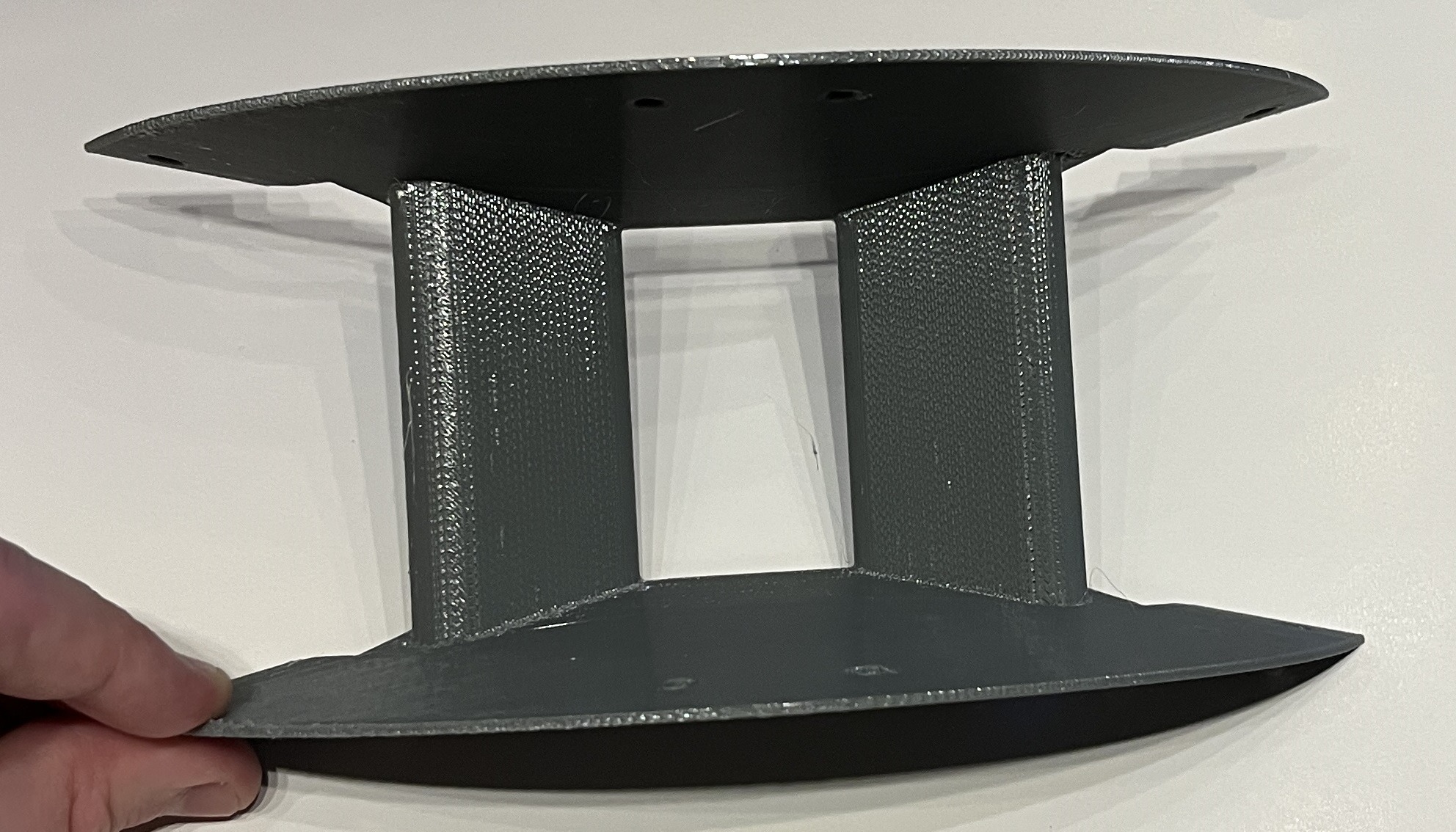

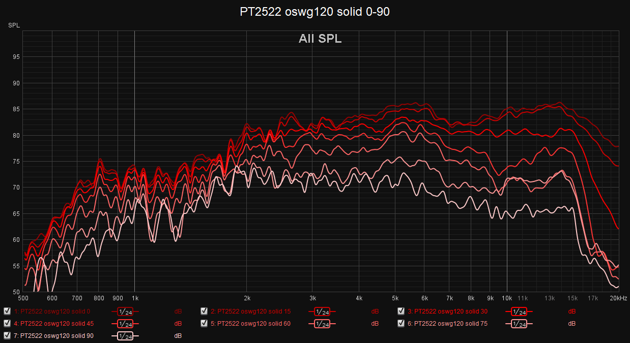

Ignore that some measurements start at 1 khz and are at 10 dB higher. I had some background noise when measuring so I bumped the amplitude to counterract.

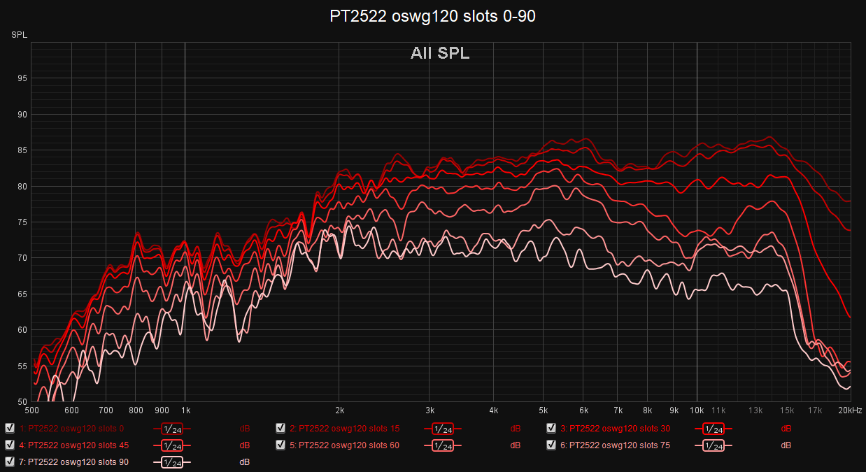

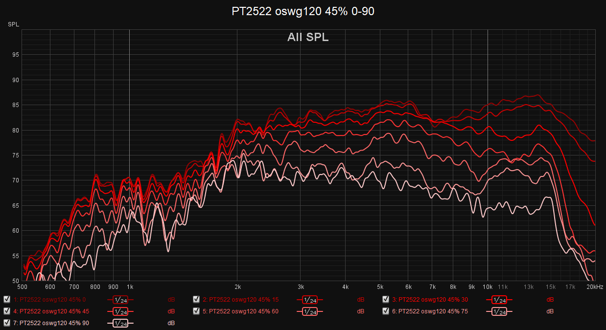

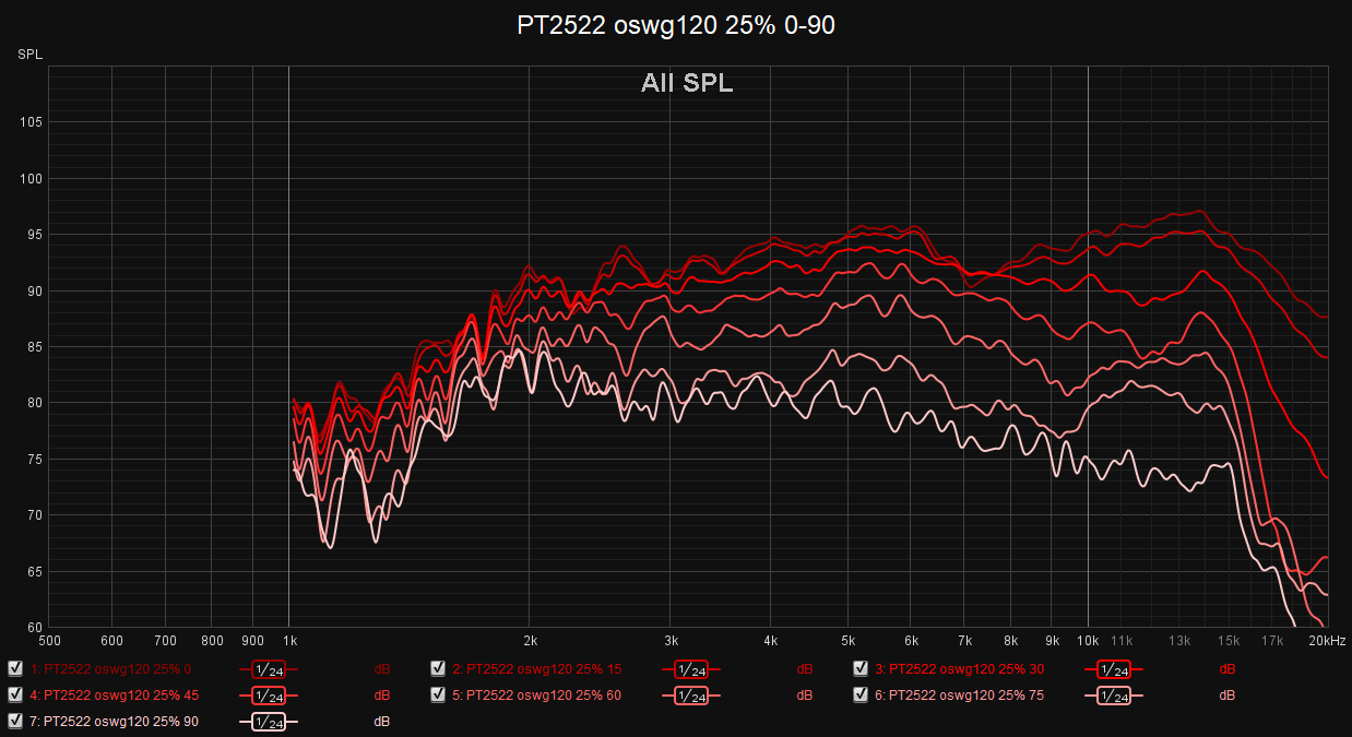

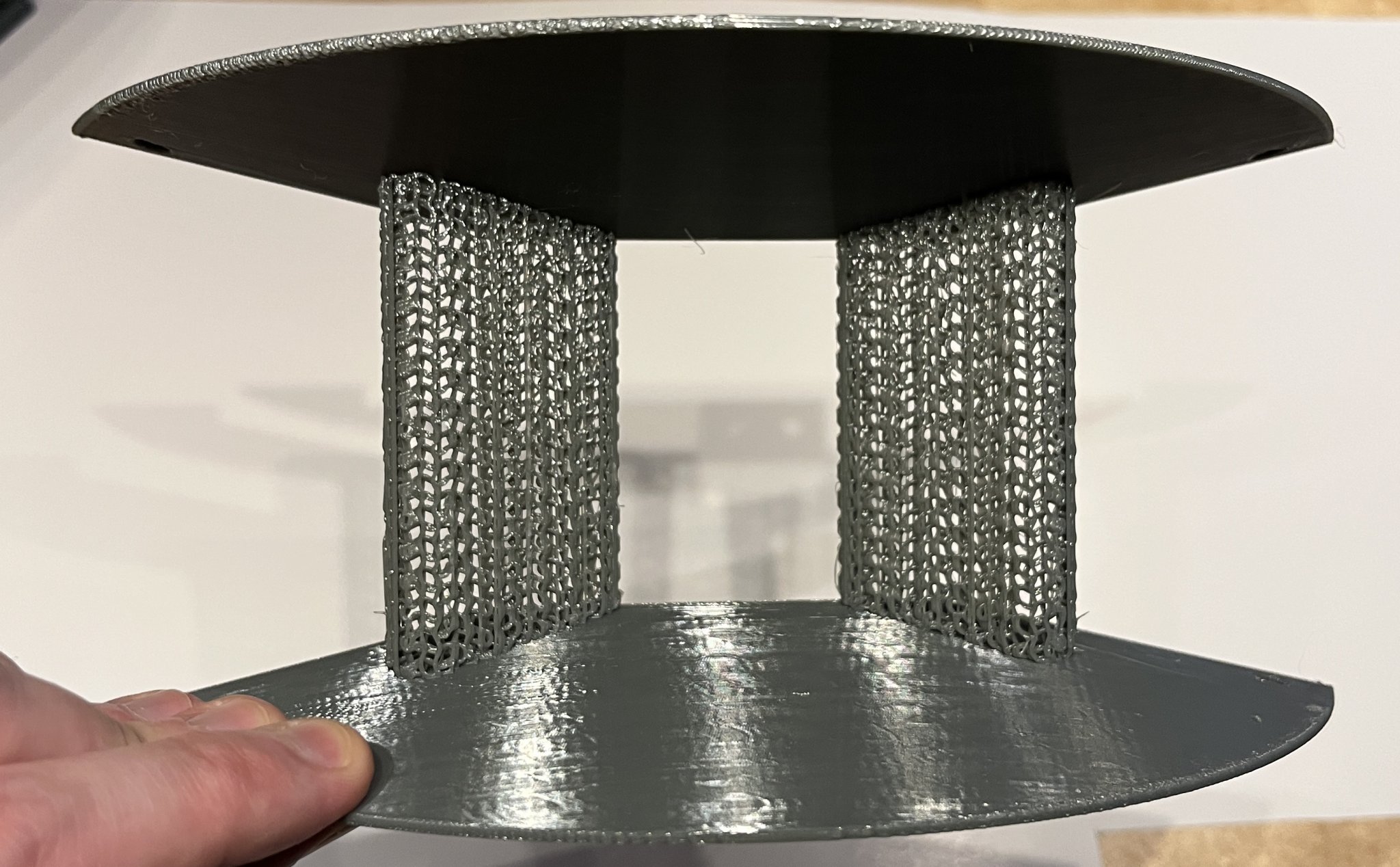

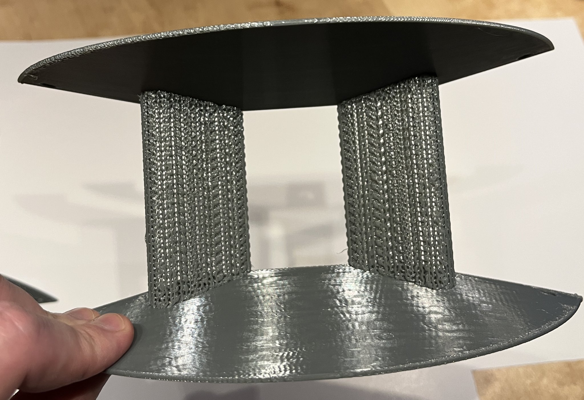

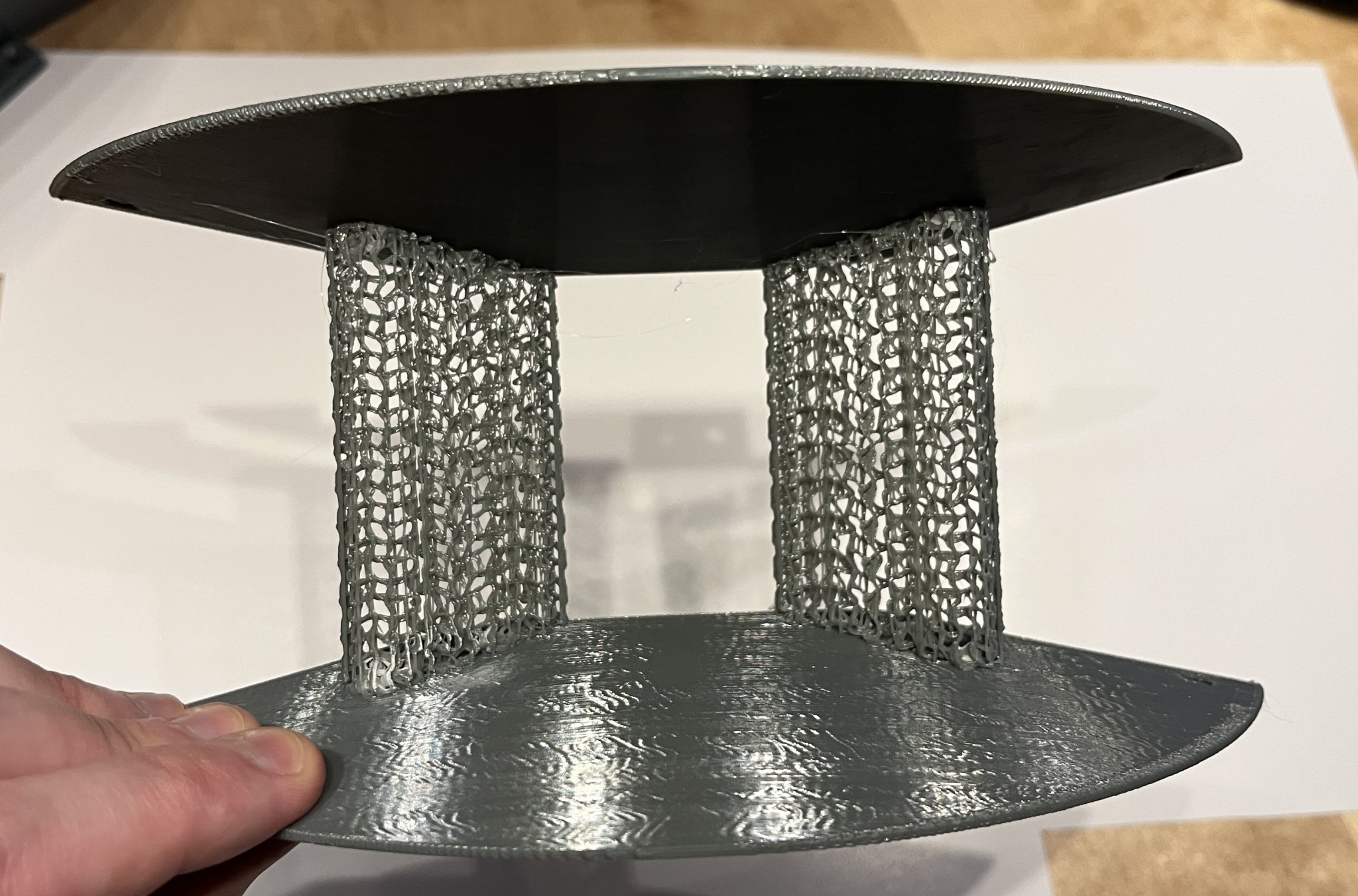

I wanted to find out which setup is better: slots at the edges or an actual porous waveguide! I made the porosity by printing with gyroid infill without any walls or top / bottom. the % is the infill percent. I used a 0.6mm nozzle when printing.
I believe the 2 notches between 2-3 khz are because of the vertical waveguide since it is also present on the measurement with only the mid flange. These notches should disappear when I connect multiple drivers in the CBT array and not just a single one.
Interesting that infill 25% and 45% measures almost identically.
Turns out it works, but slots are better so that is probably what I will use.

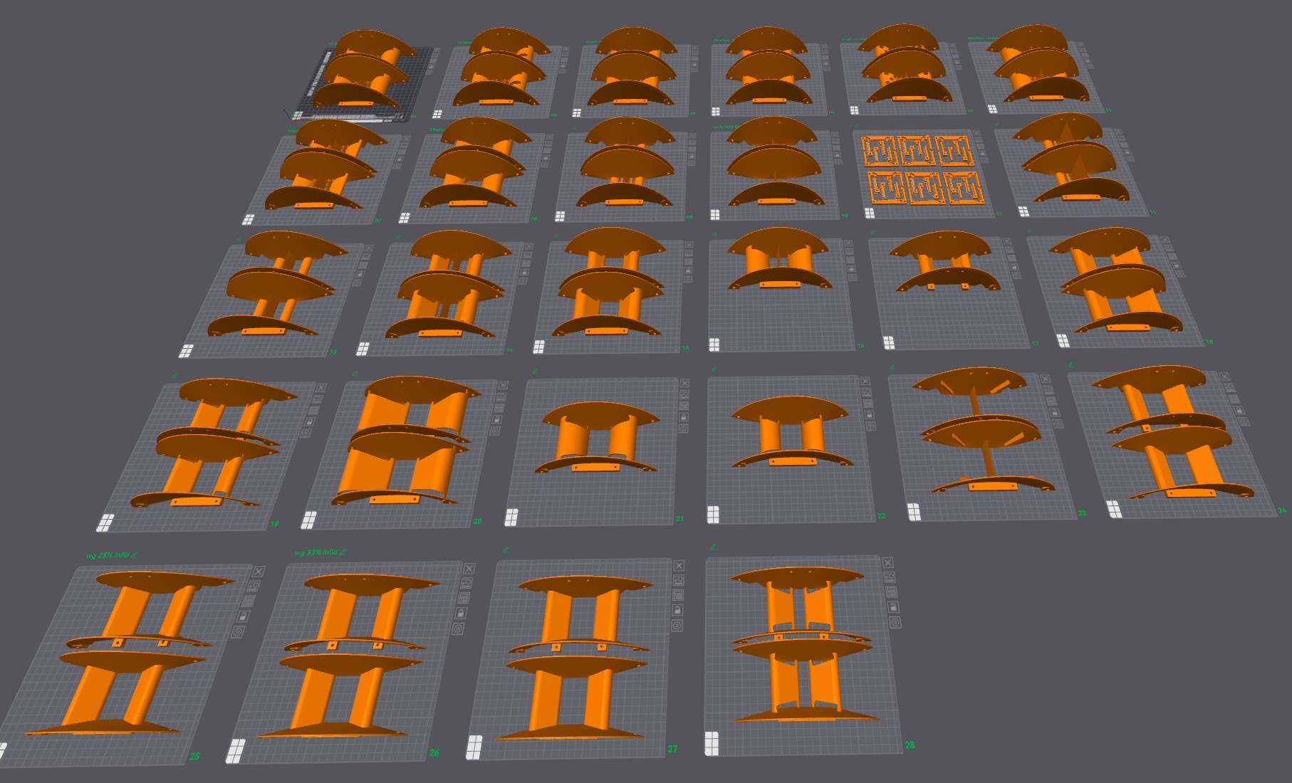

Here are the ones I have saved in a 3mf format that can be exported to stl. All have the vertical waveguide. If desired I should be able to generate waveguides without the vertical wg.
https://drive.google.com/file/d/1uc5YkzhcOqfLAXPHo2flqDKzgPjgEoX-/view?usp=sharing should give you access to the above mentioned 3mf which contains most of the waveguides.
If you want a configuration not in the file then I should be able to re-render the desired waveguide by loading the appropriate version of the code.

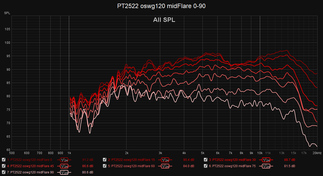

For my use case, which is minimal baffle, the best compromise was a small 90 degree oswg with slots open on the front and mini roundings + a mid flare on the rear:
https://www.diyaudio.com/community/threads/porous-dipole-waveguide-experiments.402258/post-7447415
https://www.diyaudio.com/community/threads/porous-dipole-waveguide-experiments.402258/post-7447420

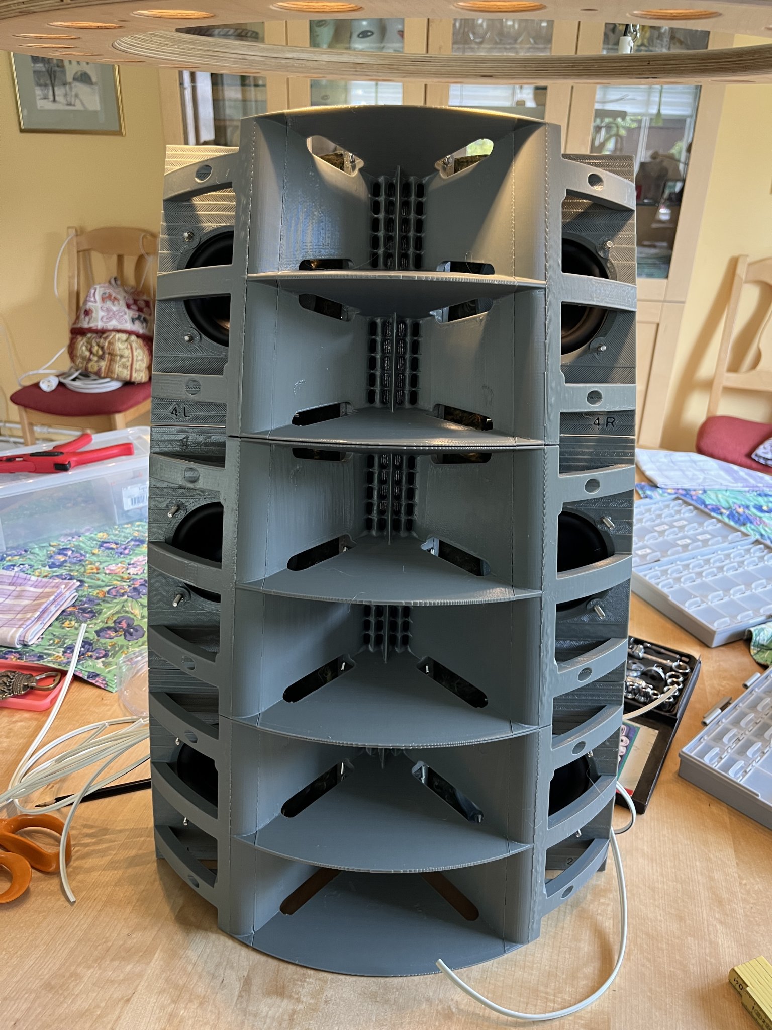

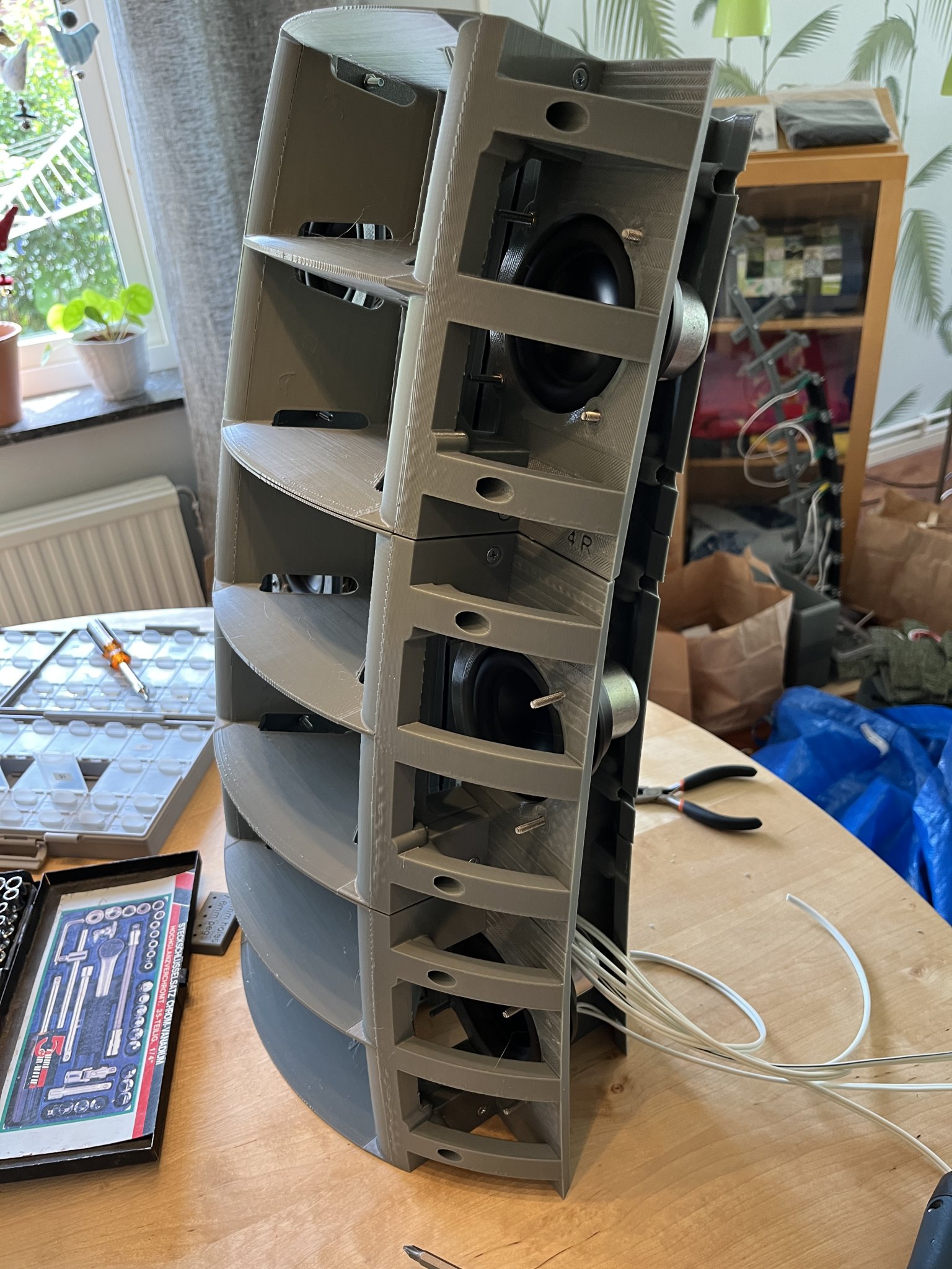

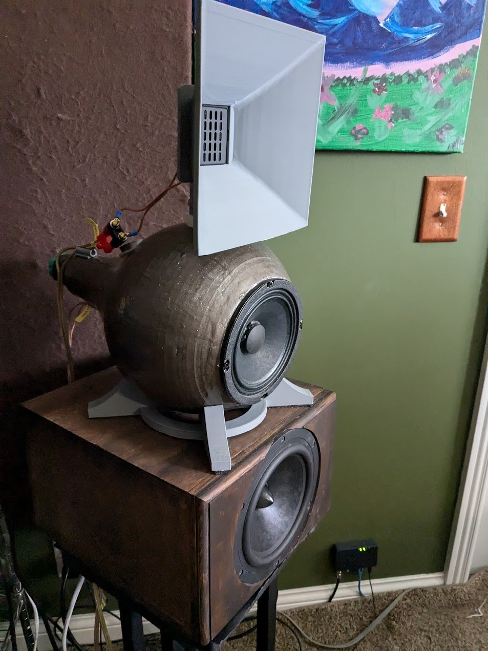

No, only my dipole inspired variant which isn't really a horn:
The midranges are 3.5" ND91 and the tweeters are PT2522s.
Inspired by the idea of a synergy horn by placing the midranges around the tweeters and letting the merge into each other by having the slots. The slots also help reducing the dipole peak since it allows some pass through.

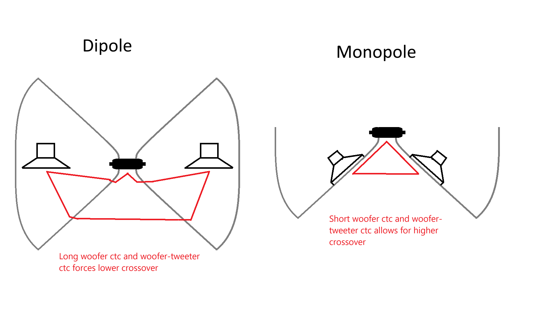

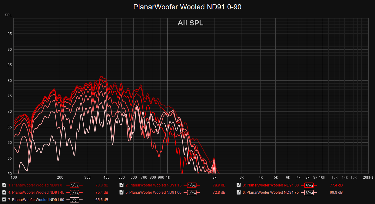

Woofers response:

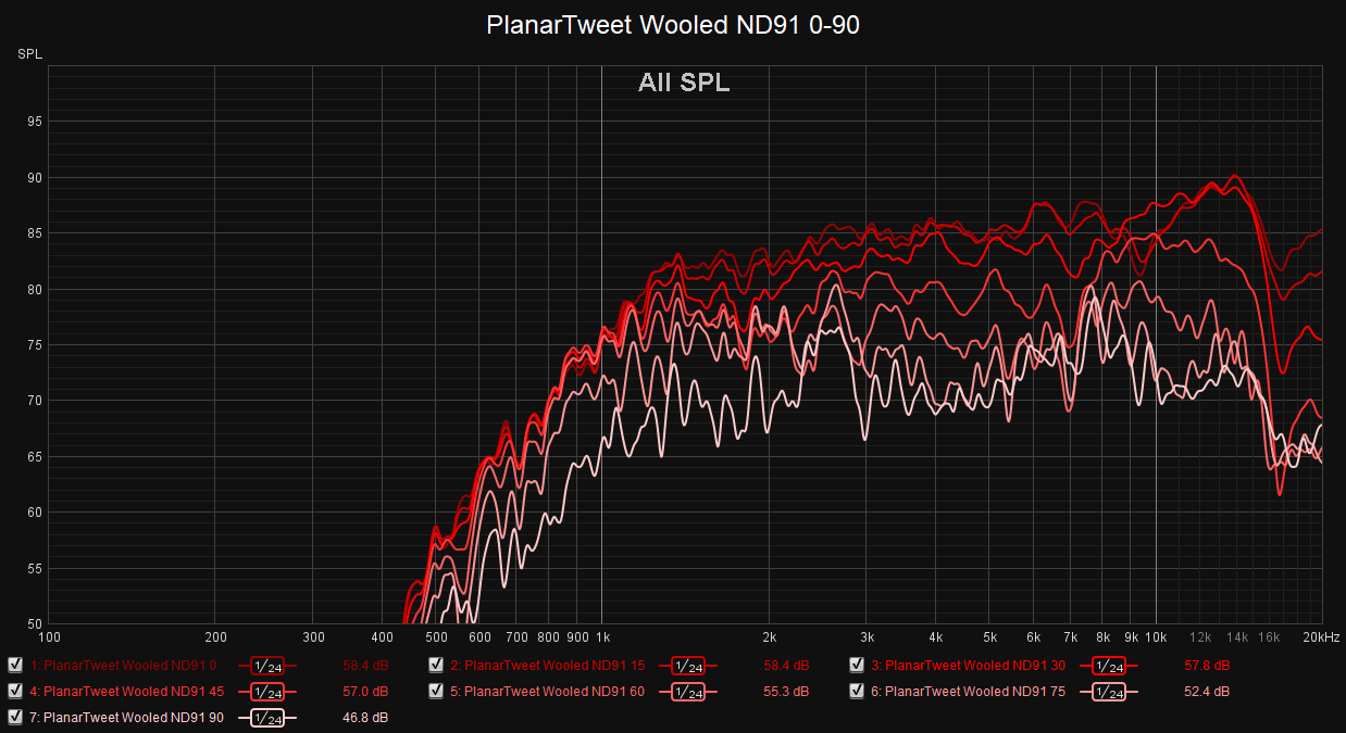

Tweeters response:
In this dipole setup it doesn't work because the tweeter doesn't play low enough. If the tweeters could be crossed at 400-600 hz then it would work great but the PT2522 can't.
In a monopole setup you can do tricks, however, to increase how high the woofers can play. You can shift the woofers into the waveguide side. In a synergy they usually have elongated slots or round holes to let the midrange sound through while still acting as a mostly flat surface to the tweeter. You could also use infill like I played around with in https://www.diyaudio.com/community/threads/porous-dipole-waveguide-experiments.402258/post-7480408 instead of slots or holes. And since the ctc distances can be made way shorter for the monopole setup this allows for a far higher crossover frequency.
