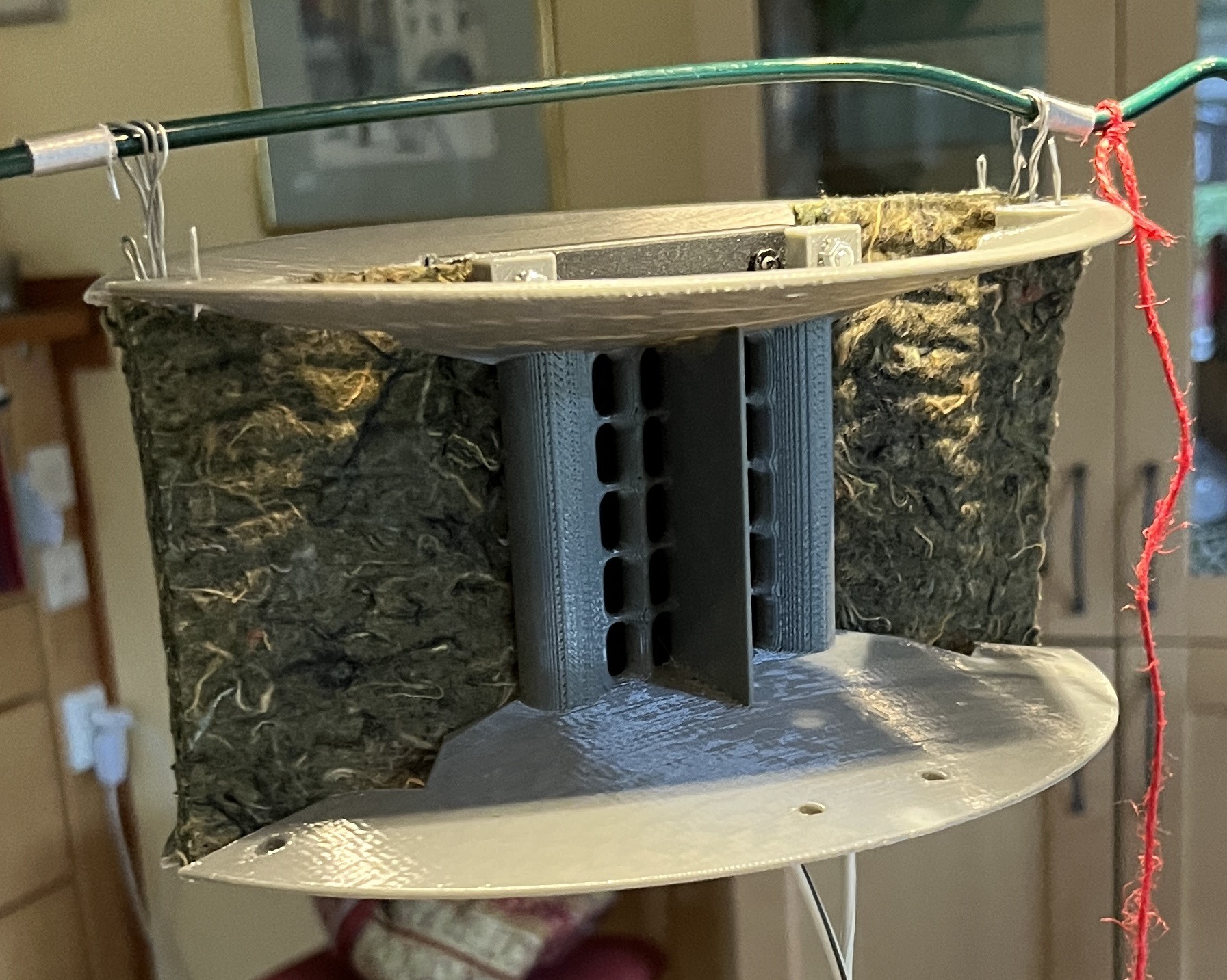

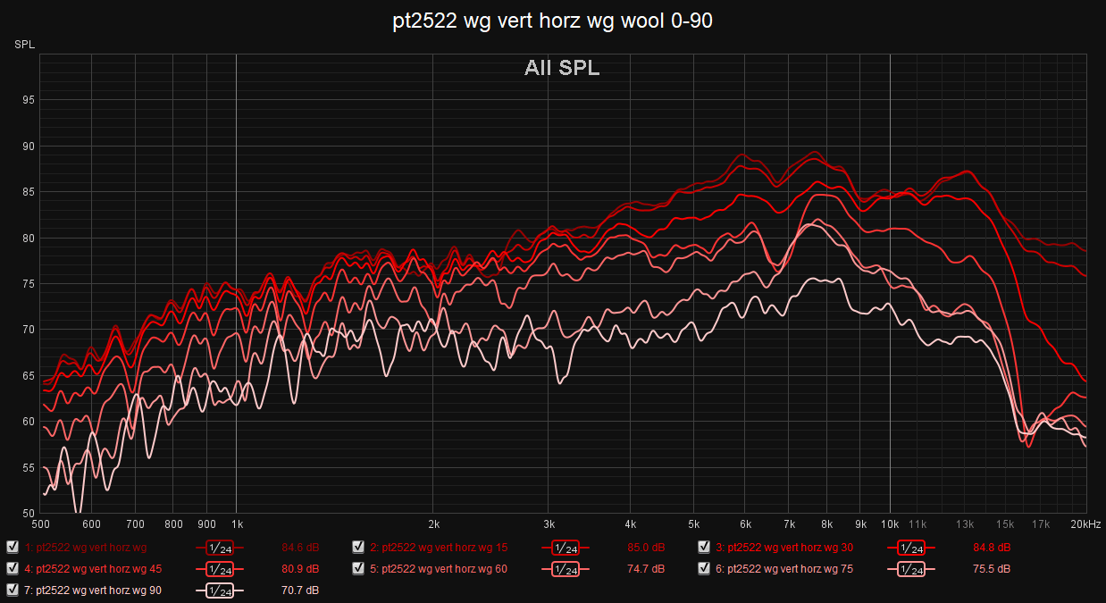

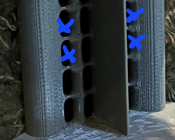

Only I have tried so far is the measurements in the main post and I have tried to add some wool carpet in between the sides as in the image but with the horizontal wg. It has previously shown good results but here it measured worse than no wool in both the naked and the horizontal wg configuration.

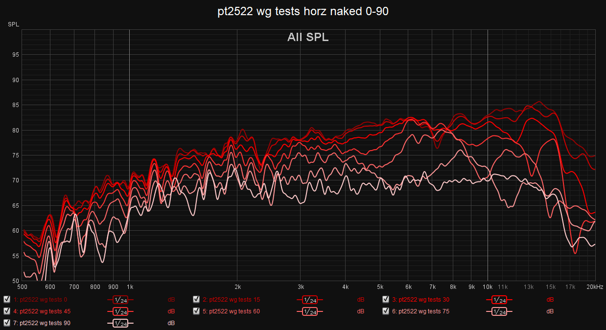

I'll have to wait until next weekend until I get access to my measurmenet equipment so I'll have to print some different configs until then:
An observation I found is that that the waveguide seems to control directivity more narrowly than a dipole so I want to test a more shallow waveguide and see if the integration is better. The original wg was 2.5 cm deep, I want to try 1.75 cm depth.
I also want to see if adding more slots would reduce the impact on the lower frequency range.
And when we are at it why not test a cheese configuration instead of slots? 🧀
And test to extend the sides by increasing edge roundover. To make it easier to print there will still be a 1cm gap so I'll have to fill it in with tape and some foamcore board when I measure.

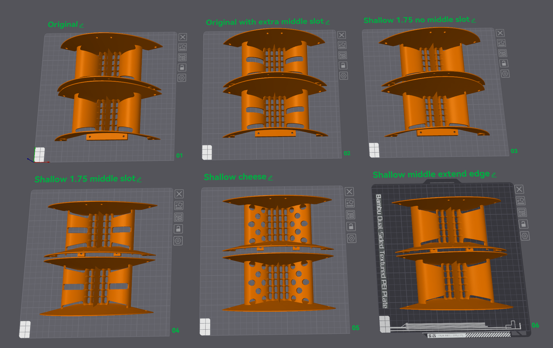

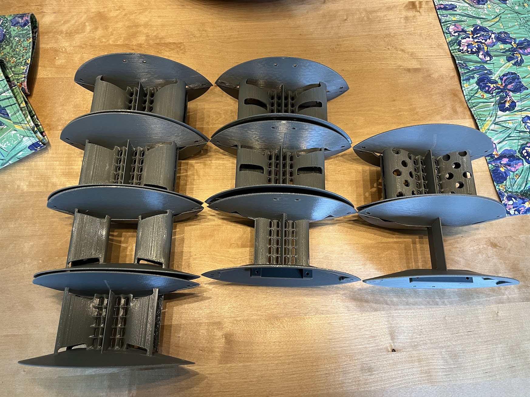

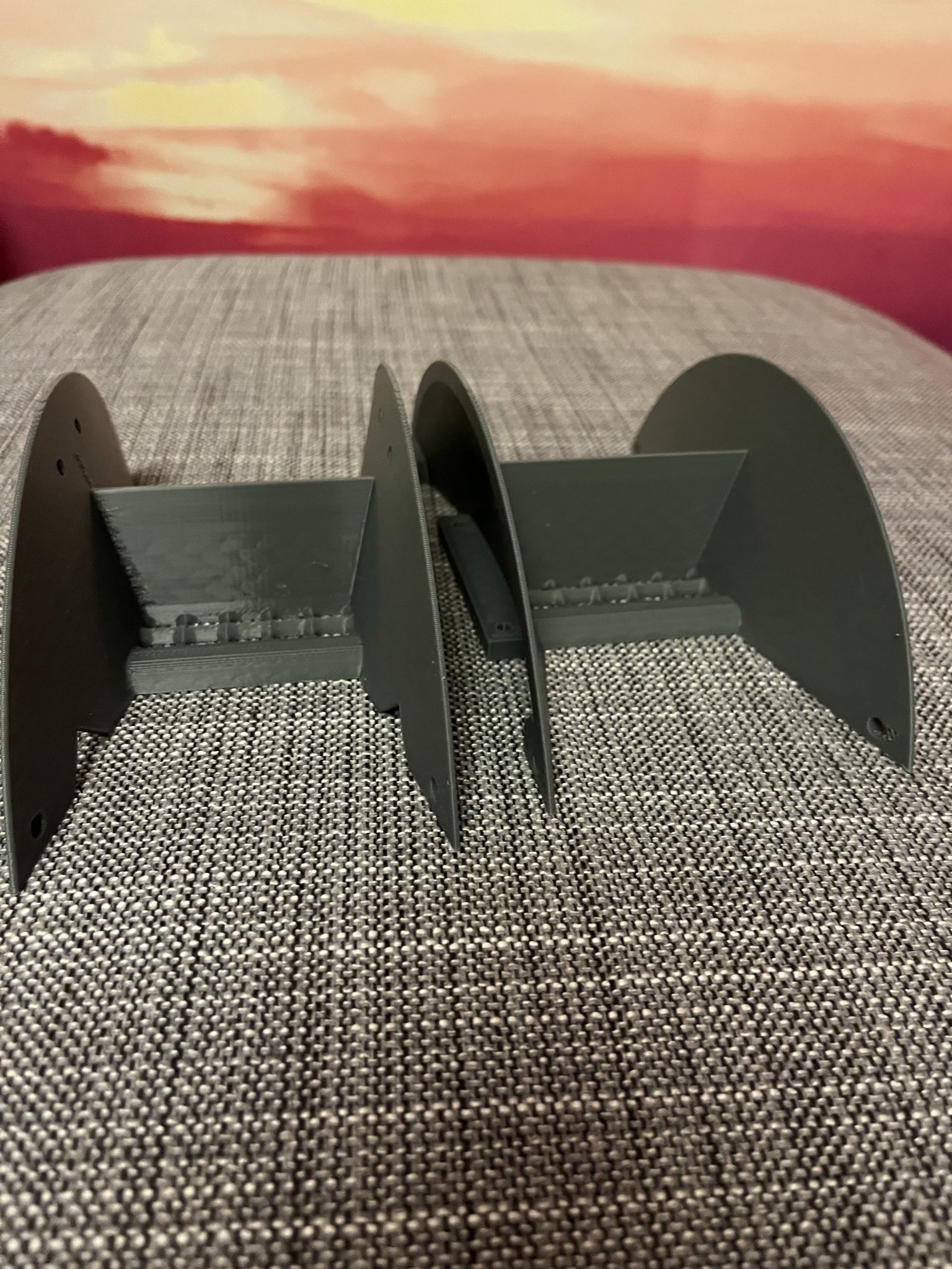

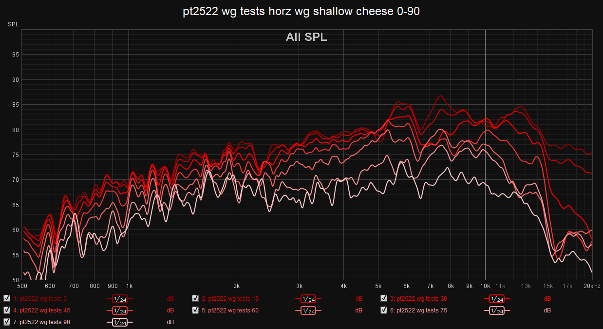

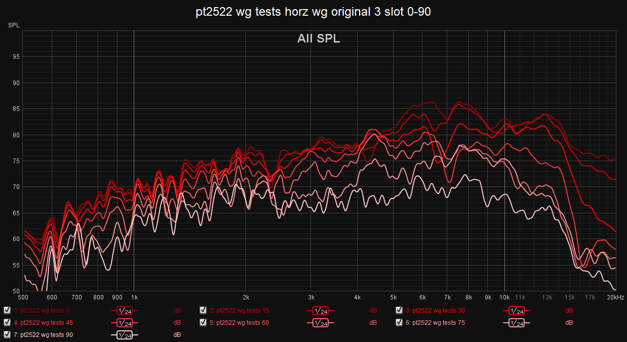

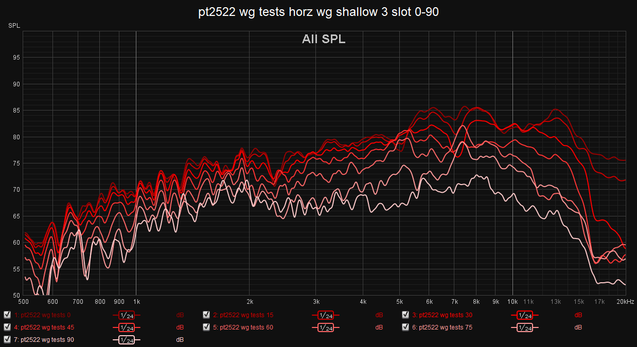

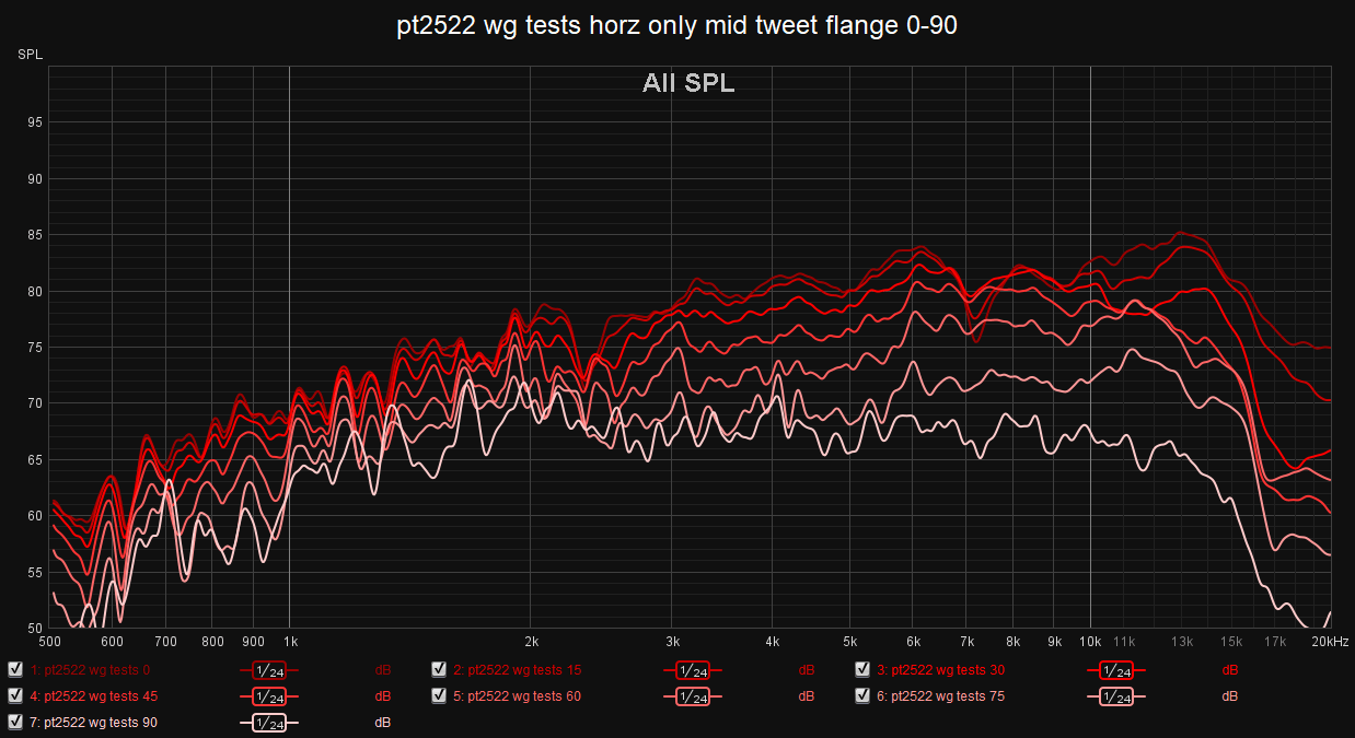

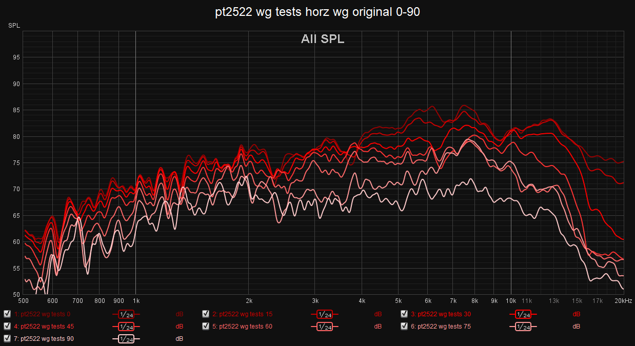

I have:
Empty with no wg or any horizontal wg stuff at all then the ones in the image:
Original = the original wg. 9.5 cm wide excluding edge roundover, 6cm deep and 1.5 cm edge roundover.
Shallow = 9.5 cm wide excluding roundover, 4.5 cm deep, 1.5 cm edge roundover.
Row 1: original, original with 3 slots
Row 2: shallow, whallow with 3 slots, shallow with cheesed slots.
Original as a base case
Row 3: shallow without flanges, only flanges and minimal roundover, only mid flange.
Row 4: shallow with minimal edge roundover.

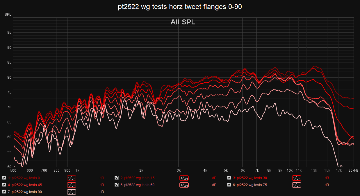

Shallow waveguides:
1. shallow
2. shallow with 3 slots
3. shallow with cheese holes
4. shallow with no flanges
5. shallow with minimal roundover
1. shallow

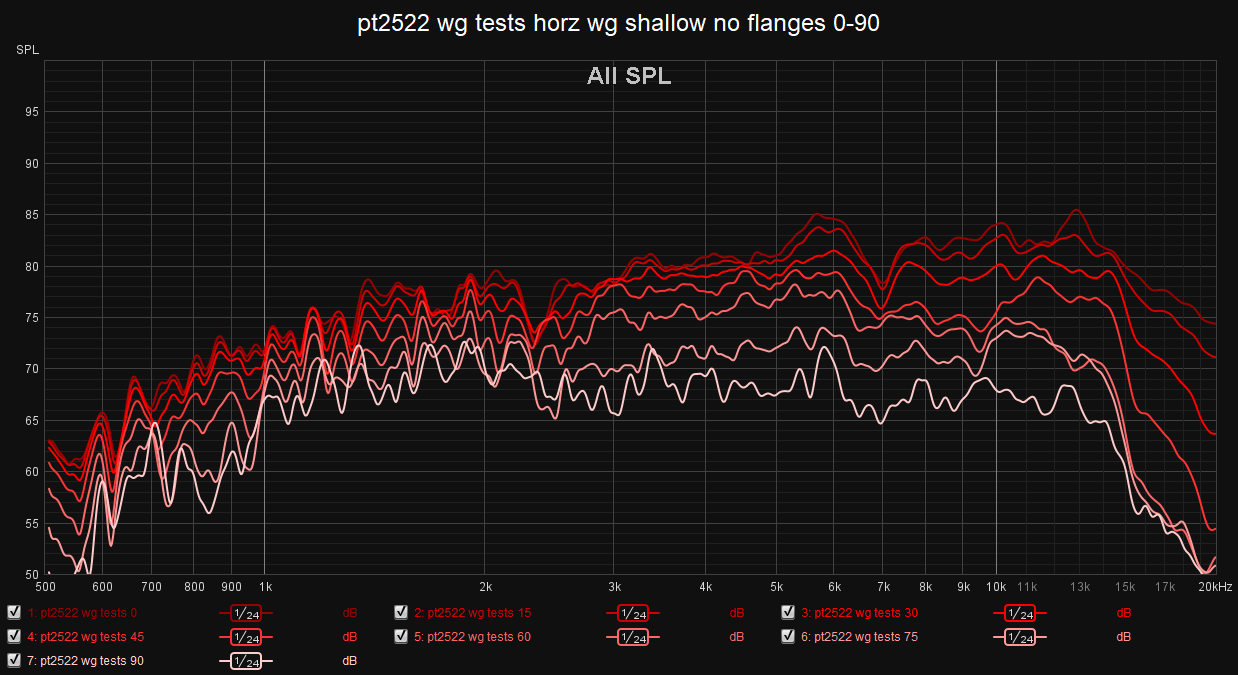

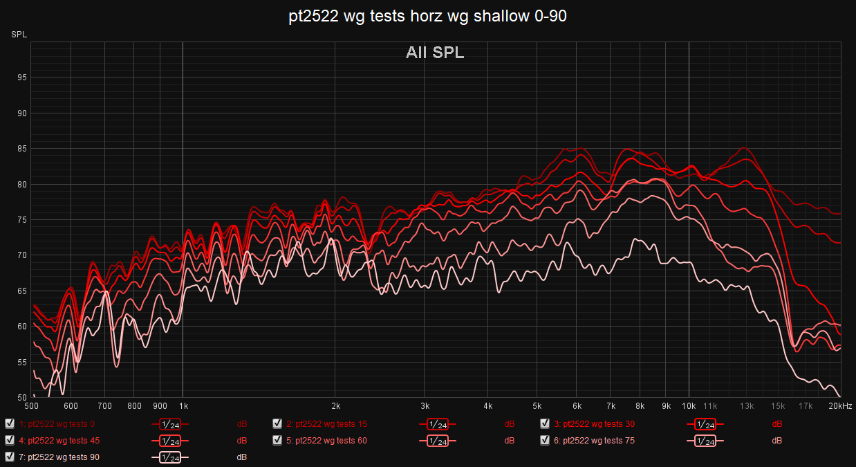

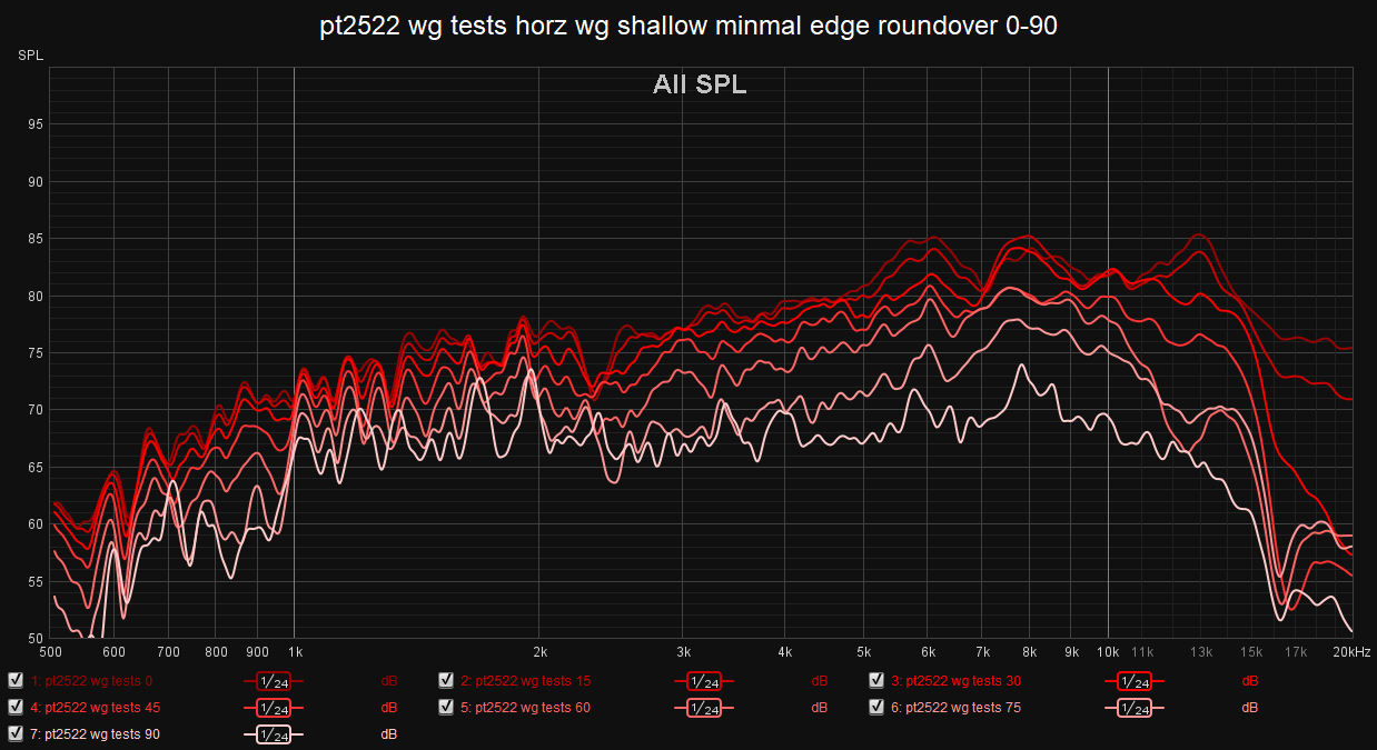

pt2522 wg tests horz wg shallow minmal edge roundover 0-90.png67.9 KB · Views: 102
Conclusion:
The shallow waveguides seems to match the dipole dispersion better than the steeper original. Also, the 3 slot and cheese holes seems to make everything worse. I was also was supprised by how much just the mid flange improved things.
All in all I think the best is probably just the flanges with the minimal roundover. A close second is only the mid flange and third the shallow wg with minimal edge roundover. I will probably test some more combinations around those.

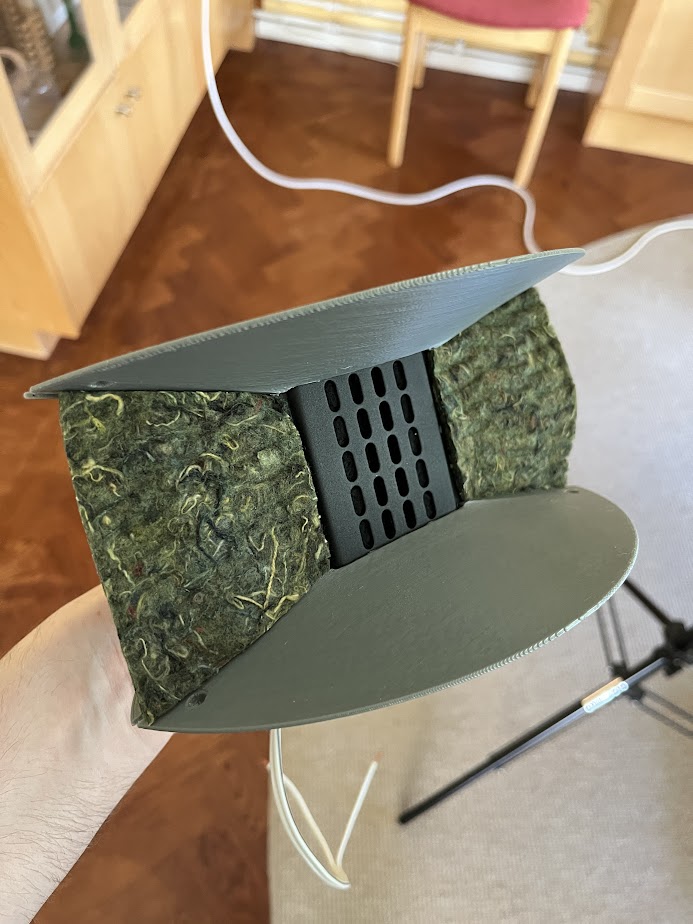

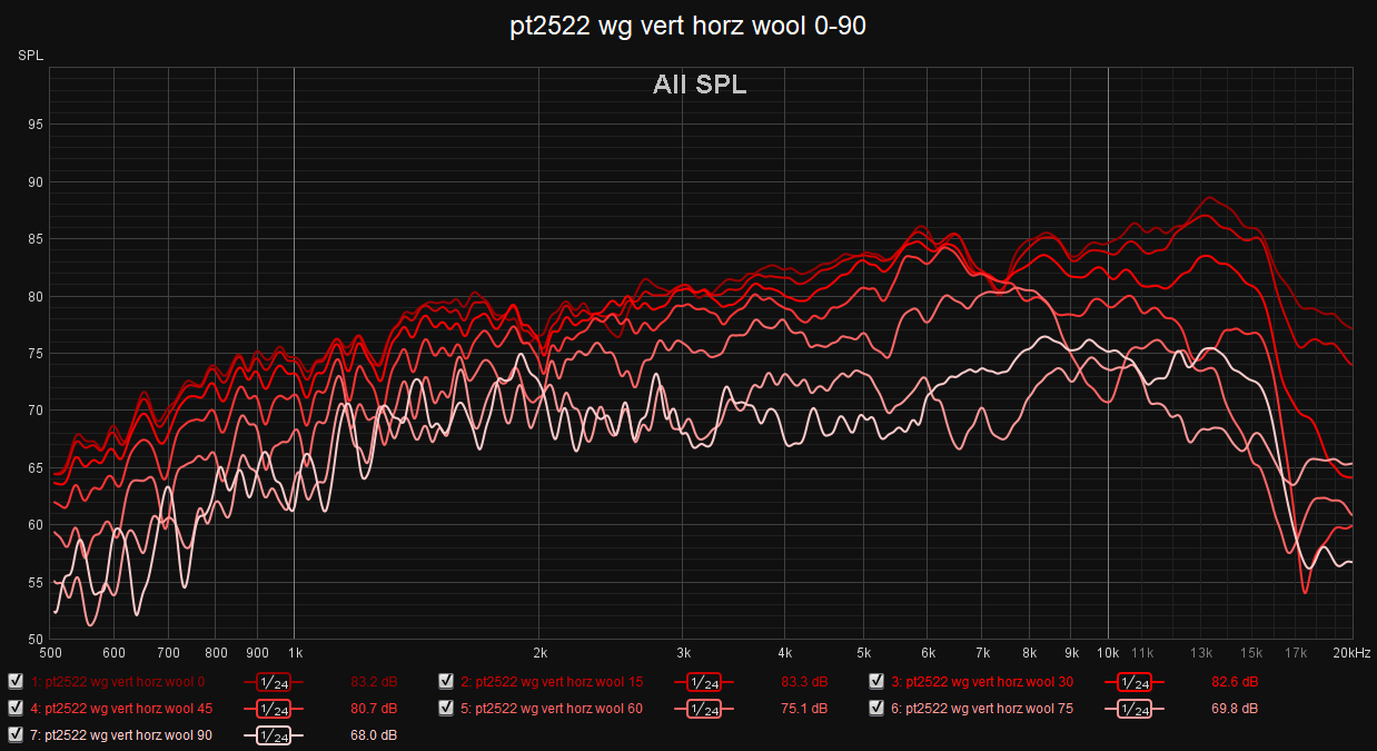

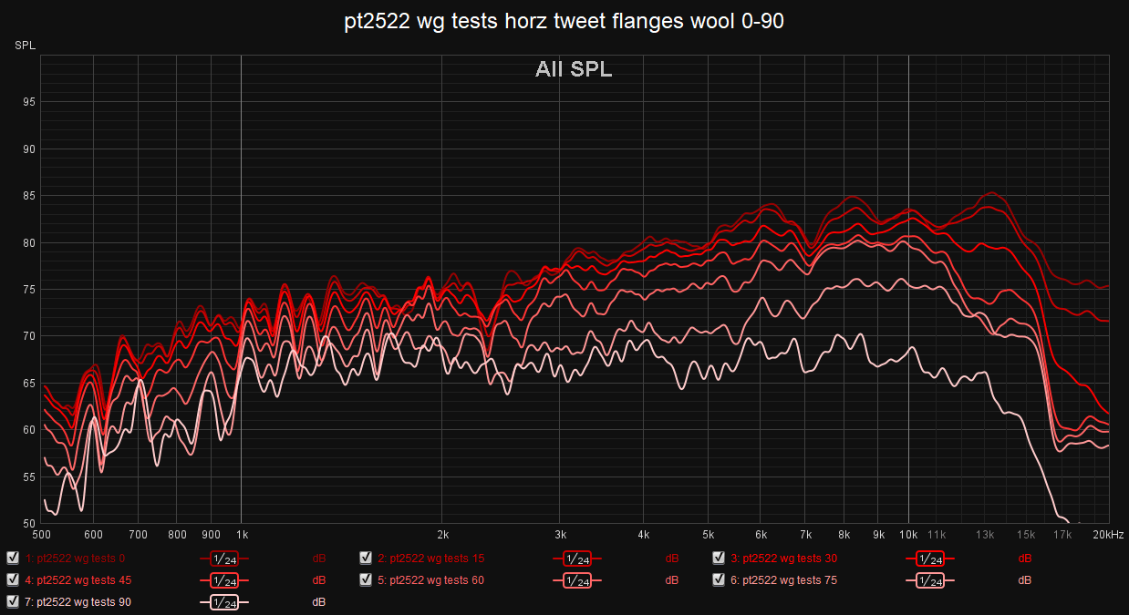

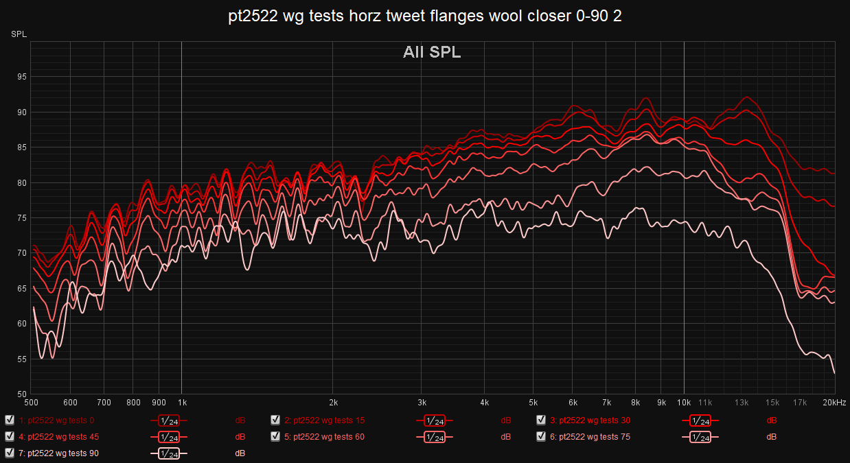

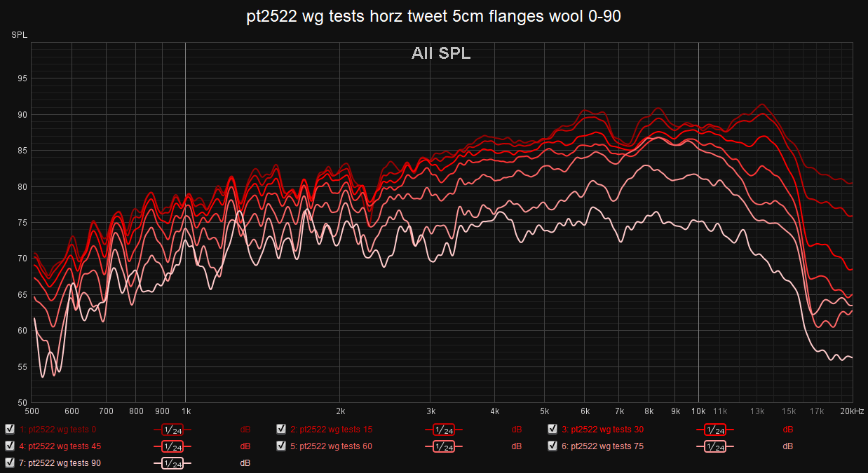

I also wanted to try to add some wool carpet to the sides of the minimal roundover. And it did improve the response slightly between 5-20 khz. This looks to be the best combination so far.

1. I have peeked at your masking of the tweeter yes. In my other experiments I usually covered the tweeter such that only the inner two holes are exposed and it improved the response somewhat. It was not, however, by itself enough to "fix" the problem of the PDR tweeters where the outer holes don't radiate as much. It worked best on the Neo3W or GR Neo3 which both have 5 rows of magnets instead of just 3. Tomorrow I'm planning to test doing just that but with the added mid flange.

A 5 cm high mid flange seems to perform slightly worse than the more modest 2.5 cm flange:
I remeasured the 2.5cm flange to make sure the comparison is fair.
