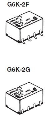

How does it work that your attenuator is click free? I have heard similar attenuators and they always click...
Is the new small Omron G6K relay better than the older and larger ones?

The relays still make a click when you then them on/off, that is unavoidable with any kind of mechanical relay. So when switching volume you will hear a lot of clicking but that is just a result of using mechanical relays.
What I mean when I say pop and click free is that there are no popping or clicking sounds in the output when you switch volume.*
*However due to the fact that it is not possible to implement zero-crossing detection with mechanical realys, you will at times hear some very small pops in the sound and when I say small I do mean small. This is unavoidable and ALL, and I do mean ALL R-2R relay volume controllers on the market has this small issue.
In the end what matters is the sound when you are not changing the volume level and there this circuit really delivers.

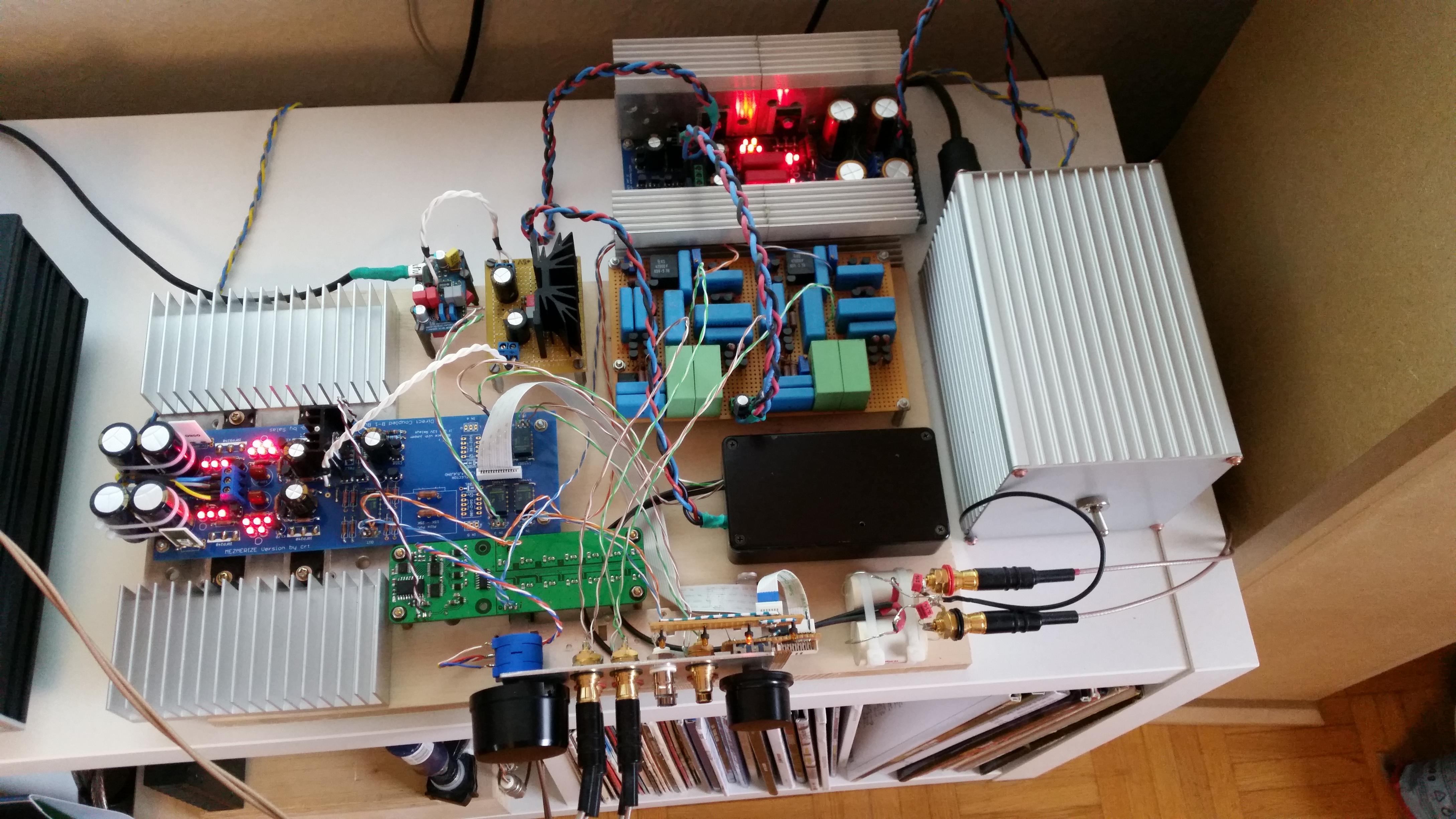

I meanwhile have the attenuator up and running. Currently there's a multiturn 10k lin wirewound pot installed for level control, which works fine for now. The supply voltage is taken from the 7812 reg on the DCB1 board.
Compared to the Alps blue velvet pot that I was using before, everything sounds tidier with the relay attenuator, and to my ears the bass has tightened up quite a bit. I'm very satisfied, thanks for having made your project available Neutrality!

I am glad that you are satisfied with it.:)
