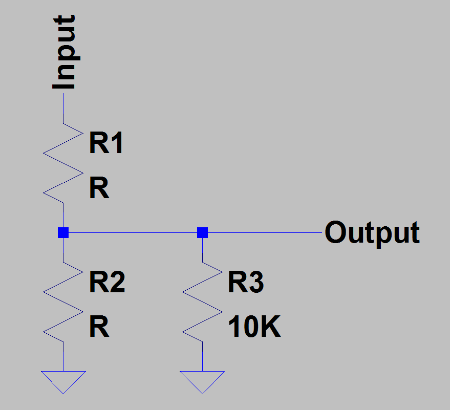

The attenuator needs a 10K termination resistor to maintain a 10K total attenuator impedance.
The output impedane varies between 0R and ~5k.
No matter how You ´terminate´.
If using a 10k termination from out to gnd the Zout still varies, just on a lower scale from 0R to ~3k3.
It´d be wishful if Zout would be lower (~1k) and constant to allow for a fully passive volume control.

If using the specified resistor values and a 10K termination resistor from output to GND, you will get a constant input resistance of ~10K and a Zout that varies between 0 and 5K06.
You could also configuere it with a constant Zout of 1K but then the input resistance would vary between 1K59 and 121K if you have a load of 100K. This would also require a small redesign of the board to do.
The reason for having a fixed input resistance and varying output resistance is simple a question of what is most convenient. Most people put a volume control at the input of their system and there it is wise to have a relatively high input resistance so as to not overload any source connected to the input/volume control.
What you propose require people to have source that is capable of driving below 2K loads and a lot of sources on the market are not happy about that.
If you have a source capable of driving such low loads or include some buffering before the volume control, it is an alternative, but for most people, it just is not an option.
Short explanation for the 10K termination resistor.
Looking at the attached picture, R1+R2 is the attenuator, R3 is the termination resistor.
R3 should be 10K and attached from the OUTPUT of the attenuator and to GND.
With the resistor values in the BOM, the termination resistor has to be 10K and this ensures that the total attenuator impedance stays at 10K and all 128 steps are 0.65dB.
If a lower/higher value termination resistor is used the total attenuator impedance will be lower/higher than 10K and the steps will no longer be 0.65dB(step size will vary between steps, not good)
So it is essential for correct operation of the attenuator, that the output of the attenuator always sees a load of 10K to GND.
The total attenuator impedance of 10K and the termination resistor value of 10K can be changed but it will require to replace R1-R28 with different value resistors.
EDIT : Just to add some real world experience. I am currently using a 15K termination resistor in my test setup and the step sizes seems good enough. But the optimal value is still 10K and that will also be what I will have in my final setup.
