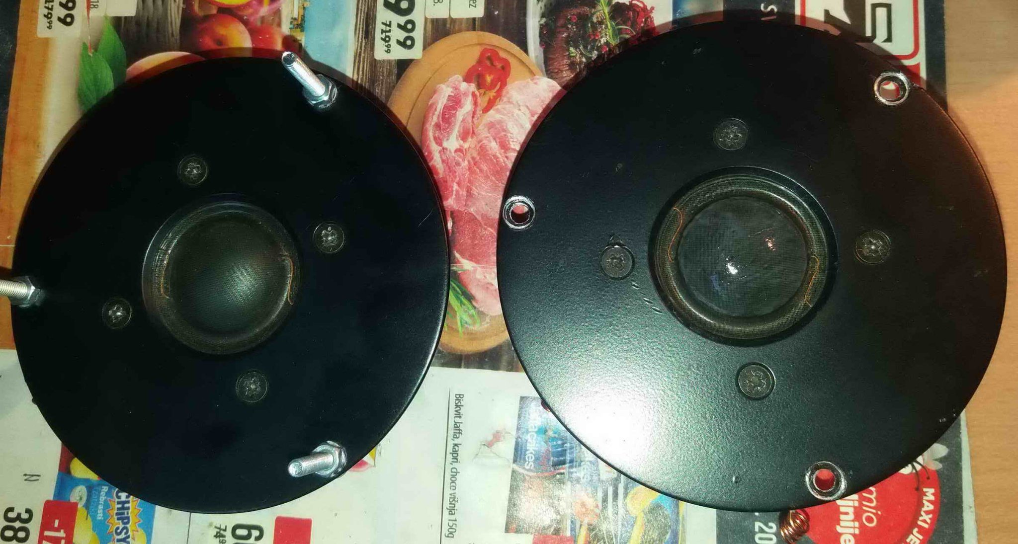

I own 2 pairs of Heybrook HB2 speakers , with Polydax ( Audax ) silk dome original tweeters. All the tweeters have impregnation/coating that have aged, and more than 50% of the dome surfaces lack coating. Sound has degenerated accordingly.
I am desperately searching for a liquid, as close as possible to the originally used or better, for redoping / reimpregnating the domes myself.
This because I tried the "drop-in" Audax tweeter replacements sold by Falcon Acoustics, that sound not even close to the originals.

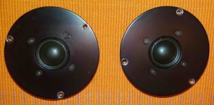

Coincidentally I have a pair of Polydax(Audax) tweeters with coated cambric domes that have lost enough coating to affect output and now sound 'dull and weak' with a notable lack of transient response.
From my investigations at various sites I have this information...hope it is useful to you. (Excerpts quoted intact from sources)

The sealant is nothing more than butylene rubber dissolved in toluene, with coloration of the normal amber butylene provided by carbon black, and you trivially can make your own.

The original sealant, according to my research and reading at any rate, was supposedly a fairly simple mix: butyl (aka isobutylene) rubber dissolved in a low-molecular weight solvent carrier such as a mix of toluene and xylene. Not rocket science today, and it certainly wasn't in the 1950s and 60s. The carrier evaporates leaving the rubber behind. The latter mix had carbon black added to make the surround opaque.
Butyl is very sticky as everyone has experienced: chewing gum is a food-grade butyl rubber. If you know how sticky that remains over time, you can appreciate that butyl rubber is likely the right material for surrounds which are to remain flexible and tacky over time.

Retrovert is correct...The Vintage AR formula is mostly butylene and toluene, and remains tacky. It required research into the original formula, as well as a great deal of testing and measurements. The toluene also helps soften the original sealant. The goal was to re-seal with minimal added material to the surround.

Let me start by saying, thank you, thank you thank you, Drone7! The data you have gathered and kindly supplied me, more than convinced me that isobutylene ( butyl rubber ) indeed was the original tacky stuff used by manufacturers. I have read doezens of threads and searched internet, but have not managed to come up with so convincing proof that you have. It has been a mixed basket with "try shellack!" "I used silicone !" "Water solution of akrylic glue" etc etc and of course every now and then "I think it was isobutylene...". Now my efforts start to find any sources where I can buy/aquire isobutylene and toluene, in reasonable amounts and money for tweeter restoration, not running a large scale business...! If I find something of interest, I will let you know.

The info I quoted refers mostly to doping/redoping fabric surrounds though as you have said there are several mentions elsewhere of isobutylene ( butyl rubber ) for tweeter doping and some surmising that Audax/Polydax used the same.
I have seen a comment that raw butyl is needed as Toluene does not dissolve vucanised rubber though I have no confirmation of this.
Having searched some more for materials I see that Wikipedia show butyl with a picture of chemical handling gloves...and realised I have several pairs!
Once I find some affordable Toluene I will shred a pair of gloves and see how well they will dissolve.
I am guessing that a stock solution needs to be made, then perhaps diluted with more toluene and very light coating applied to the fabric domes.
Perhaps after drying and testing another coating if needed ?
