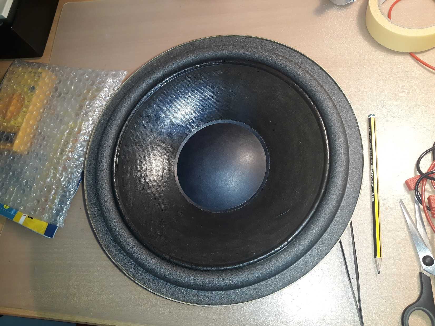

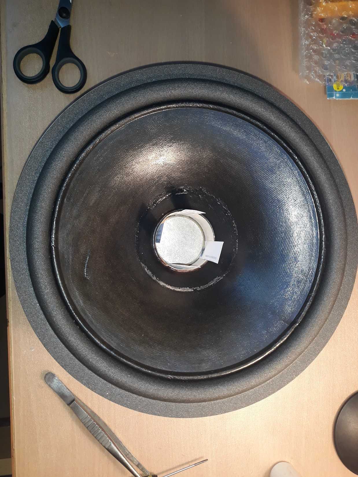

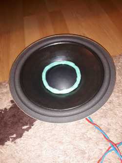

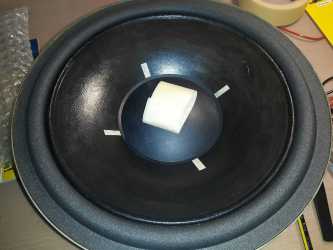

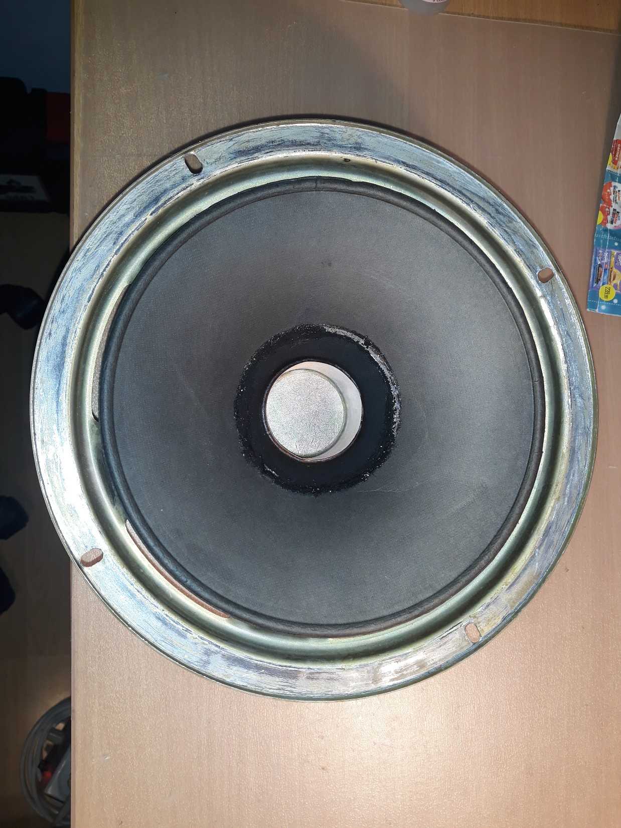

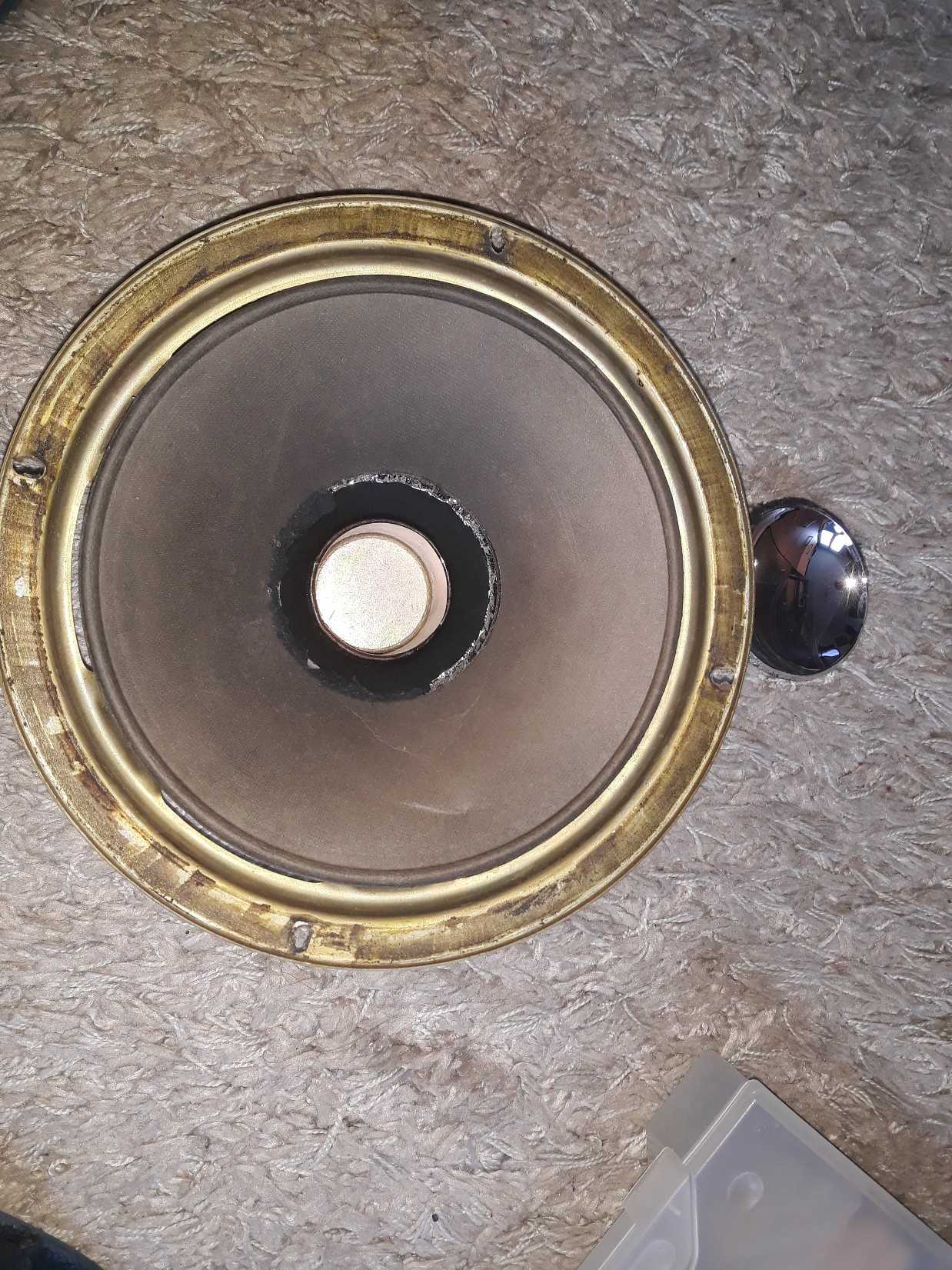

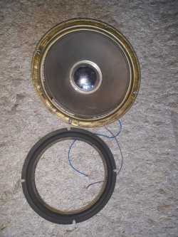

Here are some screenshots using the LTS50. This was an old 10" Tonsil bass, used for restoration playing.

It will never be like new, so don't worry. 🤣
Over time, everything has changed there. Everything (except metal) is organic matter, and that is subject to change.
I clean the paper membranes with Isopropyl alcohol. I don't think these silk ones are allowed, only distilled water.

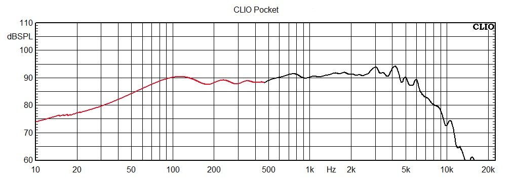

Yes, they are both white : ) But ModPodge is not pva glue! It have unique ingredients and have been around for many years, very popular for decoupage. The first speaker with a paper cone that I coated in two layers really showed a calming of the cone and a flatter response when measuring, it really helps! I even coated the edges of the cone on the rubber with it, it still sits on the rubber today and hasn't come off after 15 years! Try it on an old speaker!
https://www.google.com/search?q=Is+mod+podge+the+same+as+pva+glue
This one is coated by MP more than 10 years ago, probably 15 years ago. Nothing has hardened, it is as elastic as the first day when it was applied.
