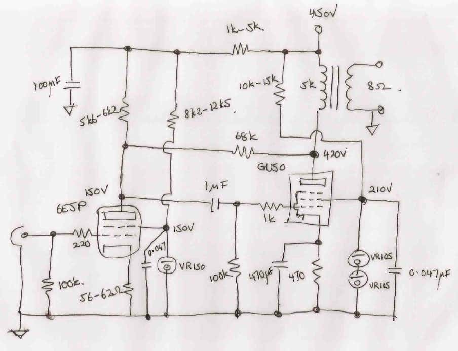

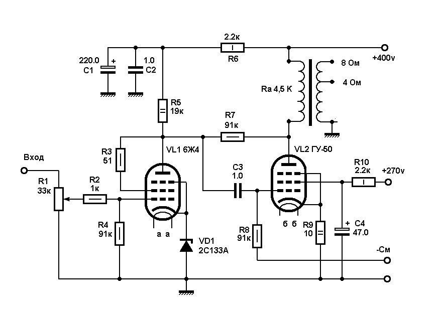

R7 is the “Schade feedback” resistor.
R8 is part of the fixed bias device.
The above amp using the 6E5P was mine. The 68k Schade resistor effectively changes the GU50 to having a triode character, in some ways better in terms of the GU50's Rp (ie. lower than triode mode). The comment above about poor damping factor is rubbish. Also the higher the transconductance of the driver (in this case the 6E5P) the better the "Schade" effect, hence me not using the usual EF86 suspect.

Hi, you miss an obvious fact in the circuit above your post. The output pentode has local ”Schade” feedback making the pentode get triodelike characteristics and also lower Zout. As a bonus you get pentode effiency. Note the driver also has local feedback. Search for Michael Koster and Schadeode. It uses a depletion MOSFET as driver that has close to pentode curves. If you sim a circuits like this, you usually get a typical triode overtone spektrum.Pentode mode has a high output impedance which results in a poor damping factor for the speaker. This may accentuate the self resonant frequency of the speaker. Its probably more dominant the the THD in terms of audibility. Global NFB will help here.

This circuit is badly designed, with a wimpy driver unable to drive the low impedance network. It is also triode strapped which will not work in a Schade design.An other one...
How works the R7 (91k) circuit,please?
It's the same value as R8...
