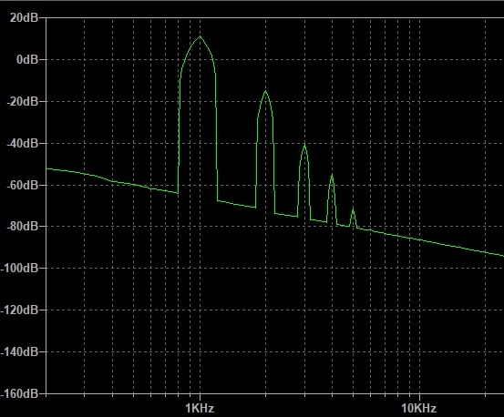

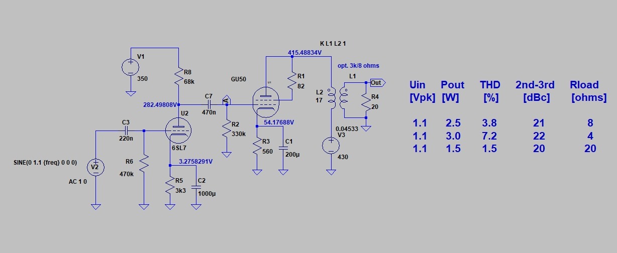

The 2nd harmonic is the dominating distortion component. If overall THD is to be reduced, then 2nd harmonic must be reduced most.It will be a very bad thing to reduce only 2nd harmonic.

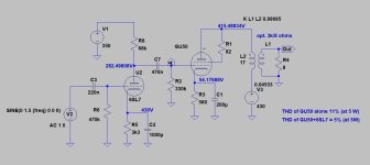

Attached is a quick simulation example I just made. THD of the triode connected GU50 alone is 11%. When combined with "badly" biased 6SL7 (which is now generating some 5% of 2nd harmonic distortion too), the overall THD of the whole amplifier is reduced to 5%. All the values are taken at 5 W.
And 2nd harmonic is still dominating component, some 15 dB above 3rd harmonic.

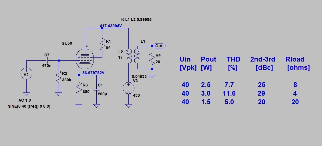

Triode wired GU50 SE (only) with constant input voltage (40 Vpeak) but with varying load resistance.

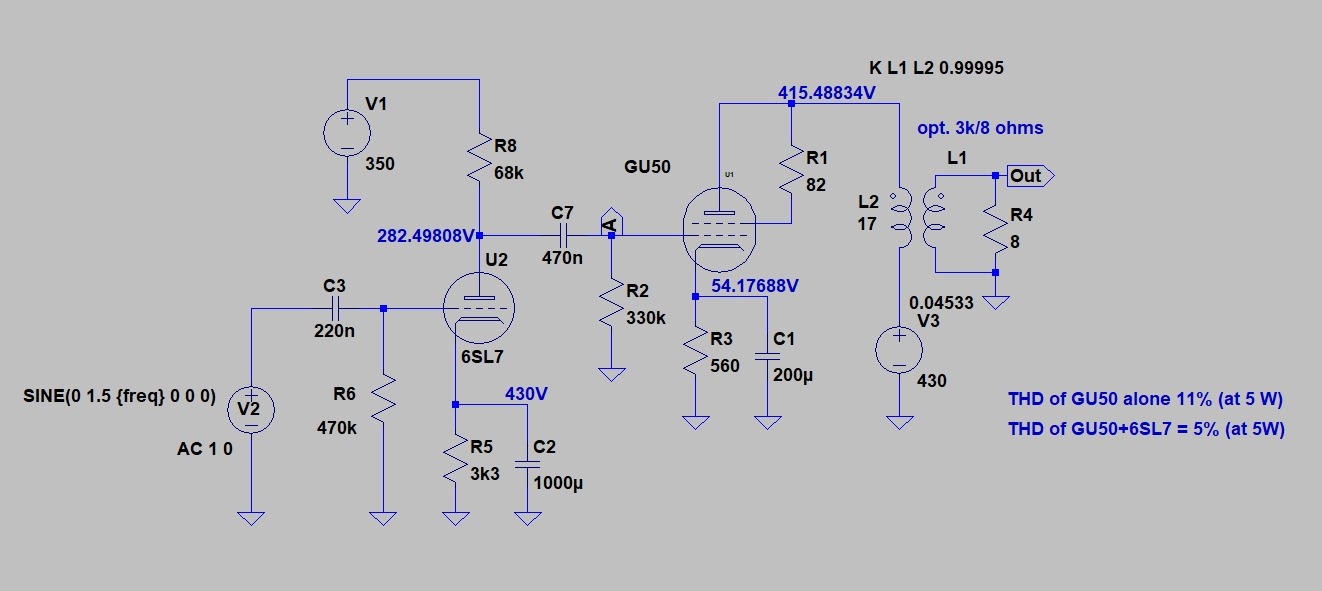

I am getting THD levels as yourTriode wired GU50 SE + 6SL7 biased for distortion cancelling:
I can be seen that distortion cancelling is effective at all (4, 8 and 20 ohms) load resistances.
without any modifications.LTspice is only for educational purpose when it comes to tubes.

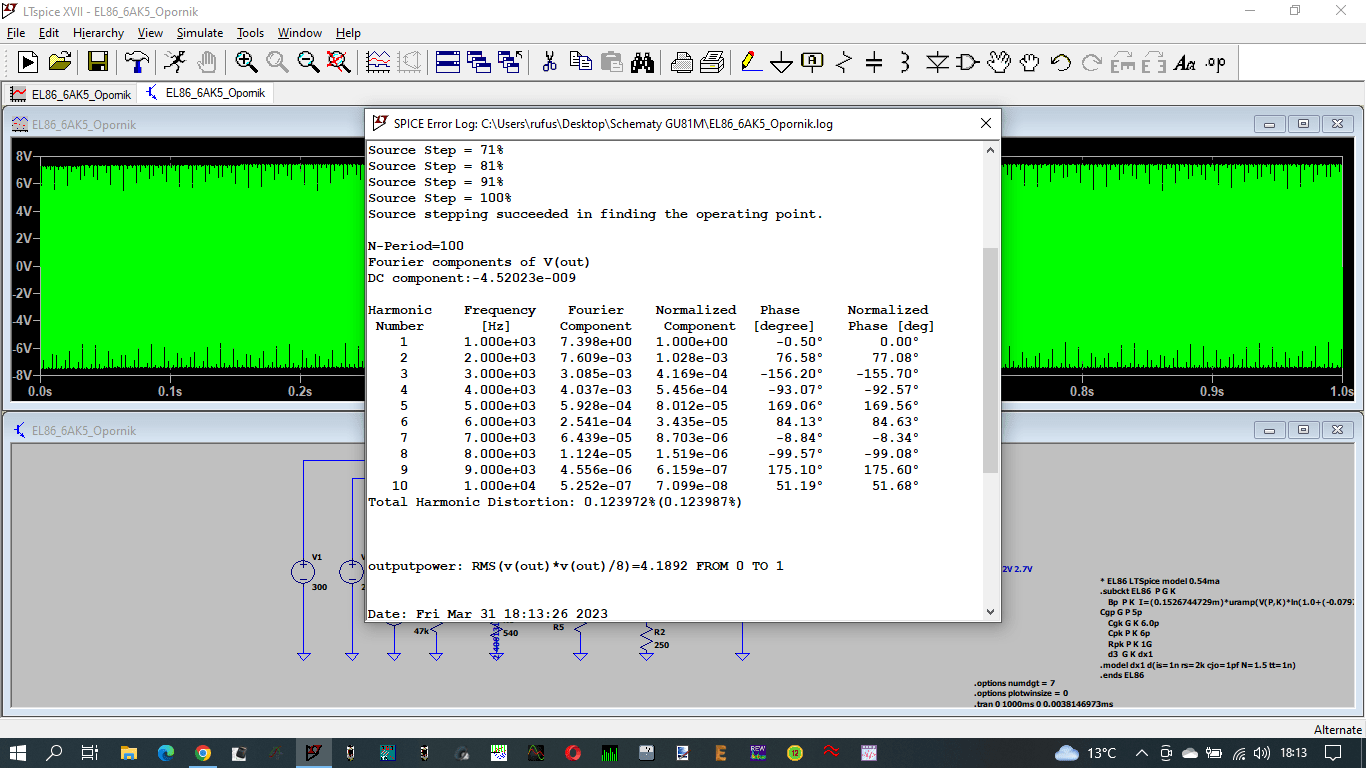

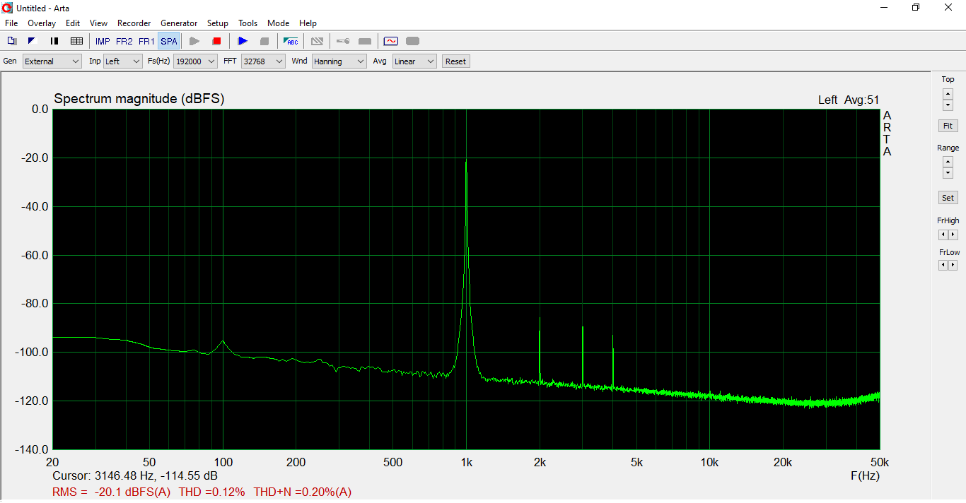

Hello.
Here you have the simulation result in LTSpice and the measurement result of the same system, i.e. PSE_EL86 in a triode with an output power of 4.2W. I have a PSE_4P1L triode amplifier and the difference between simulation and measurement is 0.1%THD, i.e. for LTSpice simulation it is 0.4%THD and measurement is 0.3%THD with 4W output power.
Piotr
Piotr

Hello.
I don't want to prove anything to you, I've been designing amplifiers in LTSpice for a very long time and I've never been disappointed. To do an accurate simulation of your circuit you need to have the characteristics of your GU50 into a triode, just as you need the characteristics of the EC8010 you have. If you can, show the measurements of the amplifier.
Peter
Peter

artosalo,
Thanks for doing that exercise!
1 stage:
For the output tube only, with constant level of 40V peak to g1:
The THD varied by 6.6% versus the load impedance.
The Delta of 2nd to 3rd varied 'widely': 9 dBc, versus the load impedance.
2 stages:
For the 6SL7 with 1.1V in, and the output tube at a constant level to g1:
The THD varied by 5.7% versus the load impedance.
The Delta of 2nd to 3rd varied by 'only' 2 dBc versus the load impedance.
So, for 1 stage the THD varied by 6.6% versus for 2 stages the THD varied by 5.7%.
Very little difference versus load impedance.
And, for 2 stages the Delta of 2nd to 3rd varied by 9 dBc, versus for 2 stages the Delta of 2nd and 3rd varied by only 2 dBc.
Lots of difference versus load impedance.
Of course, the 3rd harmonic was lower for the 1 stage, versus for the 2 stages.

I have done exactly that. Harmonic cancellation seem to have a narrow working window. For example, I tuned the first stage of a SE amp for minimum distortion at 10W, but then got worse figures at 8W. Also changing the load made a big impact.Now, take a challenge, and use that LT Spice program to do some real research about input stage 2nd H. distortion canceling with output stage 2nd H. distortion.
Triode Wire the output tube.
Remove any global negative feedback, local output tube cathode negative feedback, any Schade negative feedback, and any UL negative feedback.
That way, the real nature of the input stage and output stage 'cancellation' shows up.
Negative feedback can be applied later, after the study is done.
Set your amplifier software model for 1 Watt output, 8 Ohm secondary loaded with 8 Ohms.
Use an easy test frequency, 1 kHz.
Write down the input signal voltage that is necessary to get 1 Watt output 8 Ohm tap and 8 Ohm load.
Always apply that same input voltage, for tests 1, 2, and 3 below.
1. Load the amplifier output transformer 8 Ohm secondary with 4 Ohms. Check the 2nd H. distortion.
2. Load the amplifier output transformer 8 Ohm secondary with 8 Ohms. Check the 2nd H. distortion.
3. Load the amplifier output transformer 8 Ohm secondary with 20 Ohms. Check the 2nd H. distortion.
What did you just test? You simulated a real world loudspeaker.
You tested the input stage to output stage 2nd H. distortion cancellation.
But, the output stage 2nd H. distortion is not a constant when you change the load impedance (even though the signal to the output stage control grid is constant for all 3 tests above.
Have fun . . .

I'd say it does improve distortion, but it does not replace having two stages with good linearity.
PS I did that with a real circuit and also with Ltspice.
