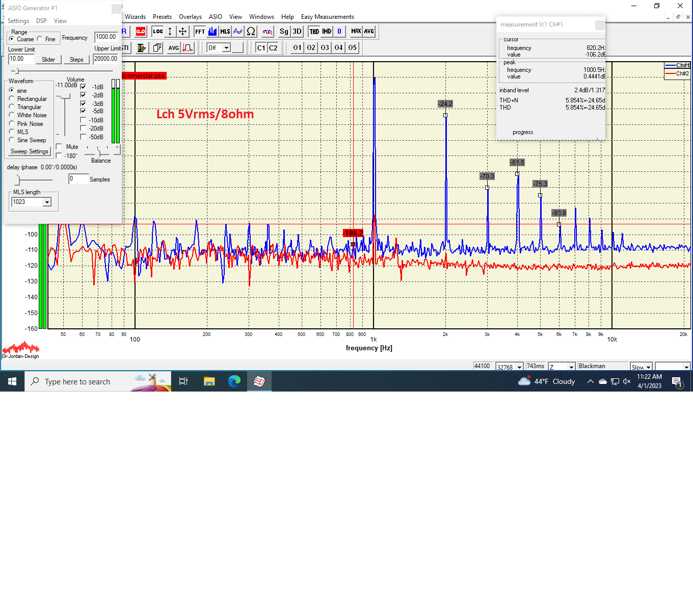

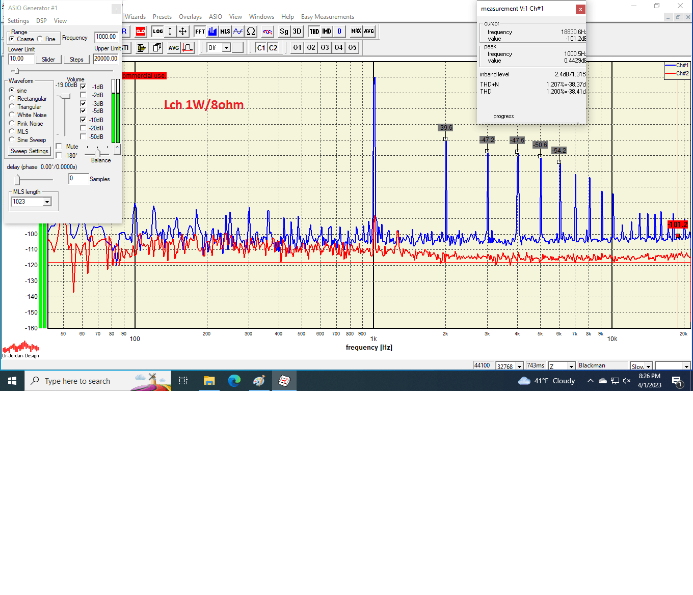

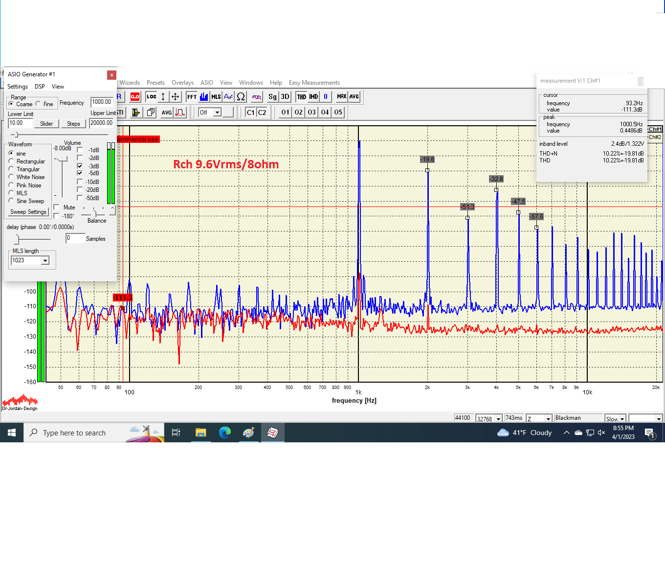

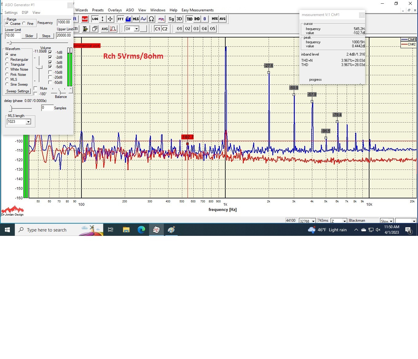

Cancelling H2 usually increasing H3. If H2 decreased, the H3 will be dominating.I found that if I suppressed 2nd too much the amp began to sound harsh.
No free lunch.
IMHO any cancellation is a different kind of harmonic distortion.

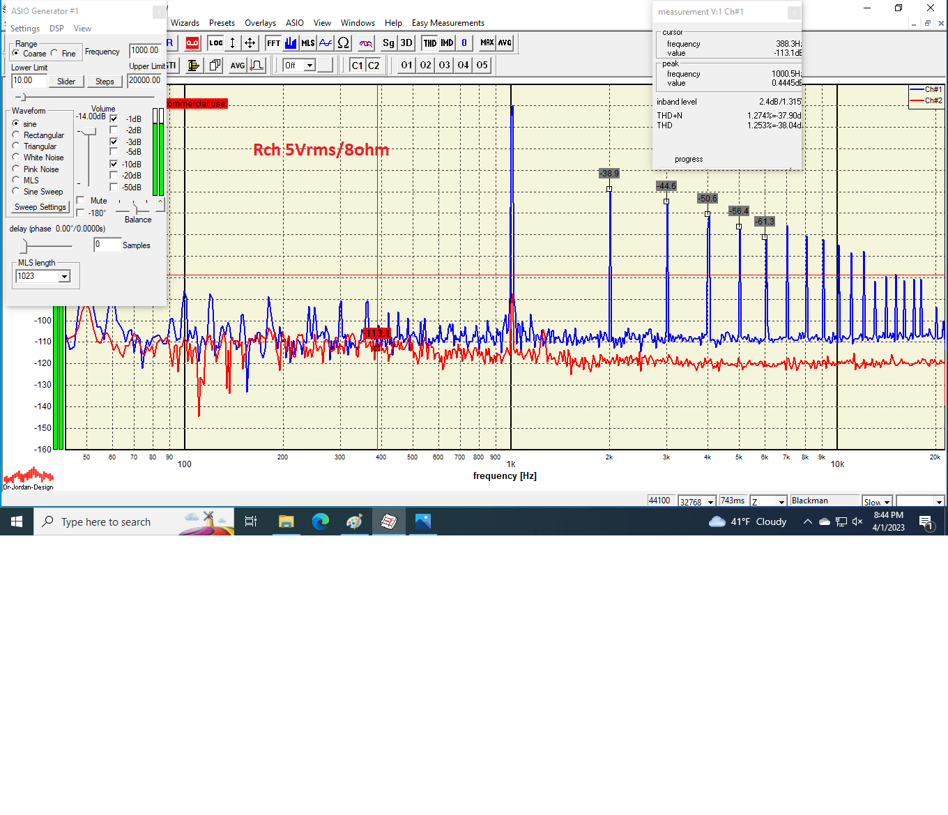

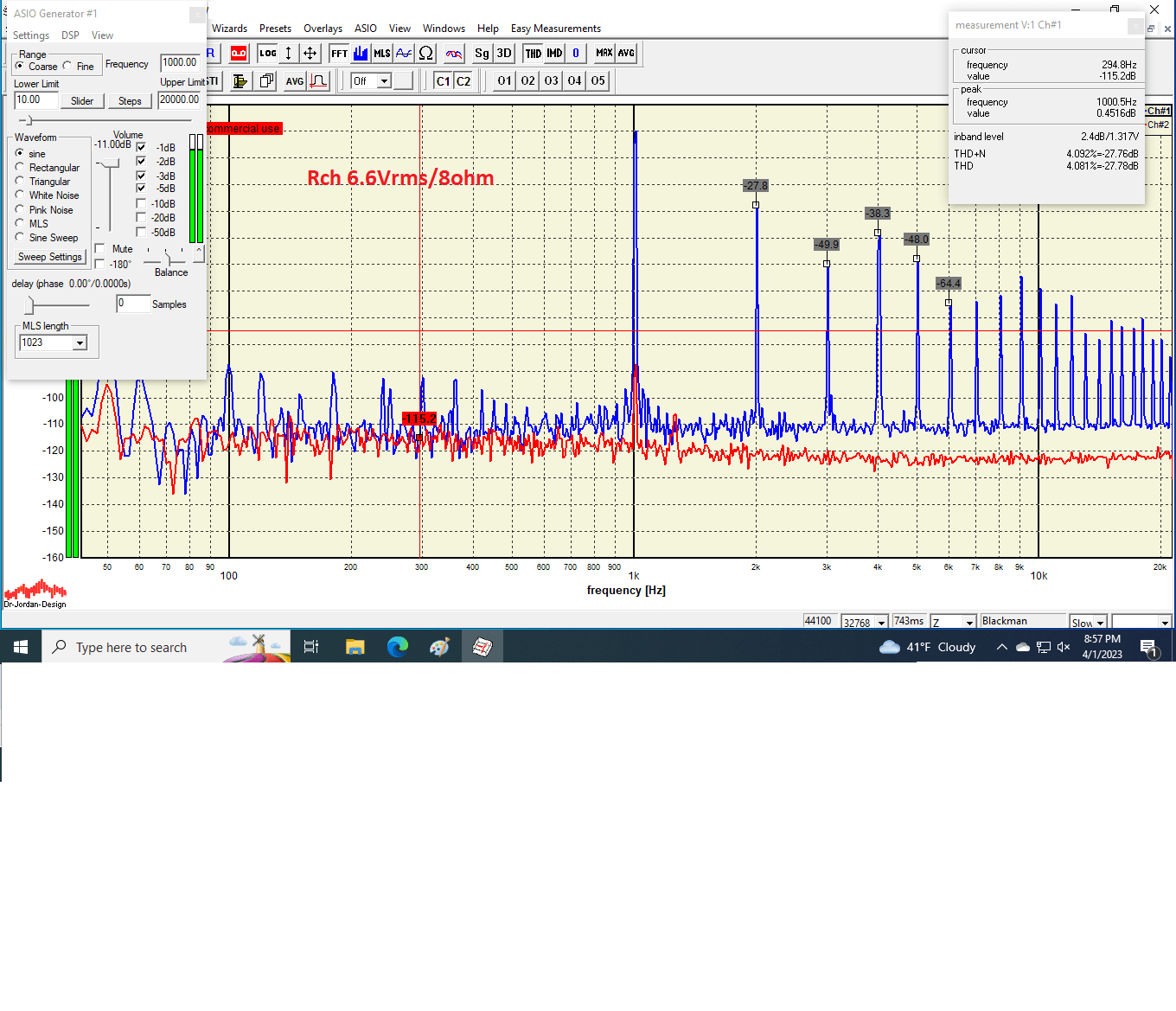

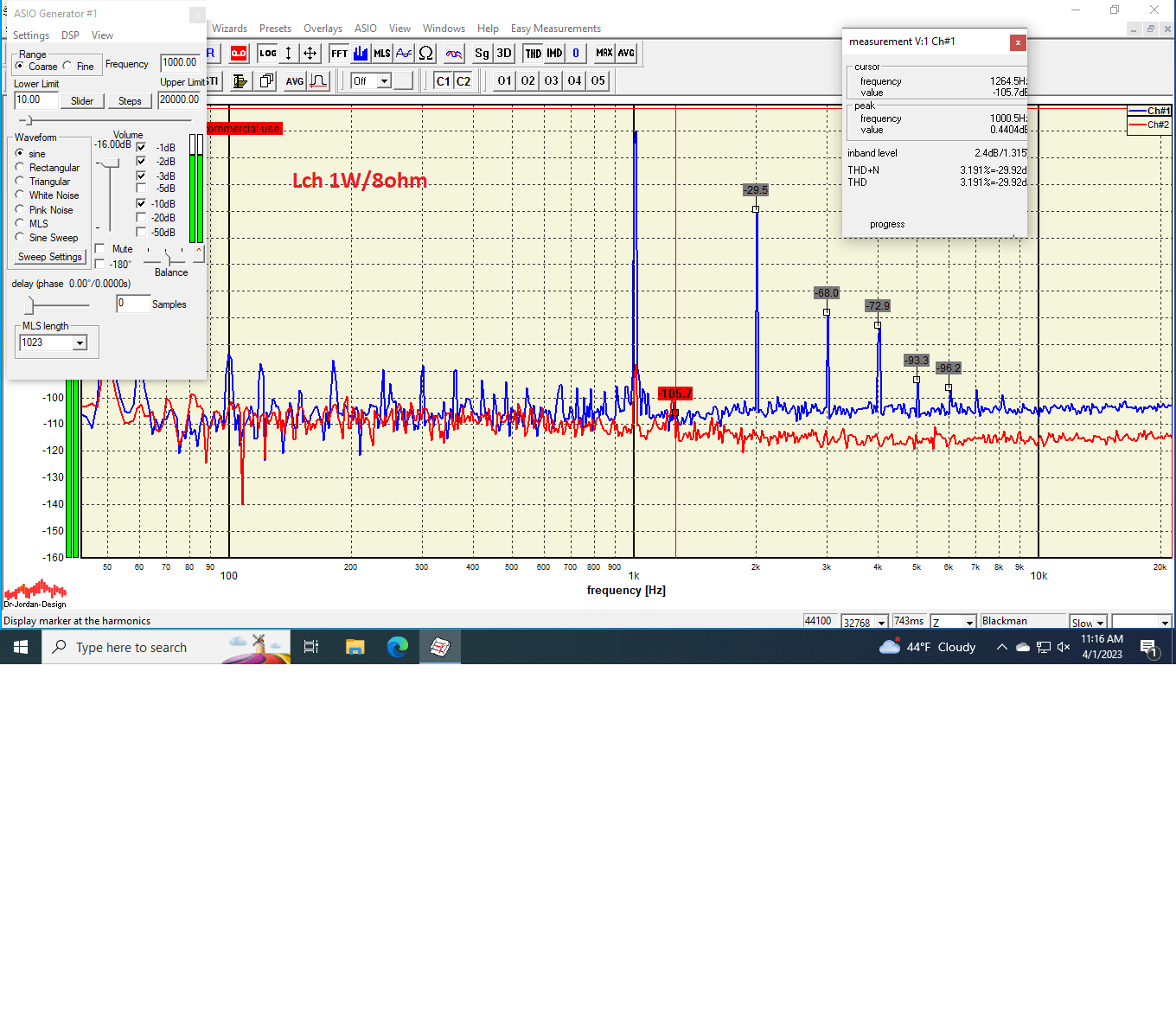

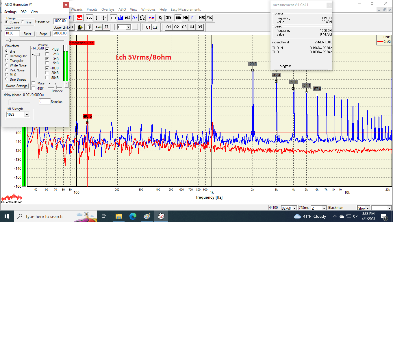

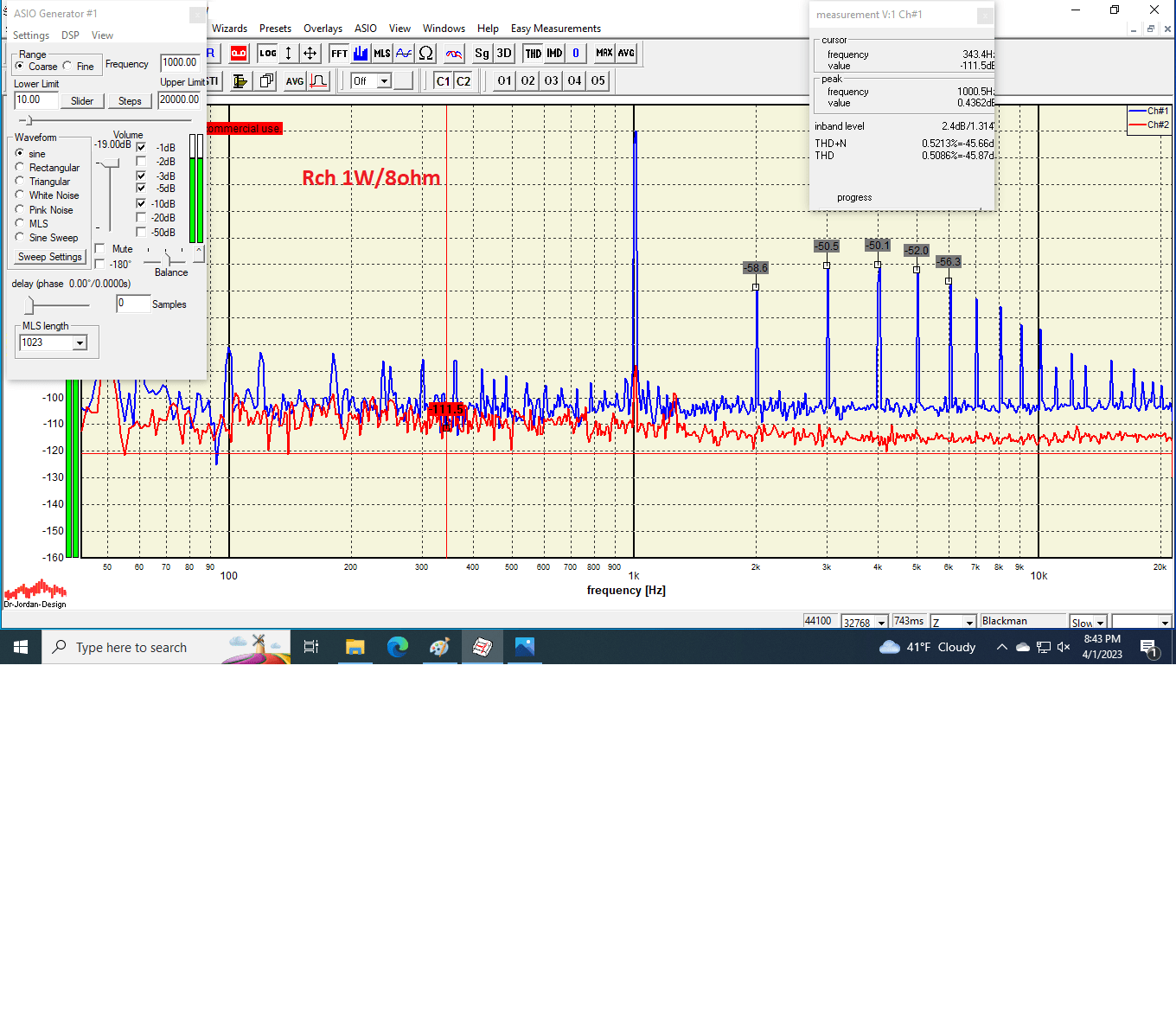

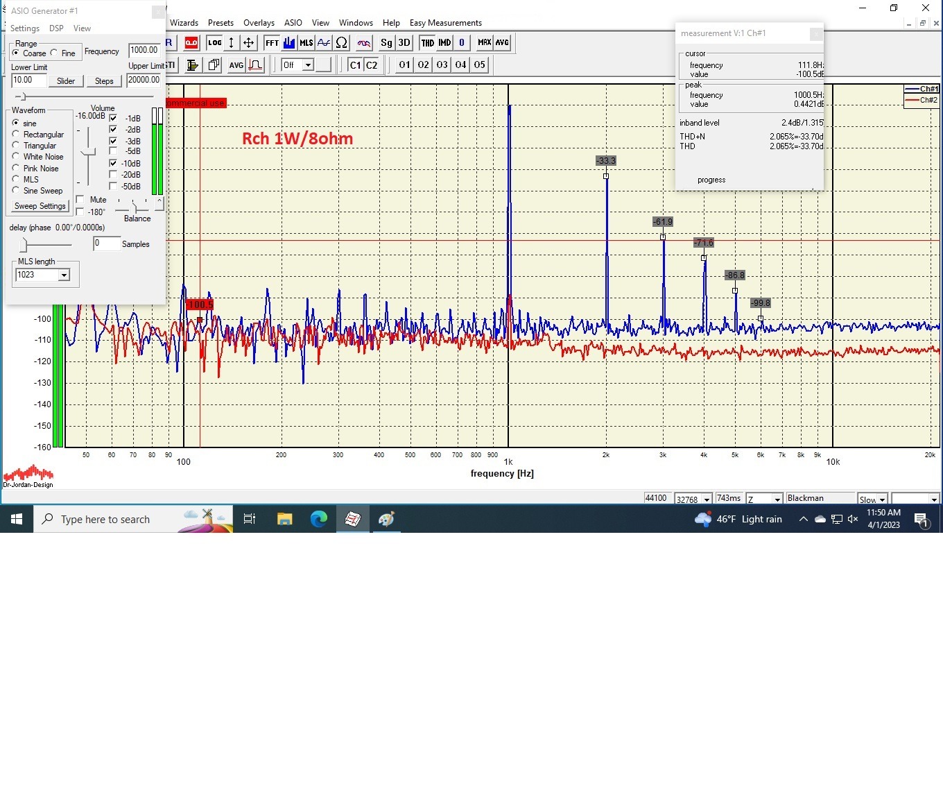

Are you sure, that this amplifier working well?
Channels harmonic structure differs in both connection (triode, UL), mainly at higher power.
Try to swap power tubes and repeat measurements.
I completely abandoned UL connection, triode is the way to go. Maybe I will try some global NFB. We will see.

Conclusion: GU50 is not for the faint heart LTspice gurus.

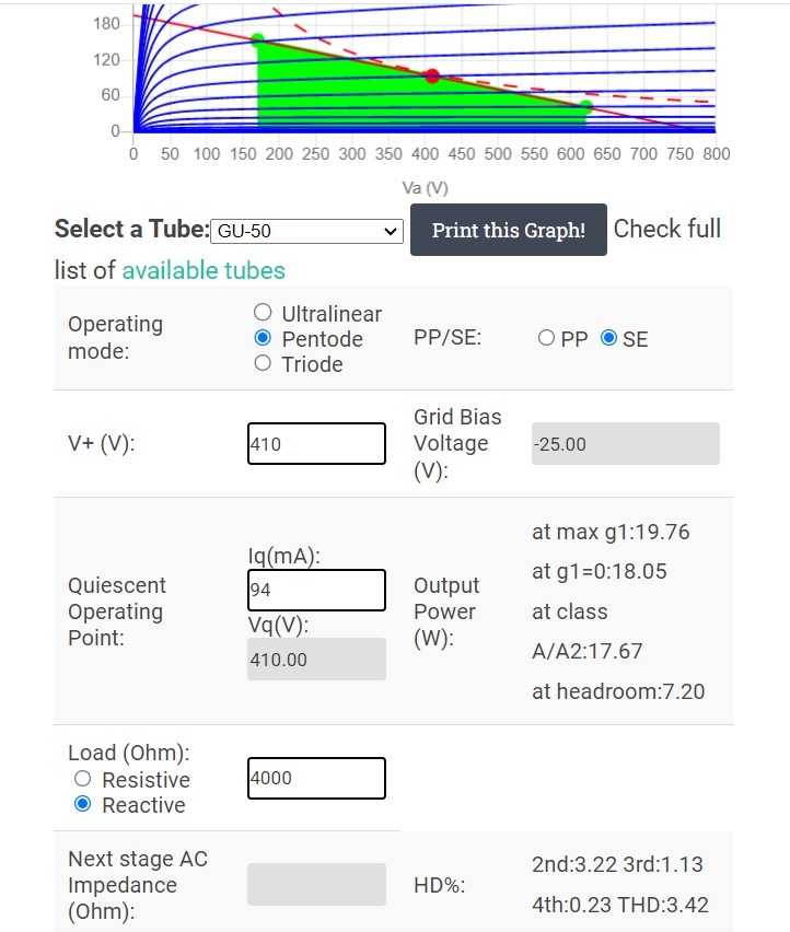

hello, after building this :
https://www.diyaudio.com/community/threads/how-might-a-6gm5-do-tied-as-triode.361182/post-7555142
I want to try now a SE with the gu50 .
Anyone as tried the pentode mode ?
How its sounds ?
I have tektronix power transformers who can allow it and 4K output transformers.

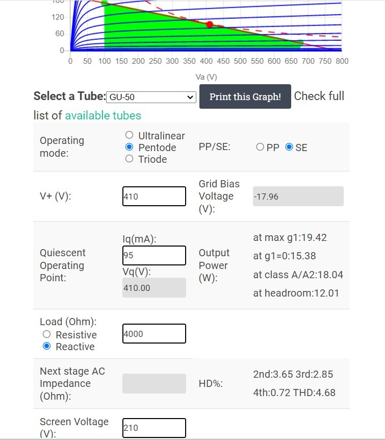

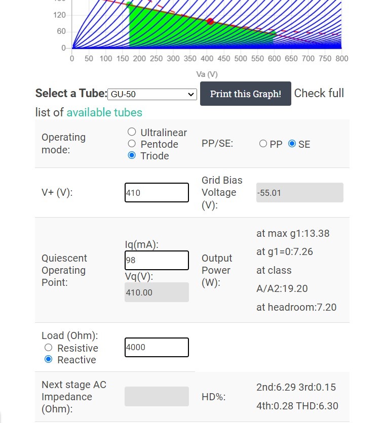

The picture shows what i get with the Vtadiy simulator.
THD pentode mode give more power and less THD, but more 3rd Harmonic distortion than triode mode.
After few reading ultralinear mode doesn't work well.
Any reviews,please ?
Regards

For pentode mode you will need some kind of negative feedback. The Vtadiy simulator only takes into account the tube (output one in this case) curves, that's it. The input stage matters, feedback etc.
Yes ! I agree with you.
I noticed two fact:
1) for the same output voltage swing 3rd HD fail to 1.13%
2) the pentode mode requires only a small input signal, which allows a negative feedback.
With a nice pentode at input stage , a 10 dB negativ feedback should be possible.
