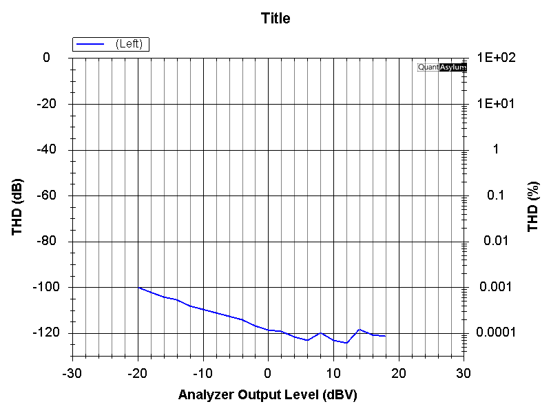

The only data I can offer is for a 180nF polycarbonate cap I measured:
Which is at the analyzer floor for distortion (the rise on the left is due to noise). So I predict they will be basically equivalent, other than polycarbonate not being made for decades...
The measurements would have been made in a divider with a resistor of similar impedance at the test frequency.
