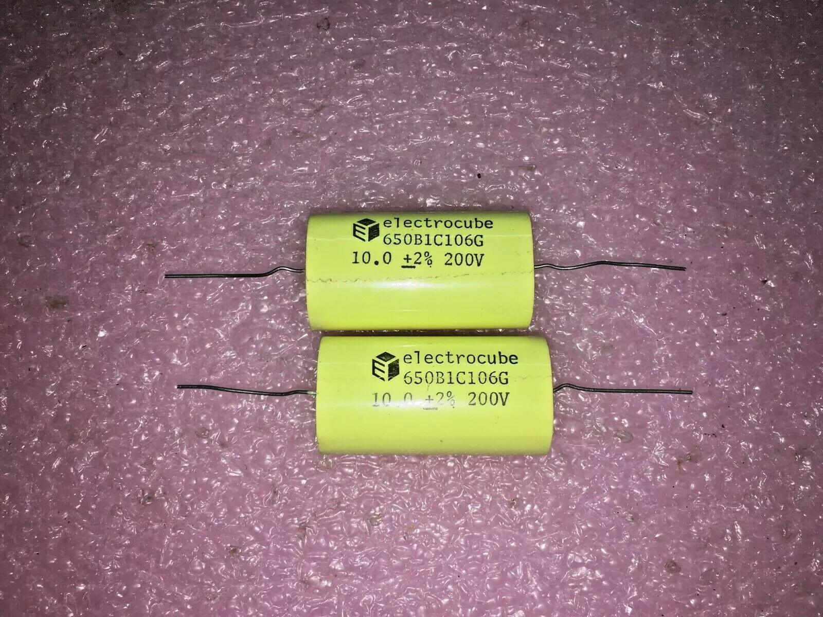

Got this for $20, poly-carbonate
Can you guys recommend a good film cap from Mouser or Digikey
Here are the 2 film caps I am going to replace with something newer
10 MF 100V
I was thinking Cornell Dubilier 940C

Holy smokes those are rel-caps. Those are great caps.
Since you don't want them and will change them for something better,
please PM me and Ill give you my mailing address, to send them for me
to experiment with.

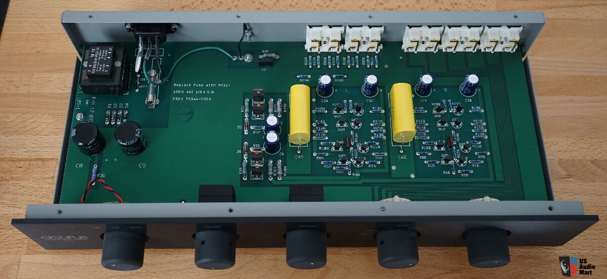

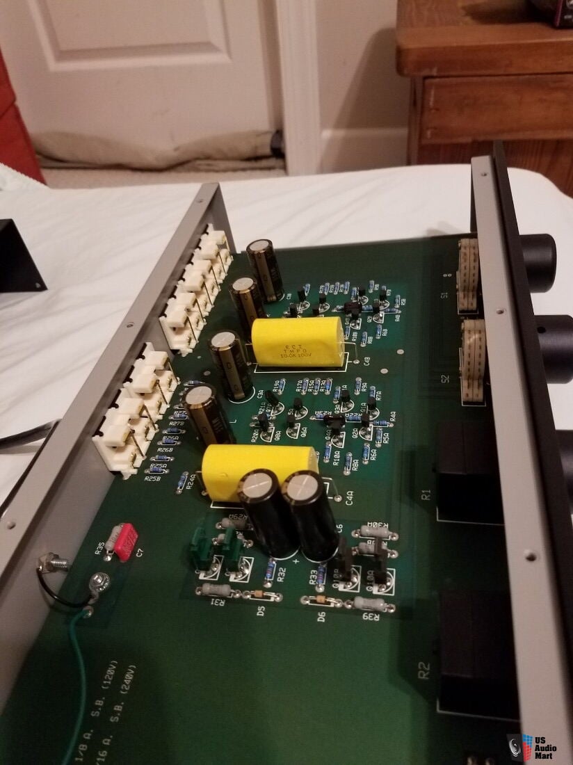

I was going to use those rel caps in a Acurus preamp, same company
Can you ID those yellow film caps ?
