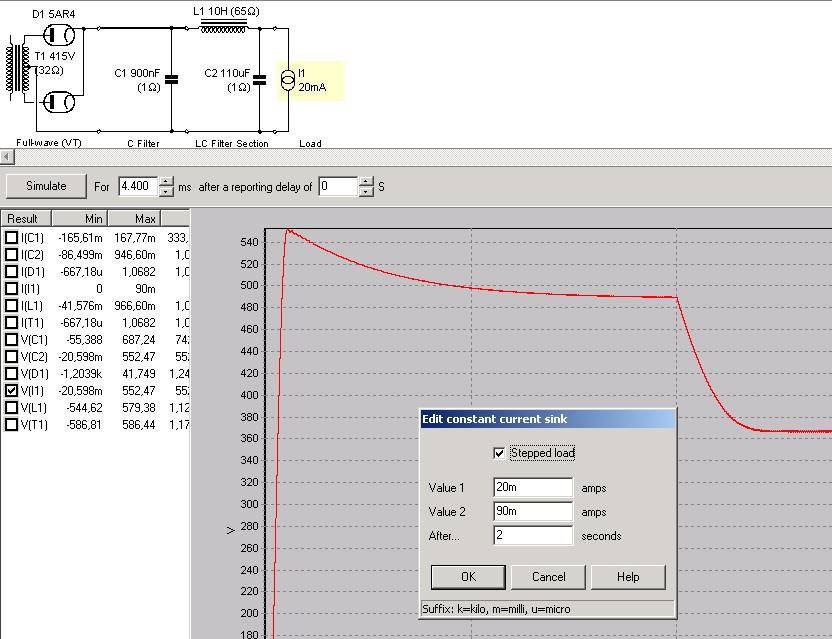

Depending on what you've done with your psu, nothing different happens after x amount of seconds. The interesting thing is how the psu handles transients I think. (Although in a SE Class A amplifier the current draw is the same?)Most of his analysis centers around the first 10sec after turn-on. Shouldn't we be more concerned with the steady-state (ie...POST 10sec)?
And what I look for is a lack of ringing when there is a sudden change in current. Such as in my Ladyday psu.
And here an "unstable" supply do demonstrate ringing when current demand is changing.
What is interesting is that after 10 seconds..this "unstable" supply will have LESS ripple. But does it sound better? Than one with slightly more ripple but one that is rock solid? I don't know. But the point is there is much more to a power supply than creating DC...IMO
Ok. I was wondering how to model current demand changes downstream and reflect that back to the model....you're suggestion to use the stepped current sink shows me how I can attempt that...

Talking about power supplies a while back I have astrange problem that does not make much sense.Thereis a bit of low level ps oscillation around 1 or 2 hz and in the mv range that also goes thru to the Aikido output.
My ps is diode bridge-10uf-1k-330uf-(300ohm-22uf)x2.It simulates well without problems.On the scope however the dc level has low ripple but seems to be wavering up and down around 100mv every once or twice a second irregularly.
The first question is- is this normal for a ps because of mains AC variations or is it motorboating?
Secondly why is this coming out of the output of the Aikido?My theory is that since the output is biased at half the ps voltage then with a high enough cap (I am using 1.8uf) this very low AC variation will also be reflected at the output even though the aikido is supposed to be ps immune.
I tried a capacitance multiplier which brought the variation to about 10-20mv on the output but it is still there.

I got curious and just put the scope to my power supply to see if could see the same thing.
First off my temp (how long has it been now?) junk box power supply looks just awful. I have some major ringing, yet the Aikido sounds good I was not able to see any slow shift
I would think that very small changes of the AC voltages would look like that. Do you have some other power supply you could measure?
The reason you can see it at the output is although the Aikido has good PSRR, it is not immune. What you have is closer to changes in DC level then ripple. Maybe a HUGE C-1 would stop it, but I doubt that is a good idea.

I built a VTV linestage a few months ago - my first real DIY project-and hooked up a scope to see how stable the output was. I saw a voltage drift up and down every half second to second of 10 - 100mv. Thought it was motorboating or something. Hooked it up one evening and watched the scope for over an hour and couldn't figure out why the output seemed to drift a bit randomly. Then the fridge tuned on and I got a spike. Ah-ha. It looked like fluctuations in the AC supply. Hooked up a DVM to measure house voltage and saw it wantered. (Note - my DVM is slow so you see changes every second or two). That's what mine was - house voltage wanders. Even when nothing is cycling in the house, it drifts a bit. Could be what you are seeing.
