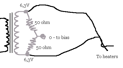

Should the 6x5 heater be biased up just like the signal tubes?
And, how do I connect the 80V bias to the 6.3V 3A heater winding, anyway
You should connect it to the center tap of the 6,3V supply.
The 6,3V center tap is either real if the (3,15-0-3,15V) in that case you should connect the 80V bias to the 0.
Or a "virtual" center tap. Created by 2 resistors of say 50ohm.
6,3V
50R
0
50R
6,3V
see attached diagram
Ok...the lack of a center tap for the secondaries on the transformer I want to pick up threw me. Thanks for the explanation on how to create the virtual center tap.
