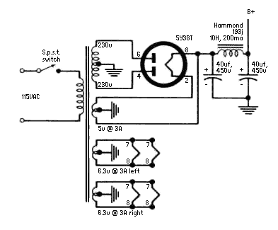

aikido psu help
i just purchased the R0080-036 r-core power transformer from: http://www.vt4c.com/shop/program/main.php
to use for my 2 Aikido octal boards.
the specs are as follows:
100W power tranformer 0-115V, 0-115V, International version.
260-230-0-230-260V 200mA Full-wave rectification
0-5V 3A with CT
0-6.3 3A with CT
0-6.3 3A with CT
Grounding/Screen wire
i'm still learning what changing various parts in a power supply does to the B+.
i appreciate any input and help anyone with a little patience can offer.
i have 2 ASC 40uf/450v caps i'd like to put to use.
so all i need is a choke and since the PT is 200mA am I correct to assume that i'll need a choke that is 5-15H in the 200mA range like the Hammond 193J?
when I draw up a schematic like the one attached, what's the best way to determine what my B+ will be. is there an equation? can you guys take a look at the schematic to make sure i'm on the right track? sorry for such basic questions, trying to become a better DIYer.
Max
