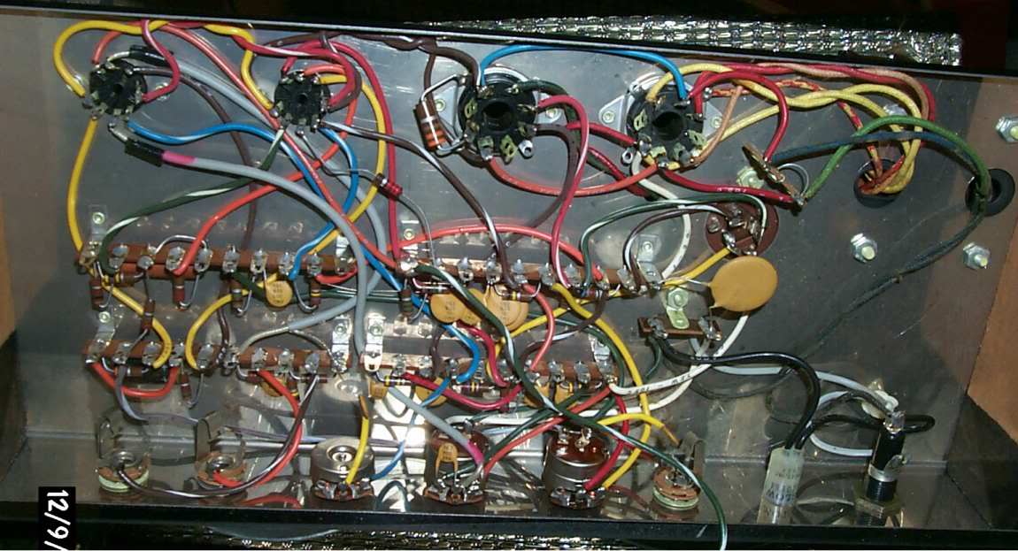

I use turret strips, and even old fashioned lug strips, and do point to point myself. If I went into production with one of my amps, I'd put everything but the power tubes and power supply power resistors on a PCB. Or something close to that.
it's really beautiful analogSa,
that fixture looks like you could almost use the dead bug method free air.

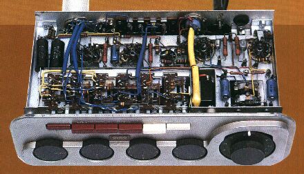

Tektronix had those beautiful silver-ceramic terminals.
Quad used a type of vertical layer stack on the sockets.
