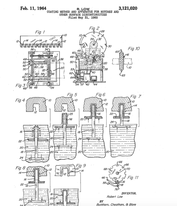

I wish the ceramic - silver terminal strips were still in production.
Here is the expired Tektronix patent. Yes I've seen the partsconnxton site.
https://www.google.com/patents/US3121020
