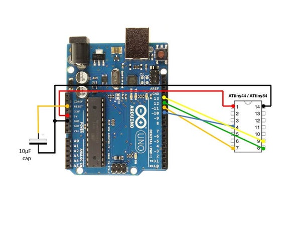

Is it OK to use ATtiny44
Because I cant find 84 in local stores 🙁
programming is the same according to:
http://www.learnerswings.com/2015/12/programming-attiny44-attiny84-using.html
It is only dif in memory amount. I think the script is not so long?
Arduino UNO is interface there...

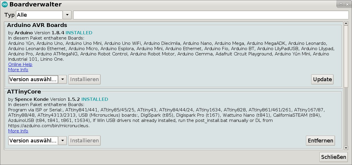

Yes, should work. You can test in the Arduino IDE prior to buying the chip: compile and you will see the amount of memory needed.

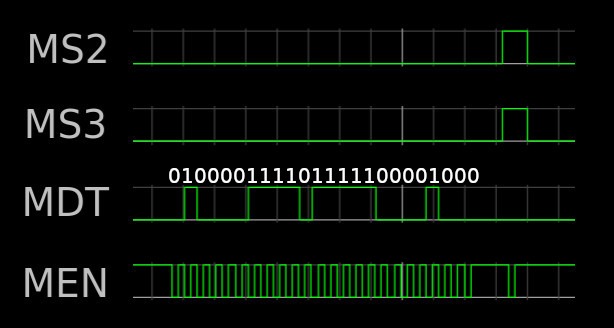

I simulated the code, see attached screenshot. I needed to change some details (as multiple bit fields such as dither are entered LSB first). The code is now easy to configure for the settings of the PMD100:
The code outputs 010000111101111100001000 which means OS = 4x, dither mode = 2, and simulation confirms that the output is correct:
I added two minor changes to the code: output_format must be set to COB, and the volume attenuation registers need to be reset after power on in program mode, so I added zeroAttenuationPMD100(). I tested the code on my Arcam, it worked right away:

I don't know, I use a small dedicated programmer... I recommend you program the Uno and connect it to the PMD100 to see how it works, later you can migrate to ATtiny. For the Uno just deleted the sleep routines....
I cant do it without hardware connection diagram?I recommend you program the Uno and connect it to the PMD100
Didnt catch that could work for Arduino and PMD only without ATtiny
I dont understand sorry, original idea islater you can migrate to ATtiny
1. to use arduino to "burn" the control code in ATtiny. Connected With PMD100
2. After setting ATtiny remove arduino.
3. ATtiny will control PMD100 with last uploaded code settings...
As I said: any mcu can program the PMD100, just wire it accordingly or change the pin numbers in the code.
Good, you are almost there! But you can also use the Uno instead if you don't need the additional step of programming the ATtiny from the Uno.

How to connect Arduino Uno with PMD100?
BTW i dont want to keep Arduino uno inside the dac because it is little bigger...

You might have a problem with your installation. Remove all IDEs (including non-Arduino!), delete all left over files and folders (especially stuff like preferences!!), restart your computer, install again. It seems MacOS has this kind of problem with Arduino. BTW on my Linux machine the location of "avr-g++" is in [drive/folder]/arduino/hardware/tools/avr/bin.
Can you compile successfully the "blink" example? It's in menu/examples/basic/blink, you need to get your system compile this first.
EDIT: your code compiles fine on my system!
EDIT2: found a small bug in debouncetm.h, please download new version!
EDIT3: see attached screen shot of the board manager:
