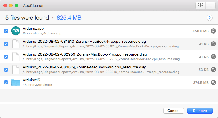

and i made one correction AppCleaner.app does find Arduino15 folder (created bu Arduino.app on the first start) so there is no need for manual delete.
Probaly on the list there could be more items if IDE longer used and with different projects.

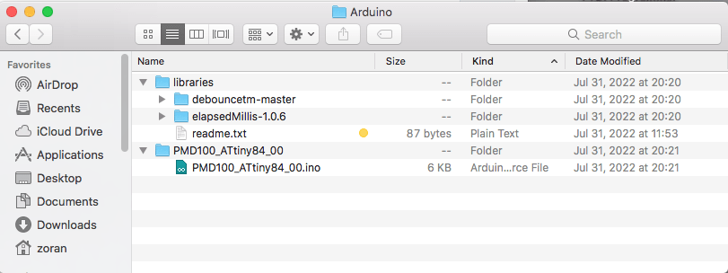

other Arduino related folder is in the Documents folder BUT that is remains untached and all libraries and projects are still there.

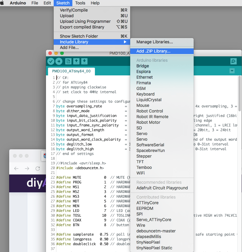

ZIP files (new debounce) for libraries
Arduino - Sketch - Include Library - Add .ZIP library

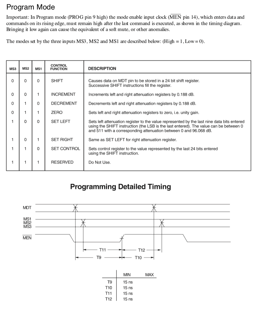

The diagram you quoted in #187 is correct: if you kindly check the pin numbers, they will correspond to the pins used in program mode (MS1 is not needed for setting up the PMD100, only for attenuation reset - see the data sheet for the pin names in stand alone and program mode). Simulation was done here, as all other simulations I showed in this thread...
Thanks for make it more clear 🙂
So the SCH is for stand alone mode and corresponding pins of PMD100 will remain the same in control mode?
I think we have need for MS1. But it is 0 in events on applying MDT?

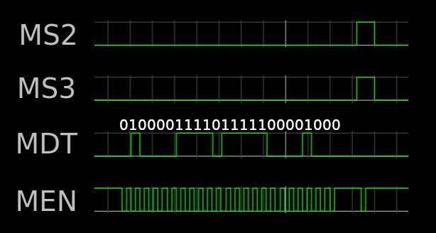

sequence must start with:
SHIFT control function = MS1, MS2 MS3 all "0"
and finishing with:
SET CONTROL MS1="0", MS2 MS3="1" like in Your sim.
So the MS1 pin in program mode, could be connected to GND "0" because for these events is always "0"?

So You emulated just sequence in time translated from the skatch?

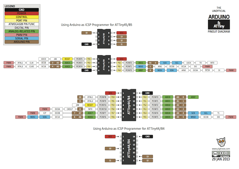

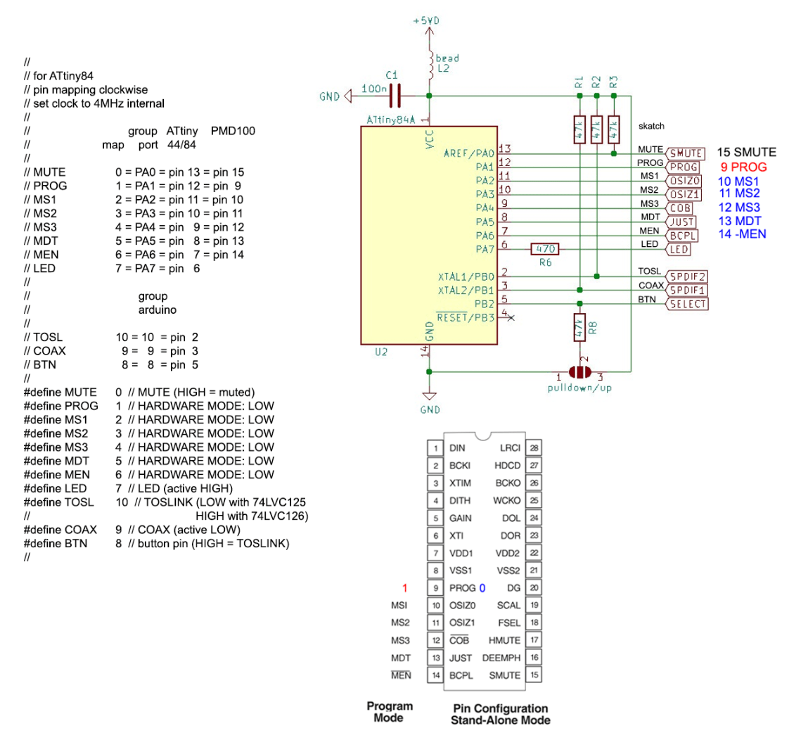

Hi
I checked and compared IDE sketch, variables, mapping and physical pins.
// // for ATtiny84 // pin mapping clockwise // set clock to 4MHz internal // // group ATtiny PMD100 // map port 44/84 // // MUTE 0 = PA0 = pin 13 = pin 15 // PROG 1 = PA1 = pin 12 = pin 9 // MS1 2 = PA2 = pin 11 = pin 10 // MS2 3 = PA3 = pin 10 = pin 11 // MS3 4 = PA4 = pin 9 = pin 12 // MDT 5 = PA5 = pin 8 = pin 13 // MEN 6 = PA6 = pin 7 = pin 14 // LED 7 = PA7 = pin 6 // // group // arduino // // TOSL 10 = 10 = pin 2 // COAX 9 = 9 = pin 3 // BTN 8 = 8 = pin 5 // #define MUTE 0 // MUTE (HIGH = muted) #define PROG 1 // HARDWARE MODE: LOW #define MS1 2 // HARDWARE MODE: LOW #define MS2 3 // HARDWARE MODE: LOW #define MS3 4 // HARDWARE MODE: LOW #define MDT 5 // HARDWARE MODE: LOW #define MEN 6 // HARDWARE MODE: LOW #define LED 7 // LED (active HIGH) #define TOSL 10 // TOSLINK (active LOW with 74LVC125, active HIGH with 74LVC126) #define COAX 9 // COAX (active LOW) #define BTN 8 // button pin (HIGH = TOSLINK) //

OK i will note this.
thanks for giving the chance to learn something new and usefull.

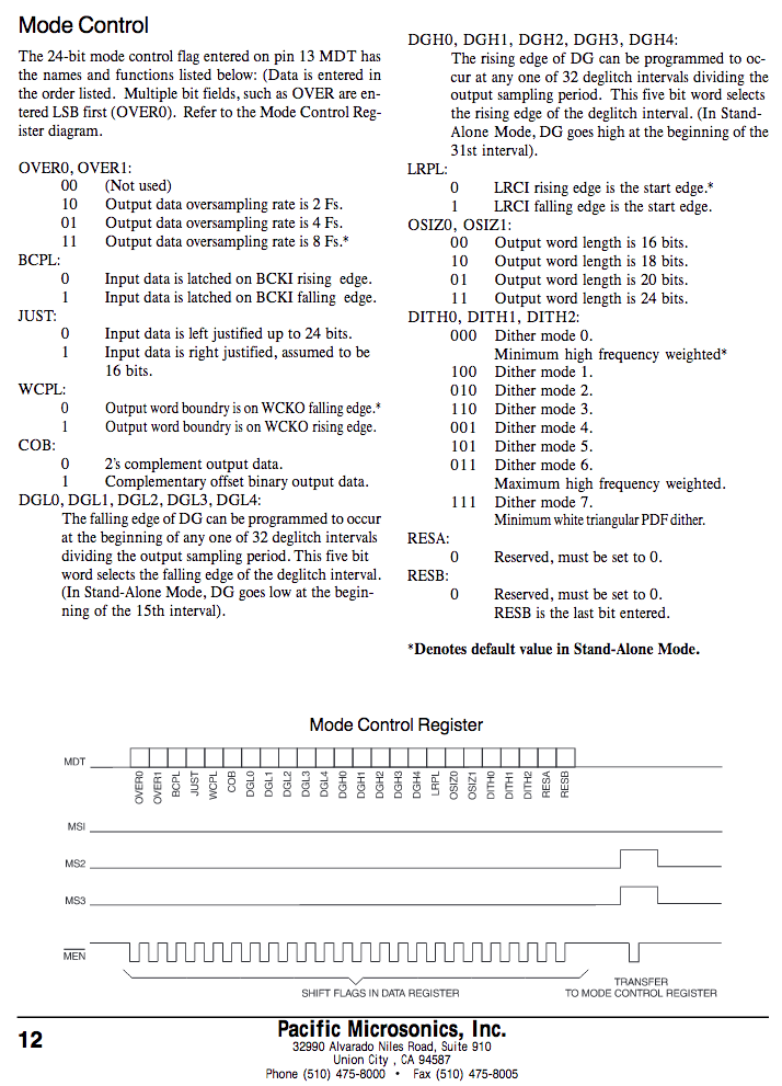

Say why do You used this complicated method for putting together 24 bit MDT word?
first you take decimal number to 8bit binarry value, and latter you cutting out unwanted bits and merging the whole word?
This first method of defining in one line MDT word is OK too and have clear refference to the datasheet?
I am not criticizing just think loud...
Originally I used 8bit words as for the PMD200, just kept the same concept. Also to make it easy for the user to change settings instead of manually assembling the 24bit word. Easy for debug as well: just print out the 24bit word to serial monitor and check if it matches the data sheet. Do you have a better idea?
I dont know maybe sometning like You did in the first posted sketch?

I see, but 0b010000011111111100001000 is not so easy to configure for most people, and I got it wrong (as I said multi bit fields are LSB in contrary to the PMD200)... Also in the first sketch I divided the 24bit into 3x 8bit, so not really simple as well. I will stick to the more convenient method of my last version...

Yes but when the word is already formed
you can load it as 24 bit like in second example?
unsigned long MDTbits = 0b010000011111111100001000;
for (int i = 0; i < 24; i++) {
digitalWrite(MDT, bitRead(MDTbits, i));
I persume that You want to avoid IF THAN steps
Maybe to try with

never mind second example is also very good.
