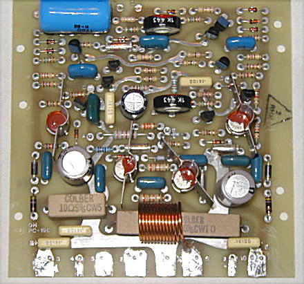

To get this going forward i would need the boardsizes for the Hafler/Adcom pcb's. Also a picture/drawing would be helpfull as i understand one of these have flanges on the heatsink.
Thx,
Kari
Thx,
Kari
Board size for the Hafler DH-200 or DH-220 or DH-500 -- they all use the same board:
4 3/8 wide 4 3/8 high.
The solder tabs go to the bottom in use and the holes on each side are for small fixin machine screws into holes tapped in the edges of the flanges on the heat sink.

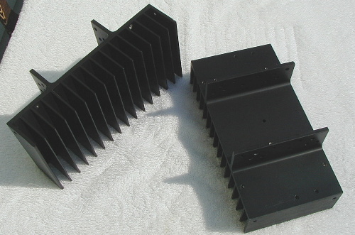

Tell us more what you mean by flanges.
Here is a pair of Hafler DH-200 heatsinks. The DH-220 are the same except the corners of the fins are rounded. You can see the "flanges" and the circuit cards are attached to the inner edges of these flanges. These flanges are spaced to fit the 4 3/8" wide circuit cards.
Does this explain your "flanges" for the Hafler amps?

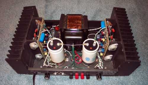

FYI, last year I modded my DH200 to be a kind of Aleph/Zen variant, using the original transistors. I called it a Haf-Nelson 😉
It puts out a solid 12 Watts RMS, and the heatsinks run just under 50 Celsius.
Just a data point.
Just a data point.
Ok,
so the board is mounted ontop of the "flanges". I have a hard time believing that one these heatsinks could take the heat of 4 fets, right?
As for the Adcom, this one has one heatsink on the back/rear for both channels?
Thx for your help!
/Kari
Thx for your help!
/Kari
Yes, 4 FETs per heatsink. You could also mount a PCB between the flanges, on the back of the heatsink. There's quite a good amount of space there. The PCBs would be a little smaller to do this, but the whole thing would be much more compact.

Well, I'm not going to build one of these, but I remember that having the boards mounted on the top of the flanges was a problem. I re-did the power supply, and I had large filter caps that were crammed up against the amp circuit boards. If I did it again, I'd mount the PCB between the flanges to get the extra space.
Thinking about it now, it also occurs to me that, by using some kind of TO-220 or similar package, you could mount the transistors on the inside of the flanges (In the stock amp thay mount on the outside) and solder the transistor leads directly to the PCB. This could work whether the board is mounted on the flanges, or between them.
