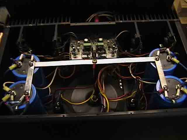

On my mini-a (in a Hafler chassis) I am using nice small BrianGT boards mounted on a standoff board (that I am using to provide some local capacitance). It has worked out nicely. It is very similar in concept to BrianGT's Hafler to Leach conversion as seen in his gallery. So, I think that small "universal" boards are great.
I started out with to220 packages in the little Aleph, but switched over to to3 (today). To3's are cool.😎

Various items:
--I'm not sure that the Hafler has as much open space as you're thinking. It would be a good idea to go ahead and use their mounting scheme for the PCBs. Besides, with the boards right there at the outputs, you'll be keeping the signal path short.
--The PCBs fasten to the heatsinks with three small screws. While that spacing is fixed, there is sufficient play in the overall scheme of things to increase the board size should that be deemed necessary.
--Use of the existing MOSFETs should not be assumed. After all, to the extent that an amp is dead, it's not unlikely that one or more of the output devices are kaput, and there aren't any more of those devices being made. Yes, there are some available on ebay, but I wouldn't want to base a circuit on NOS solid state parts any more than I would base a tube design on an obsolete, rare tube that is only available at horrendous cost.
--Just because the heatsink is drilled for TO-3 cases doesn't mean that you can't use one of the mounting holes to attach a TO-247. Living in a...shall we say, technically challenged corner of the nation, I frequently need to reuse old heatsinks due to scarcity of big new ones. (Why do you think I went to water cooling for the Aleph 2s? Couldn't source enough heat sink. Necessity is a mother...) Anyway, the point is that other semiconductor case styles are not necessarily ruled out. Don't make Nelson part with his cache of TO-3 parts unless it's absolutely, positively necessary. He makes a living off those things and could very well need them for service of older amps later on.
--An LC filter is a good idea, but it will take a nice balance between current draw and inductance to make it pan out.
--The Achilles heel of the old Haflers was the power switch. They would arc and either weld themselves open or closed. The original switch was--I think--10A. Later parts were 15A and more reliable. New switches are available without having to go the ebay route. I'll try to remember to dredge up the part number when I get home. If my home PC will consent to boot (no guarantees, there) I will try to get that posted later.
--They used .005uF ceramic discs for spark suppression on the power switches. I would suggest .01uF. Again, think reliability.

Well, its important to remember that this is supposed to work with Adcom also. One more constraint that makes this a challenge.
I envision a board with say a single hole in one corner, with a second mounting hole at two different distances, the way we do to accomodate different sized capacitors or resistors on a board.
If the Adcom uses one board for both channels, then we can make a big one to fit the Adcom have it scored down the middle to allow it to be broken in two for use in the Hafler. the way Brian GT did his chip amp boards.
Yes, this board is going to be fiendishly clever!! Especially if the Master of Layout Kari does his magic, with input from others...including Nelson..
To sum up:
The transformer, power caps, bridge, case, heatsinks, cord and terminals will be used. Maybe power switch. (EDIT: See post below)
New Output devices: If there is a group parts buy maybe we can get them in the existing TO-3 factor, but TO-247 really wouldn't be a problem...
New Fan (maybe using my method) prob needed in order to get:
20 watts/ch of tasty class A
Now, even though I want this to be easy and cheap, I'll bet a lot of people end up upgrading most of the existing parts once they hear it -they'll want more!!! BUT the cheap approach allows the upgrades to be done over a period of time.....
To sum up:
