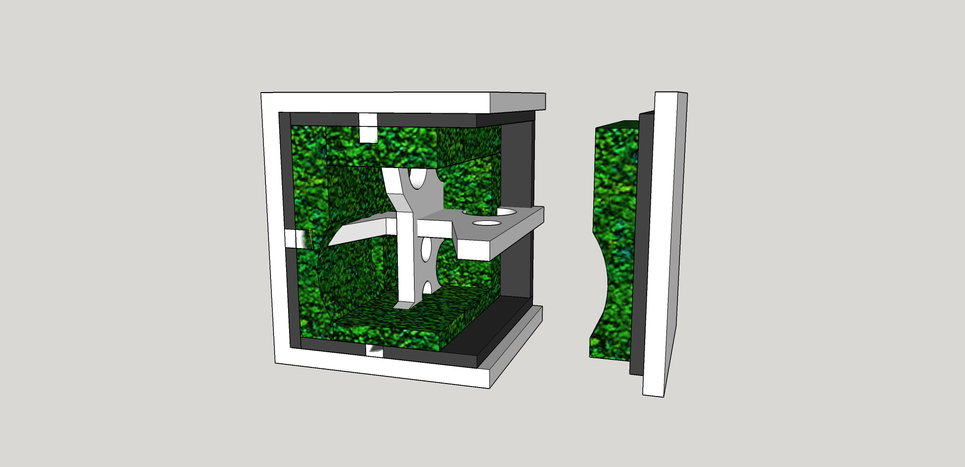

I took a closer look at your cabinet design and bracing strategy as well and I would suggest a couple of changes there.
I can't tell the exact dimensions of your cabinet subpanels, but they all appear to be pretty similar. And if your cab is made with 3/4" MDF, I would guestimate you are probably looking at subpanel resonances from around 600Hz to 1000Hz. Those will be smack dab in the passband of your midrange and just above the range of your woofer.
As such I would suggest 1 horizontal and 1 vertical window brace tied together in the middle for the mid enclosure, plus damping and a good insulation strategy. That should push the resonances up into the range above 1000Hz where there is less music energy and insulation works a little better as well. Place the braces off the center lines if you can.
For the woofers, I would add a 3rd horizontal brace just to be extra cautious and I would stiffen them up by tying them together with an additional vertical brace. Vary the height of each subpanel as well so each one doesn't have the exact same resonance frequency. That should send the resonances further up above the xo point so there won't be any energy there to excite them at all. To also mitigate any vertical standing waves in the woofer chamber, it will help if you offset the openings in the braces so there is never a clear vertical path from the top of the woofer chamber to the bottom. Damping should be unnecessary but lining the walls with something like felt would be a good idea.

Returning to this topic, I wanted to first say thanks hifijim for this explanation that makes sense to someone without a science or physics or engineering background. I appreciate that.
Now what's not clear to me still is what the difference in behavior or effect is between the pressure cycles and a true wave if there is any. What seems to be implied is that the pressure wave is not attenuated with insulation. Perhaps also not reflected off the back panel. I'm not sure if it's being implied that transmission of the pressure wave through a medium is unaffected by the medium's physical properties. Or likewise if a panel or subpanel's resonance behavior is affected differently by the 2 different types of energy.
The distinction between wave and a sinusoidal pressure cycle mostly relates to reflection and diffraction. If the enclosure is too small to support a wavelength, there is not going to be any bouncing of sound off the rear wall, and the internal shape has negligible impact on the sound field in the cabinet.
Take an example of a 10 x 12 x 17 inch (internal) box with a woofer. The woofer begins playing 250 Hz. The wavelength is 54 inch, and half wavelength is 27 inches. What is happening inside the box? Well, the speed of sound is 13500 in/sec, so when the signal starts, a pressure pulse comes off the back of the cone. It spans the 10 inch distance in 0.74 ms, and in that time the 250 Hz signal has moved through 66 degrees of phase. It is still compressing. At 0.9 ms the 12 inch distance is spanned. At 1.3 ms the 17 inch dimension is spanned, and at this point the 250 Hz signal is at 113 degrees. So the cone is at 113 degrees, but the farthest dimension of the box (17 inches) is at 0 degrees because the pressure pulse has just reached it. There is no cancellation when a signal at 0 degress blends with a signal at 113 degrees. When the cone is moving into the box at 250 Hz, the entire air volume of the box is undergoing compression, although there is some phase delay at the various walls. Likewise when the cone moves out of the box at 250 Hz, the opposite happens and everything undergoes rarefaction.
Now if we go up to 2500 hz, well that is entirely different. the wavelength is 5.4 inches, so there will be bouncing of waves off of the walls. Any brace, magnet, or object that is larger than 2.7 inches can reflect or diffract the sound. There will be various nodes of cancellation and summation within the box.

Thanks, I'll make sure to apply your recommendations in my design. I did space the braces evenly because of a pointless (in this case even detrimental) tendency towards symmetry.

For hifijim again on the internal reflection question, I'm just wondering if there is any chance if perhaps a half wavelength, so just 1 complete peak or a trough of the wave inside the cabinet would be large enough to be reflected back towards the source.
And additionally I was wondering if you might know - if we use bracing to break up standing waves inside the cabinet, at what point are the cutouts (circular, rectangular or triangular) going to be large enough to defeat that purpose and allow the standing wave to form again?
Now looking at the OP's 12L mid chamber, let's do some math. I recon for 12L we are probably looking at interior dimensions somewhere in the neighborhood of about 8.5" x 9" x 9.5". And let's guestimate the following:
- driver and xo volume: ~.5L
- 1 vertical and 1 horizontal front to back brace: ~1L (about half the volume of solid 3/4" board lost to cutouts)
- 1/2" damping, either extensional or CLD, on all panel walls: ~2.75L
So that's about 4.25L lost right there, so now we are down to ~7.75L.
If we want to leave a bubble of room behind the driver for it to 'breathe', how much should that be? For a 5" driver, I might say 5" x 5" x 5" which is another 2L. Now we are left with 5.75L to fill with stuffing.
My personal strategy is to combine different densities of stuffing. I start with high density mineral wool (6lb/cu ft) which I get in 1.5" thickness which if we throw that on 5 panel surfaces (sides, top, bottom and back) will be about 6.5L. Which is already too much. So maybe go with 3/4" stuffing on the bottom panel and we're probably going to need to cut away some material around the sides of the mid driver, so minus 1.5L for a 5L total now which leaves just a little bit of room for the next medium density layer of something like felt or foam and then a lighter stuffing like polyester while maintaining that bubble of space behind the driver to breathe. Maybe even enough room for a 2nd layer of rockwool on the back panel to ensure the longest dimension standing wave (~1600Hz?) is taken care of.
That's one way to make 12L look kind of small for a 5" driver anyways. Attached is a rough sketch of the above just with the damping, bracing and 1st layer of insulation to give a visual if needed.
In terms of the compliance of the sealed air spring vs the compliance of the driver suspension which I was mentioning before, I had to go back to the text books to find the pretty simple rule of thumb that the transition between the 2 different compliance forces occurs at about Vas/3 for the driver in question. That is, the transition occurs when the compliance ratio is equal to 3, where the compliance ratio = Vas/Vb. Less than 3, the driver suspension is the primary resistive and restoring force to cone motion. Greater than 3, the stiffness of the air spring becomes greater than that of the suspension.
To give ourselves a decent margin of error, let's call the minimum Vb for the mid equal to Vas/2. In this case for the Dayton RS150-8, Vas is 4.8L which means the driver has a pretty stiff suspension to start off with, so it won't take a very large volume of sealed air (4.8/2 = 2.4L) before the stiffness of the air spring is less than the stiffness of the driver.
So this is pretty much of a non issue for this driver when we are talking about a Vb of ~12L. Anything larger than 2.4L and we can be assured that the box is not adding anything to the stiffness of the driver.
