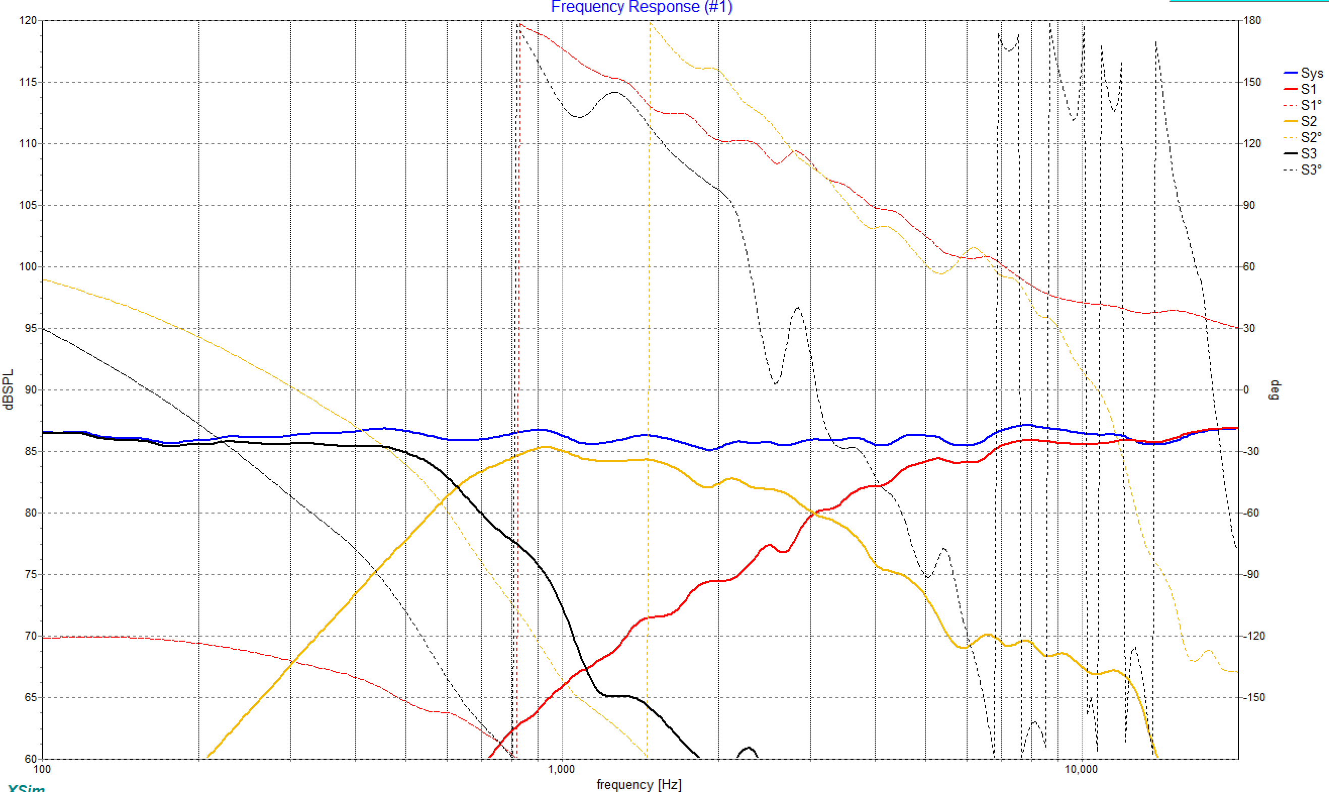

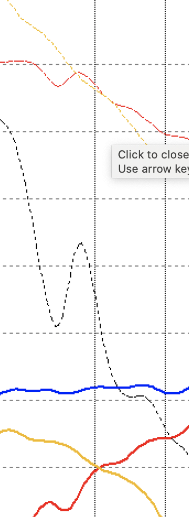

This is the result of adding a 2.2 ohm resistor in series with L1 (the mod delays were removed). To be honest, I don't really understand what I'm looking at. Are we aiming to have the phases of all drivers overlap as much as possible around the crossover frequencies?

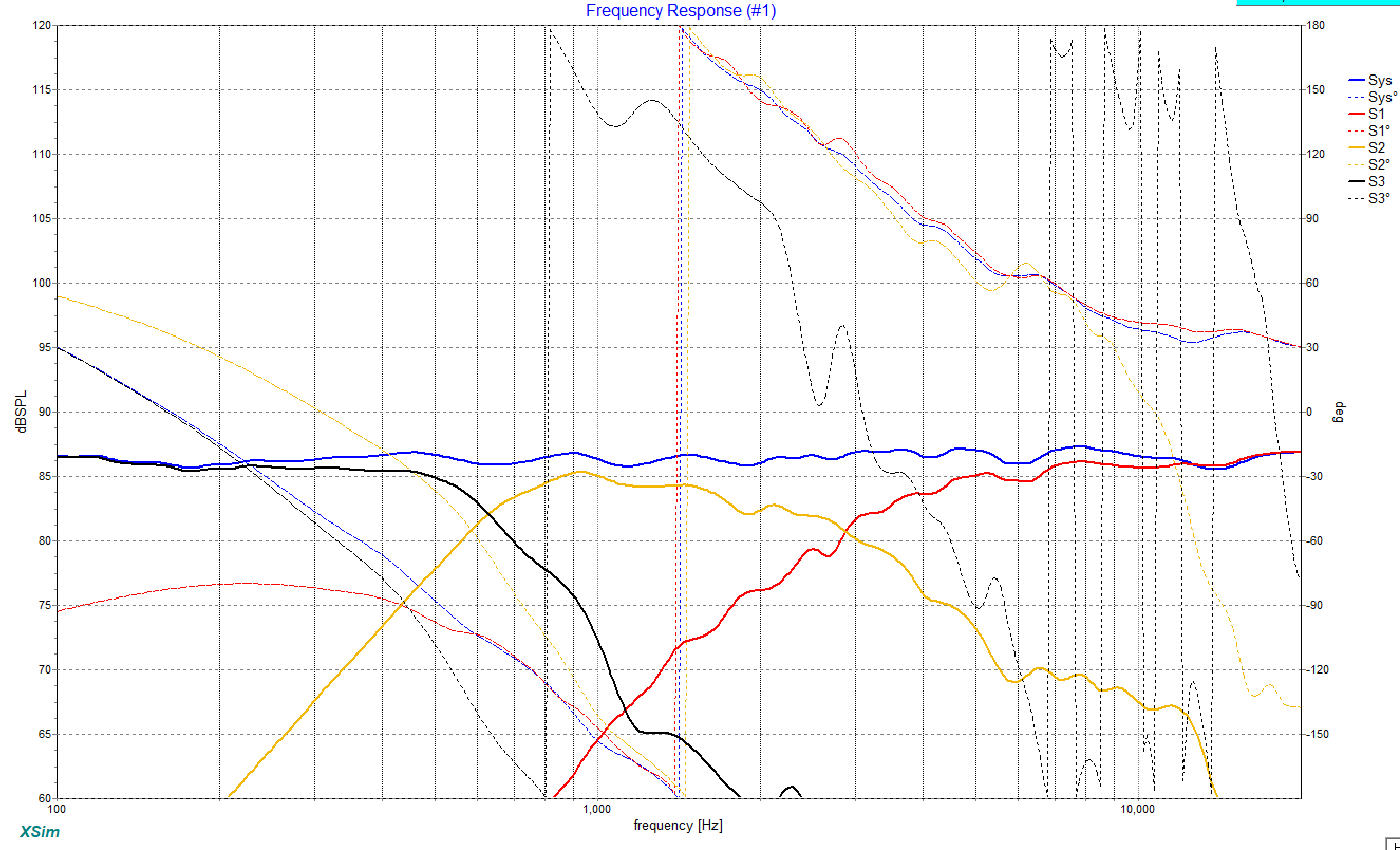

Check the attached clips for the phase behavior (dotted yellow and red lines).
Only true for the measuring plane of course. But off-axis (vertical) sims should give you a clue.
Pretty much. Not all the drivers though. Just the 2 drivers at each xo point for the range in which they are both contributing to the summed output.
Maybe see if crossing the mid and woofer lower might get you better phase alignment. Maybe try just a single cap on the mid as the HP filter. Maybe try 3rd order electrical on the tweeter. Or perhaps on the mid LP.

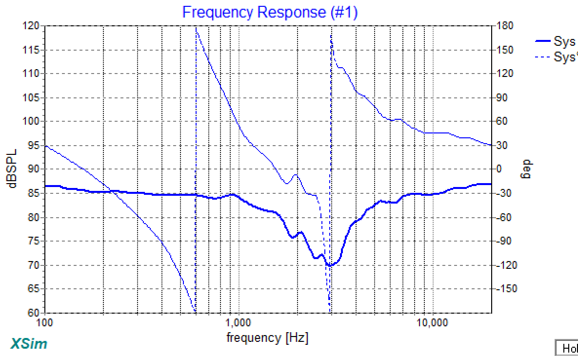

The plot with the series resistor looks better to me, but as mentioned, I don't really know what to look for. If it's just a matter of making the phase plots of mid en tweeter overlap, I'd say my initial plot on page 1 looks quite nice (shown below).
I do understand I have to take acoustic center offset into account. I'll use the formulas provided by jReave to calculate what my delays should be.

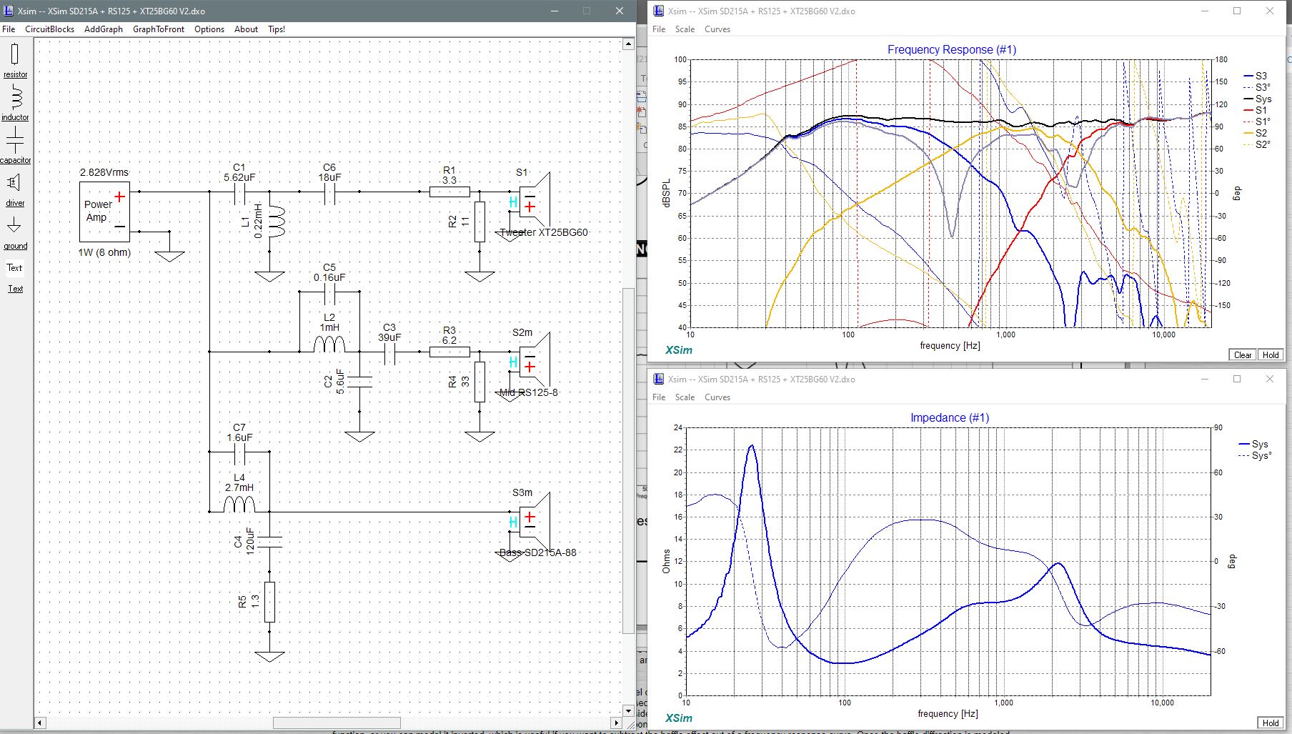

Something else you need to do that will change everything is extract minimum phase from all the frd and zma files. It is the "derived" button in the "Tune" window. For the frd files, you also have to 'tail' the FR's. So choose a slope that most closely matches what the driver is already doing and choose a starting point that uses as much of the original FR as possible.
For more accuracy, you should also include the effects the boxes you've put the drivers in on both the FR and impedance. In a 3-way this can have an important effect at the resonance frequency for the woofer and/or mid. I do that in Response Modeler but you have have Excel. Otherwise I'm pretty sure VituixCAD will do that too.
I'm not saying it will be correct in the real world - I'd want to add in the box data as I said before - and measuring in box responses is really the way to go, but here's what things look like with the delays added and with minimum phase extracted from your files and with phase fairly nicely aligned at the xo regions. A couple of resonance peaks attacked on the mid and woofer as well. Definitely a 4ohm nominal speaker though.
The XSim file is attached as well.

On the phase matching question, what I like to see is nice close to parallel lines as close to each other as possible at the crossover point and for some distance either side. The as close to each other comment doesn't apply for your woofer crossover though since that is 3rd order acoustic. For that they should still be parallel but 90 deg apart.
Another thing you can do to check on your phase matching is reverse one of the drivers polarity and check the reverse null.
In your case, if you reversed the polarity on the mid, I would expect a null for the tweeter /mid cross point, but little to no difference for the woofer to mid cross point.

Your expectation is correct, that's exactly what happens.
