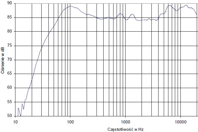

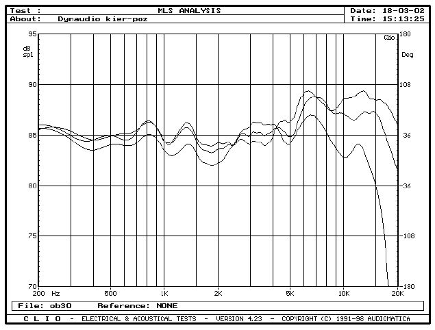

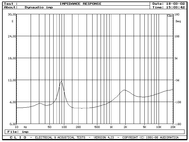

Dynaudio audience 122
I could only quickly find this info.
It tells us only a little. The highish reactance near resonance is likely something your tube amp does not like.

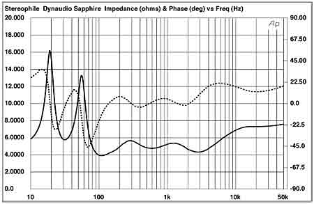

A sampling of other Dynaudio shows some that have sorta flattish impedance, and some not.

Impedance reaches a minimum of 4.78 ohms at 210 Hz and a phase angle of –32.26 degrees at 106 Hz.

That impedance is not bad. The SE tube amp will have a slight interaction (how much depending on the output impedance), but it should not be huge, so perhaps not the cause of your bass issues with it. The rise at teh top could exacerbate the raised area up top (if that FR measured w low output impedance amp0.
