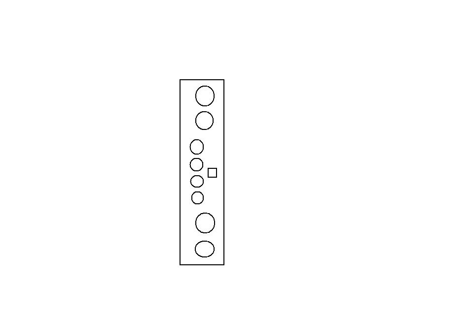

You know, I could be wrong, but I cant be certain that this WWWWMTM with your Daytons will be any better than your own first design
Now a 2.5way seems possible, maybe it could work with your own first design...well, maybe it has changed a bit
I dont know if this is what you have imagined...hell, maybe it could work, looks ok to me...maybe even better than the other

tinitus said:You know, I could be wrong, but I cant be certain that this WWWWMTM with your Daytons will be any better than your own first design
:This is what I have pictured in my mind kind of. Only difference would be an eqaul amount of tweeter to the side of woofer, hence the crazy double Neo8's with a Neo3 or AC G2si in the middle to extend things a little more and mabe add a little air up top to the highs. With a row of rs100s mabe 6 for a close match in sensitivity. And then go really wild and mount a pair of the rs180 in push pull one facing up the other down in a horizontal small enclosure behind the long thin front baffle. The mid- bass could use the back wall for re-enforcement. It would be crossed over low enough 150-200hz so the omni effect wouldnt be to strong from the soun waves bouncing off the rear wall? Then I could still squeeze the active 10" sub into the bottom half with a small sealed enclosure and variovent. I know still just dreaming? Still cant get that NOLA BABY REFERENCE speaker out of my thoughts. Also noticed Pablo thinks the Neo8s dont go high enough which I have read else where as well. I have all the drivers and a bunch of caps and inductors and resistors to experiment with. I really think this is the best part of this hobby trying things that shouldn't work and sometimes getting lucky.
tinitus said:
When dealing with the unknown I prefer to stick to the rules
Its only to tell that what appears to be simple and actually is easy to handle, often isnt that simple at all, if you know whats behind it
On the other hand what you want to do really is the most complicated design you can come up with, and it takes more than normal skills to make it work
I could also say that a complicated design is the easiest thing to come up with...but to make it work is the opposite, difficult if not impossible, because its flawed from the very beginning
The simple design is really the most difficult...but to make it work should be much easier, because its a sound and solid design
As when you suggest 6db filter and use high quality components
Well, it may work but probably takes a little more than that
Im sorry to say, but afraid your are heading down a long and very difficult road
But worse is that you probably wont get what you expect
On the other hand I am sure it will be both great fun and very frustrating
But sure, I know the feeling, its great fun to do the thinking, and it cost nothing, as long as you stay with that
So build yourself a nice "premade" design to listen to, and then have all the fun you like doing other designs
The design shown below should be able to make plenty noice
You should have a small but fair chance with that one

tinitus said:
Only, now that we know all those drivers are present, I am not sure about putting more money and new driver into this project, but rather think that he should use what he has on hand, play with it, learn something, and have fun
Anyway, I dont think he will get what he dreams of, just like that
Sorry, but we have to be realistic about it
But still, I do think an acceptable design could be made with these drivers, somehow
I use DIY 50watt mono amps, Advantage I200 as preamp, Advantage CD, the old black ones, and a Luxman tuner, thats all...speakers are 3way with 2x8" SS modified, 15W SS dustcap lightly coated, XT21 Vifa modified
Hi tinitus,
You are right, but I have suggested to use a dayton RS180 that Justin has yet.
Another options is forgot the Neo8 and make a TMW + separate subs .
Neo3pdr, Rs125, Rs 180. a decent crossover and voilà!😀

Ofcourse, its the obvious...maybe as a 2.5way
