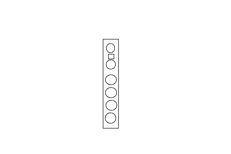

I am thinking of making a pair of BG Neo8 mtm's with the Neo3PDR's in the center. I was going to cross them over to 4 Dayton RS100 full range speakers at about 1500hz. Also will have Dayton RS265's in bottom of enclosures with 240 watt amps. I was thinking this may work out? Subs at 180hz then full ranges to about 1500hz and finally tweeters at 8500hz? all 2nd order (APC) or may be even 3rd order(APC) for the full ranges? Im wondering if this will work with the RS100's stacked vertically in a closed box right next to the MTM Neo drivers which would be mounted on there own open baffle? Or will that type of arrangement interfere with the open back diapole effect of the Neo8's? I think I have seen similar designs from speaker manufactor's. Also would it be better to just do a 2-way cross-over with a single cap on Neo3's treated like super tweeter's? Any help will be appriciated because I am about ready to order the Neo8 or Neo8PDR's.
I almost forgot one of my main questions, does it make any difference which Neo8 I use, PDR or regular? Thanks

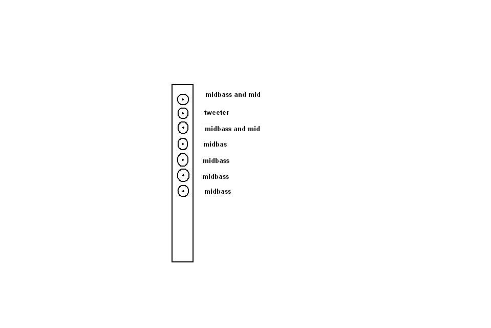

I suppose it would be a bad idea to use two Neo8s stacked vertically next to 4 rs100s. A company called Nola does this type of design at www.nolaspeakers.com. They just looked real interesting to me but probably a lot harder to make work well together?
I fully understand your attraction to that design
On a couple of their other designs they seem to break every rule we like to follow in here
The big one you like, is different from what you have suggested
Its a line array with mids and tweets covering the same length
Some people love line arrays and wont have it any other way, and I believe they really are special, in some ways
But it has been shown in here that all sorts of strange things happens when doing so
Fore one the midrange wont be linear
Secondly it has also been shown that a side by side mounting of tweets and mids is really going completely wrong
What you will do is quite different
4 mids wont make a line array, and a single tweeter certainly not
Others have used a line array with a single tweeter and says it works ok
You can mount the mids in a line, and tweeter at the side, and it may work to your satisfaction, but maybe not
Or you can make a MMTMM, which also present a problem most people stay away from
Hell, sometimes people make things that are pretty weird, and say it works ok
Could be that with a lot of work and experiments even the most strange things can be turned into something good
When dealing with the unknown I prefer to stick to the rules
If you look at the design below, you may think its pretty boring, and not very interesting
But I tell you its quite special, and based on years of experience of a lot of people around here
I think its quite an intesting design and would really like to do it myself
Its only to tell that what appears to be simple and actually is easy to handle, often isnt that simple at all, if you know whats behind it
On the other hand what you want to do really is the most complicated design you can come up with, and it takes more than normal skills to make it work
I could also say that a complicated design is the easiest thing to come up with...but to make it work is the opposite, difficult if not impossible, because its flawed from the very beginning
The simple design is really the most difficult...but to make it work should be much easier, because its a sound and solid design
I respect that you like the neo8, but having heard what you like the finer aspect of music reproduction...thats not something that comes easy, and certainly not following certain drivers by law
It just as much depends on how you handle it all the way from the beginning to the end, and so many many things are likely to go wrong
As when you suggest 6db filter and use high quality components
Well, it may work but probably takes a little more than that
Im sorry to say, but afraid your are heading down a long and very difficult road
But worse is that you probably wont get what you expect
On the other hand I am sure it will be both great fun and very frustrating
But sure, I know the feeling, its great fun to do the thinking, and it cost nothing, as long as you stay with that
So build yourself a nice "premade" design to listen to, and then have all the fun you like doing other designs

Regarding the slimm speaker I showed
Theres a number of key elements in the design that one needs to understand to be able to value its worth
The use of 7 drivers is significant, and 6 in total are playing midbass
Its only possible because ALL drivers are the same, and with use of 2.5way xo
Also special is the use of same driver fore tweeter, which makes a very low xo point possible
2 of the driver also play mid, configured as MTM, which is best done with the low xo point
Probably the xo turns out pretty simple...anyone ought to be able to make this work

And could look something like this
I have given it a little twist, which means its bipole, sort of...a pair of RS100 is mounted on back, maybe push-pull
Though its not what would like best, it could still end up better than I would expect
At least -3db/100hz turned out ok
Not much Xmax, but its 8 drivers in total playing midbass
