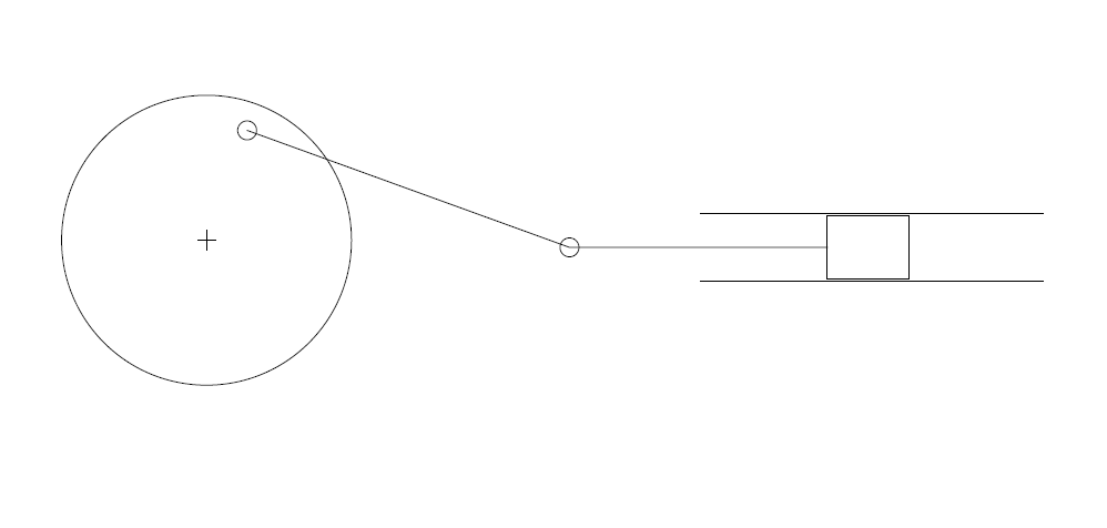

If I'm getting this right, this mechanical system would keep in motion once some mechanical energy was put into it? (no losses - vacuum, no friction, etc.)
I must admit this was the non-intuitive part for me (I almost feel the hard work needed to move the piston all the time) but fers' sentence "the energy has nowhere to go in the mechanical system" has made it. Now I simply see no other option.

No. I think the problem here are that people don't have much of a grip on thermodynamics and how work and energy are related. You are doing work when you apply a force to stop a moving object. Two ways to figure the work are W = int(F dx), and W = delta (KE). So if the kinetic energy of the moving mass is m x v^/2 and you bring it to rest, v = 0, the work you have done is doing so is equal to the initial KE.
Yes.
As the force is in the opposite direction of the velocity vector, the work gets negative, doesn't it (?), i.e. the energy is in fact received, not spend. So in the end after all the kinetic energy is released and everything is still, it must all get converted to heat in the muscles (i.e. more energy in the body -> rise of temperature). If it isn't so, then I just give up.No. I think the problem here are that people don't have much of a grip on thermodynamics and how work and energy are related. You are doing work when you apply a force to stop a moving object. Two ways to figure the work are W = int(F dx), and W = delta (KE). So if the kinetic energy of the moving mass is m x v^/2 and you bring it to rest, v = 0, the work you have done is doing so is equal to the initial KE.
IOW, as I see it, me stopping a ball is the same as a bullet hitting a wall. Kinetic energy is released in making the deformation/breaking of/heating up (or whatever, including the sound). Are you saying that the wall is loosing its inner energy by stopping the bullet?
It's a matter of accounting. As Earl said, no e energy is lost or created. Does the moving mass do work on you or do you do work on the moving mass? Does the bullet do work on the wall or the wall do work on the bullet? The wok done is the change in KE. Since the final state is zero KE and the initial stat is some finite KE amount the work done on the moving mass is negative, thus energy is given up to the wall. Positive work is done on the wall. Does the work or energy end up as heat, sound, chunks of wall flying off, what ever? But ultimately all energy is conserved, but it may change form, like to heat. What is heat, or temperature. It just a measure of the energy of the atoms vibrational state. Look at your example of the fly wheel and piston. Starting from rest work is done on the system to get it moving. What happens then. Depending on the position of the flywheel and piston, energy is being transferred between the two. When the piston is at an extreme where it velocity is zero and starts moving the flywheel is doing work on the piston to increase it's KE and the flywheel slows down. When the piston reaches it's maximum velocity and starts to slow down it is because it is doing work on the flywheel, transferring it's kinetic energy back to the fly wheel and speeding it up.
When you stop a mass the, yes, you are absorbing the energy and converting it to some other form. Replace yourself with a spring and you have a different result. Replace the spring with friction and yet a different result.

Exactly, and that is the reason why I don't do any work in stopping the ball. The energy flow is unambiguous, otherwise the wheel wouldn't keep spinning.... When the piston is at an extreme where it velocity is zero and starts moving the flywheel is doing work on the piston to increase it's KE and the flywheel slows down. When the piston reaches it's maximum velocity and starts to slow down it is because it is doing work on the flywheel, transferring it's kinetic energy back to the fly wheel and speeding it up.
Again, simply put W = change in KE. If the piston is accelerating , its velocity is increasing and it KE is increasing. Thus positive work is being done on the piston. Conservation of energy then says the KE of the wheel must be decreasing, thus negative work is being done on the wheel. The KE of the system is constant, thus no work is being extracted from the system. Work done by or done to is just an accounting of the direction of energy flow.
