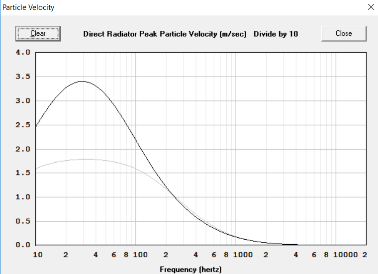

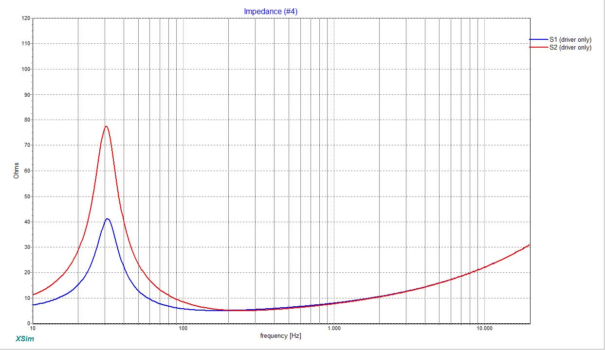

Mabat, Andy is trying to tell you that in order for a calculation to be of some significance in understanding what is going on, you should first model both of your drivers. You said one has double the moving mass and motor strength. This changes impedance profile of each driver. For instance like this. The red curve is the one with twice the Mms and Bl.
Of course I can do this and have done this, but without an explanation, it doesn't tell you much. And this is just the magnitude. So let's talk about the point where the magnitudes are the same - which is approx. at 200 Hz in your picture. Is the phase between the voltage and the current different? It is, I can tell you that, but why exactly? At 200 Hz the heavier cone will move with twice as big kinetic energy at its maximum speed. The current will be the same - at least its magnitude. And it's the current magnitude that determines the motion of the cone, right? ...
