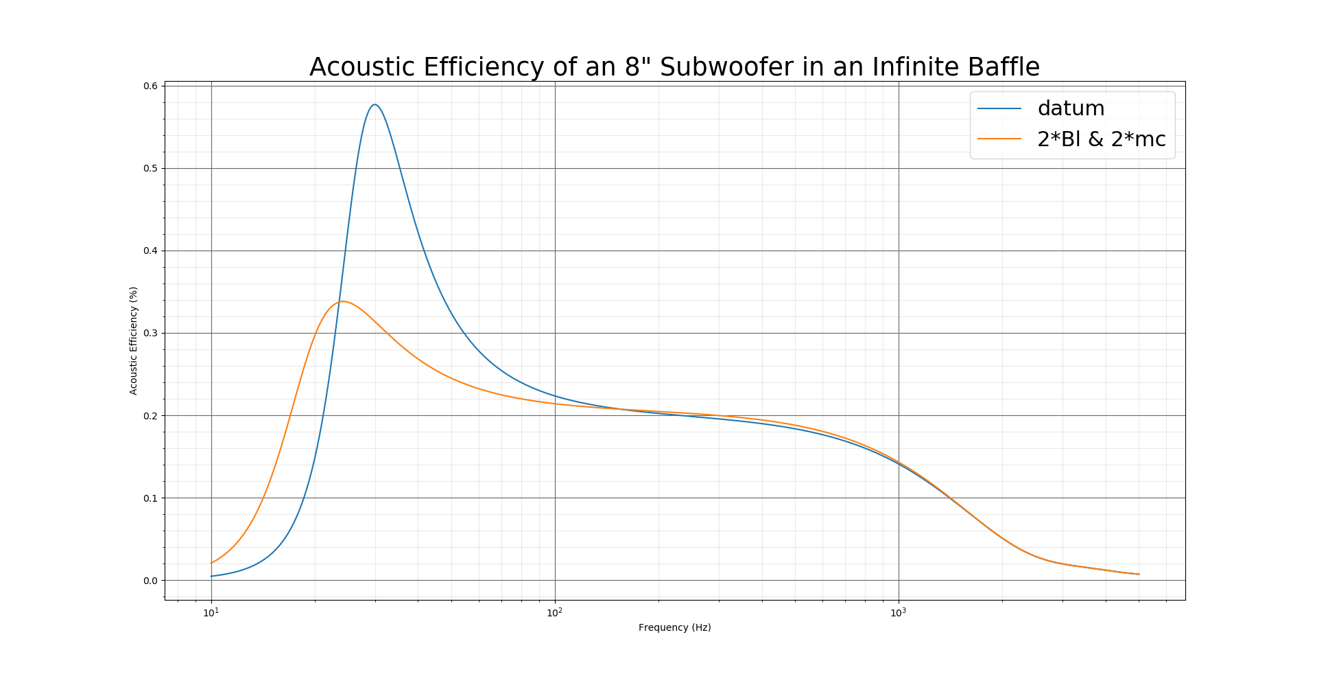

The 0 indicates that is a reference value of some kind. The acoustic efficiency varies with frequency, I gave an unnormalised expression in an earlier post, and so your two cases will vary differently with frequency over the passband of the driver because other components of the various impedances have not been scaled to align them (there was a plot by someone earlier showing this). Your two cases may tend towards the same value at high frequencies above the driver passband.Does it hold or not? What else would it mean, if not that the efficiency will stay the same?
The edit button seems to have gone. This is the acoustic efficiency of an 8" subwoofer in an infinite baffle using a conventional lumped model for the driver with and without doubling Bl and mc. Not too dissimilar to the earlier plot. Note this was a few minute hack without any checking and so may not be immune from errors.

This is strictly peak mid band efficiency [up around 1 kHz for woofers].
GM
Right, notice how the lines converge at ~1 kHz as the math predicts.
