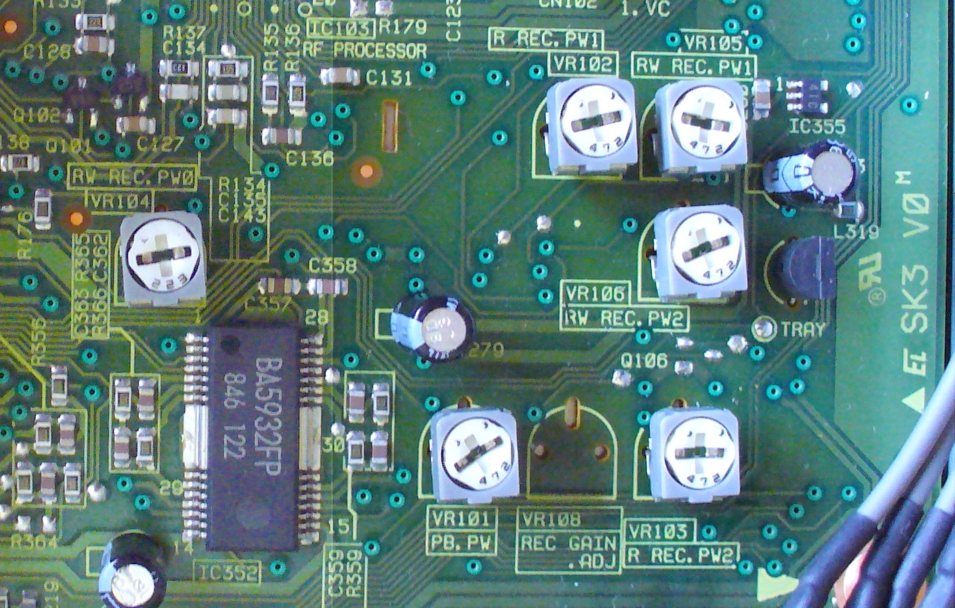

Got the elna out. Too much of the other stuff for me to tackle. Far too fine of a work for my *older* eyes. Best mag on hand is a 10x jewellers rouge. Would never be able to solder threads of wire to traces . Hands far too unsteady. Gonna look for a full PCB.
It's not that hard -- mostly just a royal pain. You do not solder the wires to the traces, you solder the wires through the little "through holes" that go from one side of the board to the other side. I wore my jeweler's visor and wore my reading glasses under them (I'm old and have a hard time with close vision). The problem in getting another board is that it will probably have the same problem.

ColinD, I was able to send cheryl a working laser assembly out of my "parts" machine, plus a photo of how the pots on that main board were set, and she installed it and that did the trick. (I'm sure she'll fill us in with more details.) Her post had said that there was visible damage to a cable and board in the laser assembly...
Hello afecu, Thanks so much for your update, and pleased to know Cheryl is up and running again. One thing about these machines I never asked to have confirmed was the very hot running of the RF Amp chip, IC103. I was initially concerned about this but later came to conclusion it was normal in a properly working machine, as it cools again very quickly. It is really the only hot-to-the-touch chip in the whole machine. Any comment / confirmation please, from anyone.
