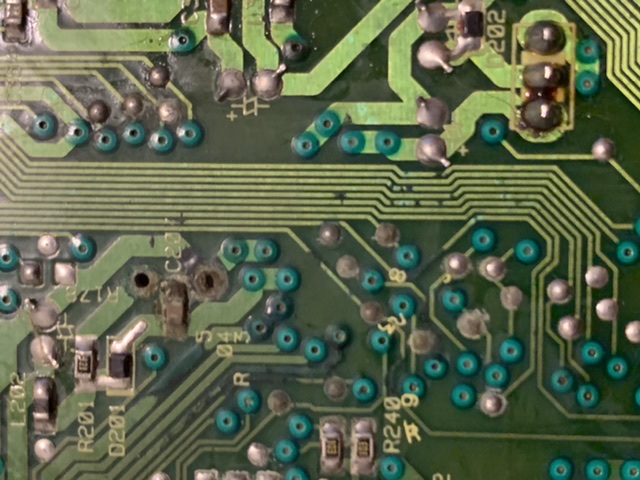

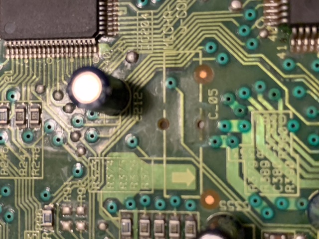

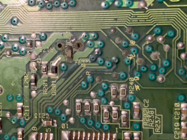

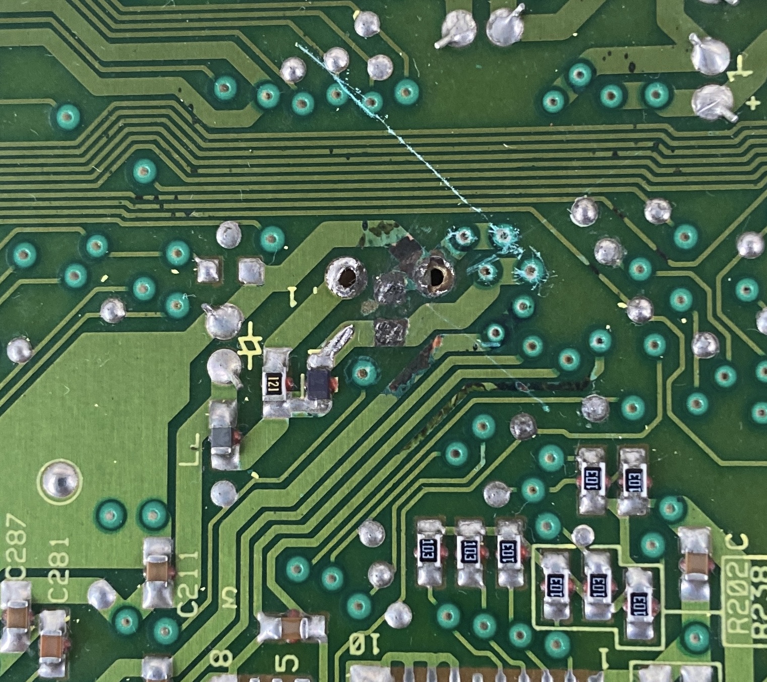

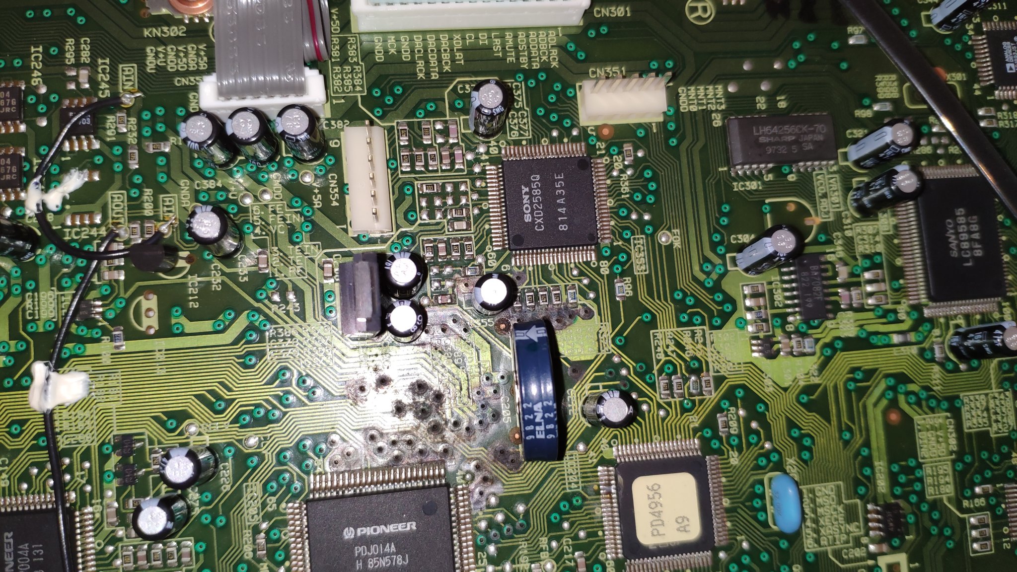

So is this bad to fix
Pull the hated capacitor, bottom side I have broken traces. Is it as simple of using a wire to connect around it, or is it toast?
Thanks for any help in advanced.

So I thought of a super easy and quick way to get through the holes.
Take a standard resisitor. Clips both wire leads to about 1/2". I put an angle on the cuts. Insert the body of the resistor into you drill's chuck and tighten. I use it on the slowest dremel speed setting. You may have to tweak the tip slightly if it isn't perfectly centered. It works incredibly fast. Don't press too hard or you'll bend the lead. If it does bend, flip the resistor around in the chuck and use the other lead.
I can now just use clipped rsisitor leads to stick in the holes to solder in place. They should fit the holes perfectly since I used a lead to make the holes.

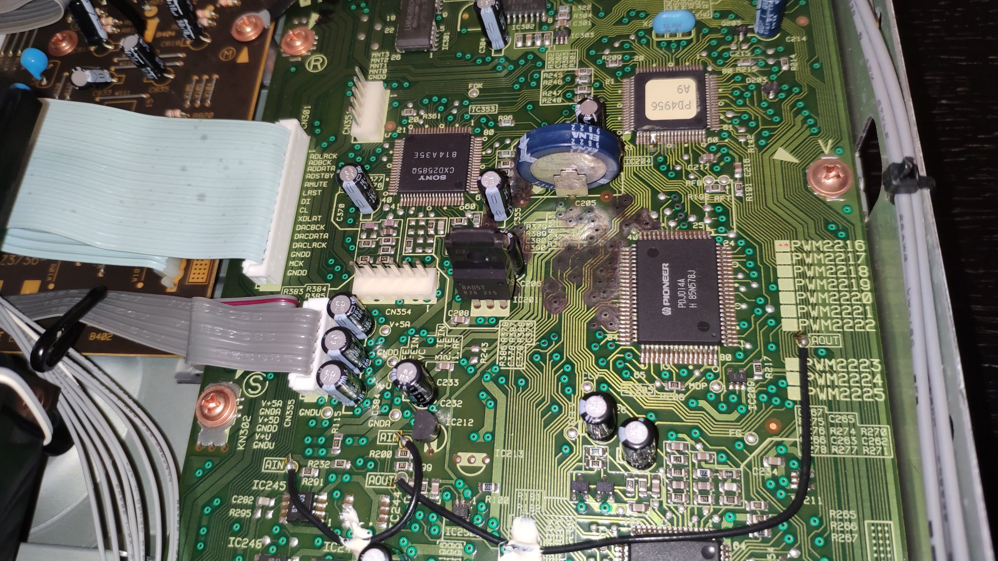

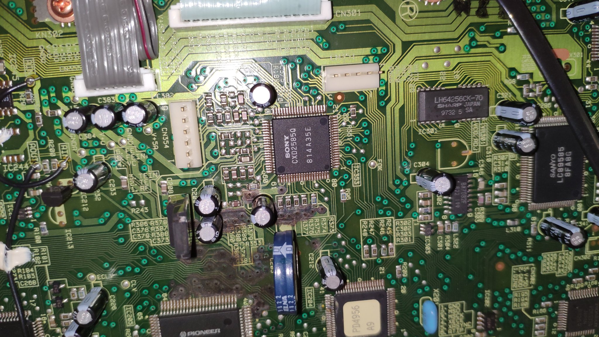

As it seems this thread will never go out of fashion. Owner of a PDR-555RW here. I had it sitting for years since 2-3 tech guys I took it fpr check, mentioned it needs a lot of money without clarifying what the issue was. Anyway 2 - 3 weeks ago I had an urge to open it up again to remember what the problem was. Right after powering it up and pressing the eject button the door remained opened (good sign) but after closing it, it re-opened again. Started searching on net for possible solutions and brought it here.
Opened the case and noticed that supercap seemed probably ok (didnt remove it yet) but the area around was not exactly oxidized but something like ash from cigarette. By the look of it, it was like it had punched holes from top to button. See pics below
I cleaned all that surface with isopropyl alcohol and seemed that everything went away. Dried it well and opened it. To my surprise it played a cd (afterwards tried a second one and a cd-r).
What I m dealing with right now is the tray. It started with staying open all the time and the screen flashing check.
pressing stop button showed error code -> 0004 L1 and (only 4 hours? Hardly think so. Except this reading is because of the last tech guy changed / reset something and didn t mention).
pressing SKIP PLAY+DISPLAY OFF showed -> 00910000? (which i don t know what that might be.)
