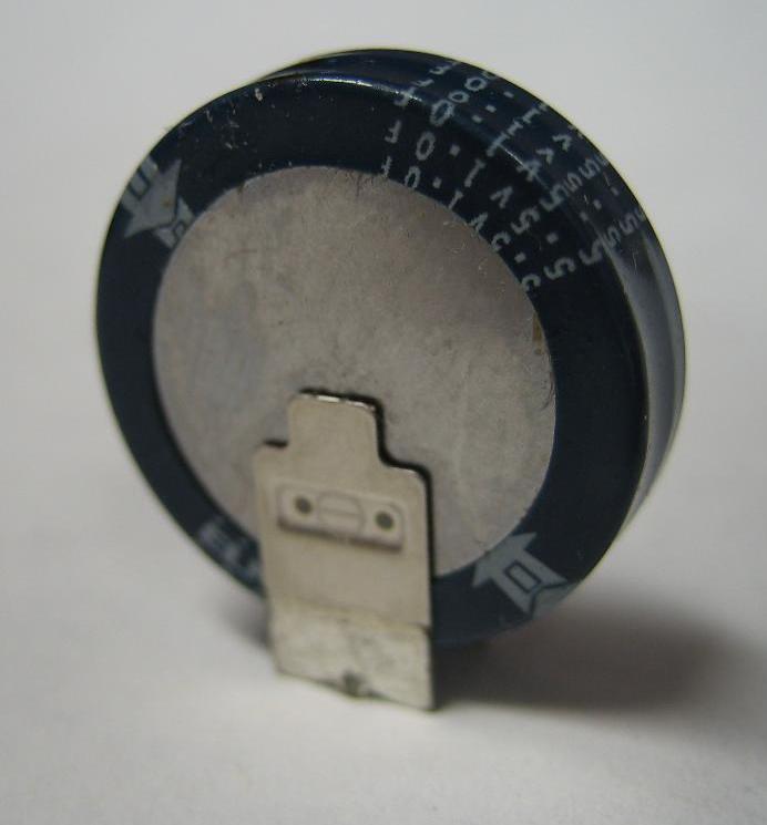

Here's what the supercap looks like (this is one that has not yet leaked). The markings are ELNA and 5.5V1.0F. It's pretty much in the middle of the large board on the right side that runs the whole depth of the unit. (Sorry, I don't have a photo handy of the whole board.)

Thank you, afecu, for the picture. Removing that part was easy. No leakage on the board but there is a bit of corrosion on the part - it looks like rust creeping from around the backside of the silver-colored center, along the edge where it meets the blue outer section.

Of the dozens of 555RW's(and it's variants) I have worked on and or upgraded, with the exception of one actually bad laser(would not even play a cd), and one unit dropped hard in shipping that caused the platter to slip down the motor shaft a bit(also would not even play a cd), EVERY symptom of ANY kind with these units has ALWAYS been caused by leakage from the memory backup cap. EVERY time.
This leakage is not always obvious, nor is there always visible leakage from the cap. So, it is always required that one removes that main board to inspect the color of EVERY through-hole connection point(those vapor-deposited 'plate-through hole') and re-inforce(by punching through the hole with a pin/needle and soldering through a very fine wire top & bottom) each and every one that looks significantly darkened or otherwise suspect. I can virtually guarantee that this will fix your problems.

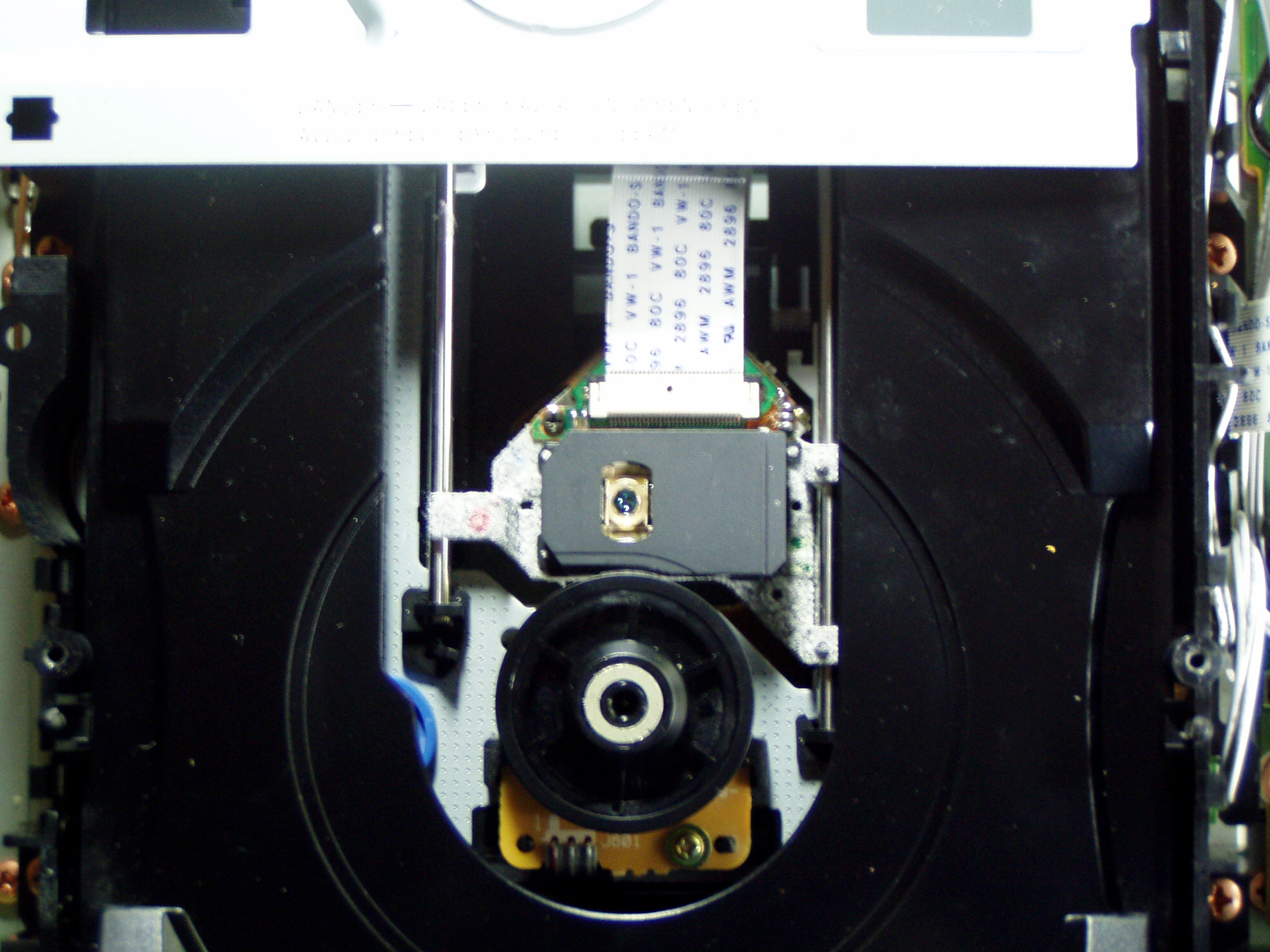

My unit usually recognizes a CD-R and will let me record -- but nothing else. I took a picture before I cleaned it but don't know how to post a pic.
Cheryl

The pic is attached. It's as close as I can get with my camera, but you get the idea. There is a heavy buildup of corrosion. This morning I removed the pickup assembly and carefully cleaned it with a very soft brush and some contact cleaner. I put it back in and I'm pretty sure I have it aligned right, but now I'm back to "check disc" on everything including CD-R's. That's what it was doing BEFORE I removed the cap. Are there any tricks to making sure the assembly is engaged to the gear at the right location? I couldn't find any "timing" marks for alignment. The first time I put it back in I was getting "no disc" so I knew it wasn't in right spot. I re-did it several times before getting to "check disc".
Even with 20x magnification I could not see any corrosion or discoloration at all where the bad cap was or anywhere within a radius of 3-4 inches. But since I'm now back to square one I guess the only thing I have to lose is time, so maybe I'll re-solder everything in the vicinity. I tried poking a straight pin through all of them but they are very well soldered and none of them seem weak. I ordered a new tiny tip for my soldering iron but it isn't here yet and I can't do that with a 1/4" blade. 🙂

That looks like atmospheric pollution reaction, for sure. Something in the volcanic gases has reacted with whatever metal the base casting of the laser is made out of, but not with other types of metal. It is unlikely to have affected the optical pathway, so just clean as much as you can from the visible surfaces top & bottom of the pickup, as well as any that has shed onto the circuit board under it. Also, make sure that the parts in contact with the guide rails are thoroughly clean & greased with a light grease.
You can just leave the holes blank where the 'time bomb' Elna cap had been. Now that I've seen your photo, I do still hold to my opinion that you simply need to repair more through-hole connections on the main board that were damaged by the Elna cap.

GOOD GRIEF!! Now it is working!!! WTF?
I must be living in an alternate universe. I turned the gain up and it started playing a CD! Turned it down a little and the CD stopped turning!!?? Turned it back up and it wouldn't read the CD again. Took the pickup assembly out and put it in again in the same spot as before. It started playing a CD I had recorded previously on the unit. Cranked the gain up a bit more (now up about 1/4 turn) and it is playing a pre-recorded CD that it would not play before. It appears that it might even record....
The service manual does not say what position to put the pickup assembly in when you reinstall. I tried putting it in the same spot it appeared to be in when I took it out (like the pic). Didn't work. The best method seems to be to install it as far back (AWAY FROM the CD) as possible and let it seek its proper position.
Now it is working and playing through headphones and I'm afraid to turn it off....isn't this fun! Are we having solar flares? That's always the excuse the satellite TV people use.... I guess I'll find out how long it actually works. Thanks for all your help!
